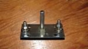

Homemade drill press rotor spindle mount intended to facilitate the process of attaching a motorcycle brake rotor to a drill press. Press is spun at 300 rpm to aid in removing remove rotor gouges with sandpaper. Constructed from metal plate, a partially threaded steel rod, and a pair of nuts and bolts.
