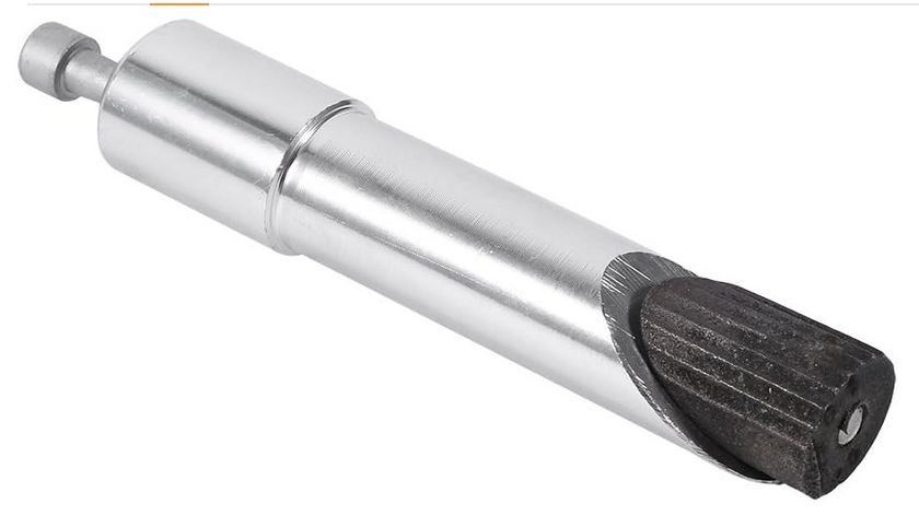

    Quote Originally Posted by sking0369 View Post
    Nice work there but I'm not understanding what the shaft cut at 45 is for?
    I was wondering the same thing and guessed it must be to wedge the shaft in the arbor hole maybe?

    Quote Originally Posted by scrdmgl View Post
    The cut at 45 Deg., allows the short piece to slide when the bolt at the end is tightened and locks to the spindle ID holding the whole assembly in place. Simple and effective.
    This is the same mechanism used to position the handlebars on a bicycle - at least on the ones I had as a kid.

    Bicycles have been using the angled shaft locking method for a long time for the handle bar stem.
    I still remember when I was 6 or 7, being amazed working with my dad restoring my very first bike. He loosened a bolt on the handle bars. Smacked it one time with a hammer. Magically, the handle bar stem slide out of the fork tube.
    When the 2 pieces cut at 45 degrees are drawn together they expand inside the spindle and jam.

    Quote Originally Posted by basalt View Post
    Works equally well for square stock; handy for something that needs to lock into a square-sided slot.

    To lock it into the spindle bore like the gooseneck in a bicycle :-)
