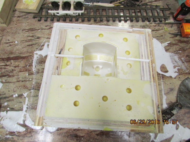

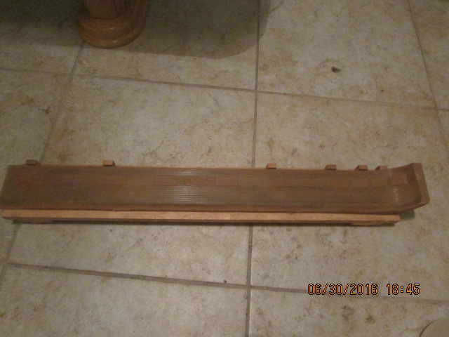

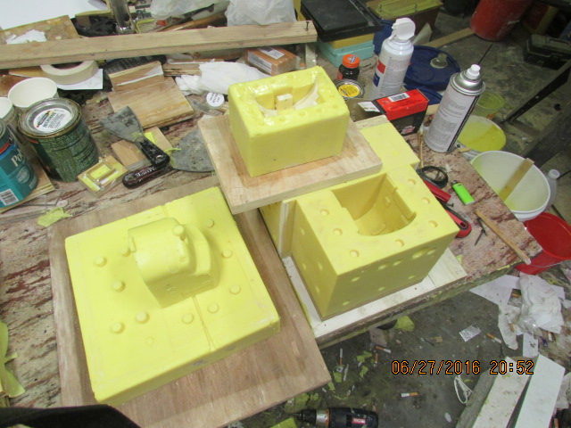

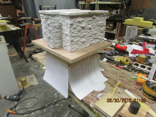

Half of the front skirt and all of the cab mold completed, Bob.Attachment 11985

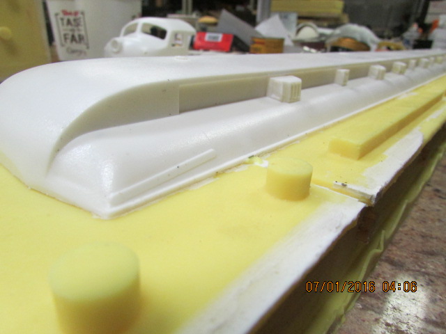

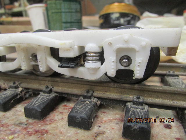

A mock-up for fitting some more parts. Bob.Attachment 11992

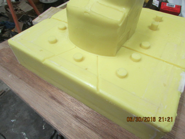

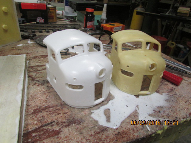

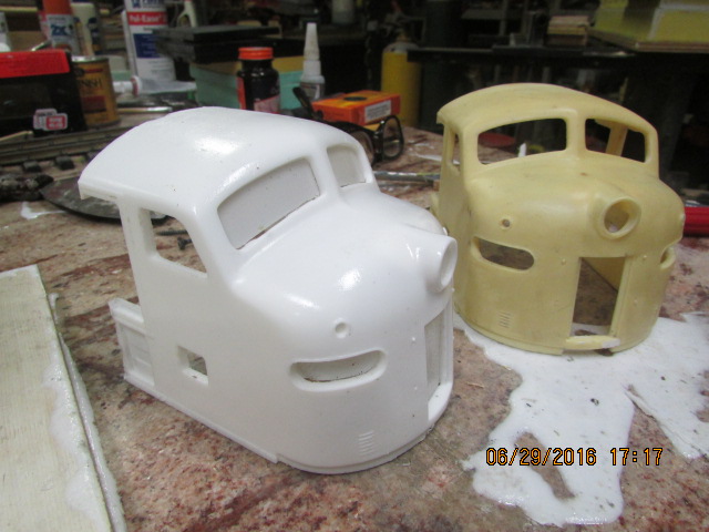

Thanks Paul. Attachment 12034Attachment 12035Attachment 12036Here are some pictures of the completed cab part from the mold. *I will also have to make a pattern for the straight type pilot. Note the amount of flashing, minimal, it just fell off and that's good, shows that the mold parts are fitting tightly. Bob.
Bob,
The EMD E and F locomotive castings are looking very good. I know it takes a lot of work but a great opportunity where you can have a hobby and business that is fun. Thank you for showing your progress.
Regards, Paul

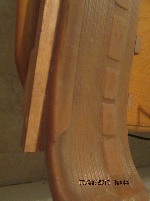

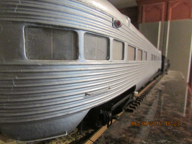

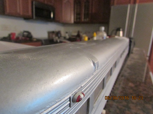

I wanted to share this with you. Back in the days when I didn't have any machines, such as, a lathe, a mill, a cnc router, or a 3D printer, which I still don't have, I made patterns out of wood with just a hand held router and a band saw. While this 1945 Pullman observation is not perfect, in my estimation, it still looks good. The fluting was made with a bullnose 1/8th inch router bit, spacing with different thickness plastic spacers on a jig that I made. The roof shape was made with 1 inch sections of wood. After the patterns of the sides and roof were made, an epoxy mold was made. I made the mold long enough for the round end and a straight roof, which I still use today. My point is, one can still make models without all of the fancy machines. Bob.Attachment 12050Attachment 12051Attachment 12052Attachment 12053

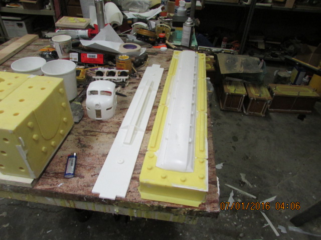

Some bubbles occurred in the last pour of the cab, so I added some some relief channels to the upper most part of the mold where the bubbles occurred, so I hope this cures the problem, I will know later on today, and also I have been taping paper, with vinyl caulking, since the tape won't stick to the waxed wood, to make the cleaning of the molds easier, works good. Bob.Attachment 12054Attachment 12055
I couldn't wait, so I pulled the parts out of the molds, the chassis and the roof came out perfectly, but still having some small bubble problems in the cab. *None of the bubbles are bad enough that they can't be repaired, but I would like a bubble free part, here are some pictures. Bob.Attachment 12092Attachment 12093

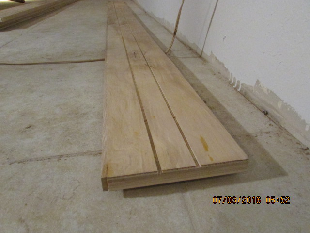

Thanks Paul. I am sure that some of you have done this before, but I haven't, so I did. I had to get my trains off of the floor, so I cut a piece of plywood, 4x8, into 8 lengths and grooved them for track, saved about 300.00. The eight pieces gave me 64 feet of shelving. Bob.Attachment 12114
