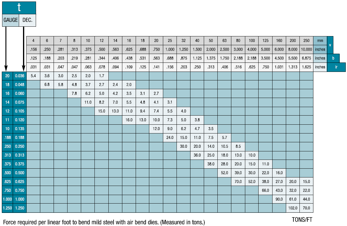

1 Attachment(s)
here is a bend chart
For instance if you were to build a press break with a punch and "V" die 11 ga is the closest to 1/8" but most people wund up buying 10 ga which is .135" for 11 ga using the smallest acceptable "V" width .625"you could bend a minimum flange size of .438" but at 16 tons per foot or for a 48" sheet 64 tons but if you used a 1" "V" it would only take 7.3 tons per foot 29.2 tons but at the same time your minimum flange would be .688" the inside radius would be .156" however if you could live with a much larger IR (.250)and longer flange (1.125) you could use a 1.5" "V" with a force of 3.8 tons per ft 15.2 T @ 4 ft.
for 10 ga these figures change relative to thickness min "V .750" = 12 t per ft. open "V" 2" = 3.5 ton ft.
Attachment 19781
