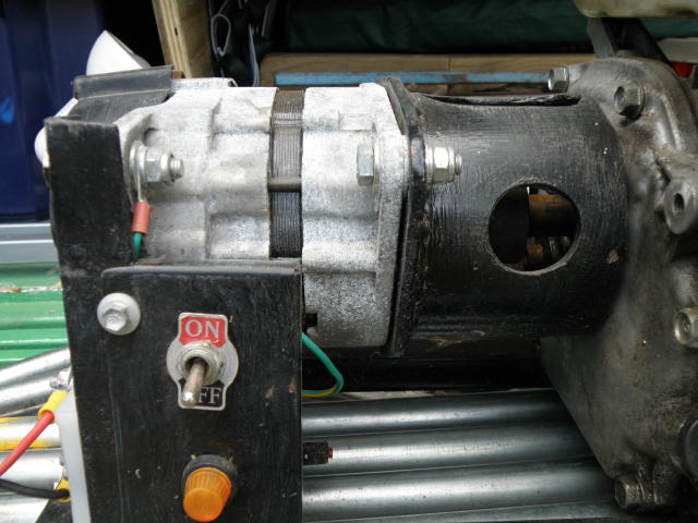

This little engine has provided many uses around the house and farm. It is simply a 6.5HP HF side shaft engine that is hooked up via belt and pulley to a GM alternator.
http://i118.photobucket.com/albums/o...s/IM002170.jpg
http://i118.photobucket.com/albums/o...psoktp7wit.jpg
This has many uses and is currently the power supply on my portable light tower.
This is used to charge batteries on tractors and equipment that is not conveniently near a 110V power for a typical battery charger.
This has also been used very successful to power a electrolysis setup for rust removal.
