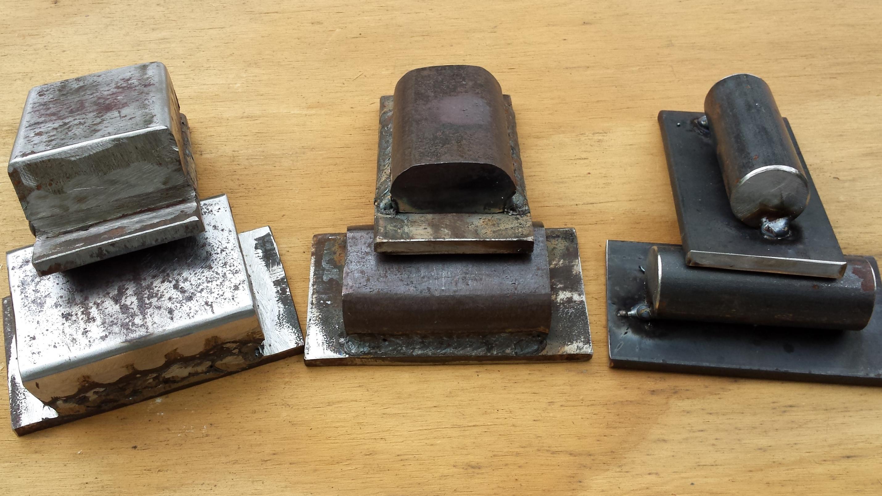

    Here's a pic of the dies and the foot pedal.
    20 ton Air/Hydraulic Mini Press-dies.jpg
    These are only the first of the dies. I'm sure to make more as needed, since it doesn't take much to whip up a set. You can weld anything onto a piece of .25" x 2"x 4" steel with the dies being 3" wide.

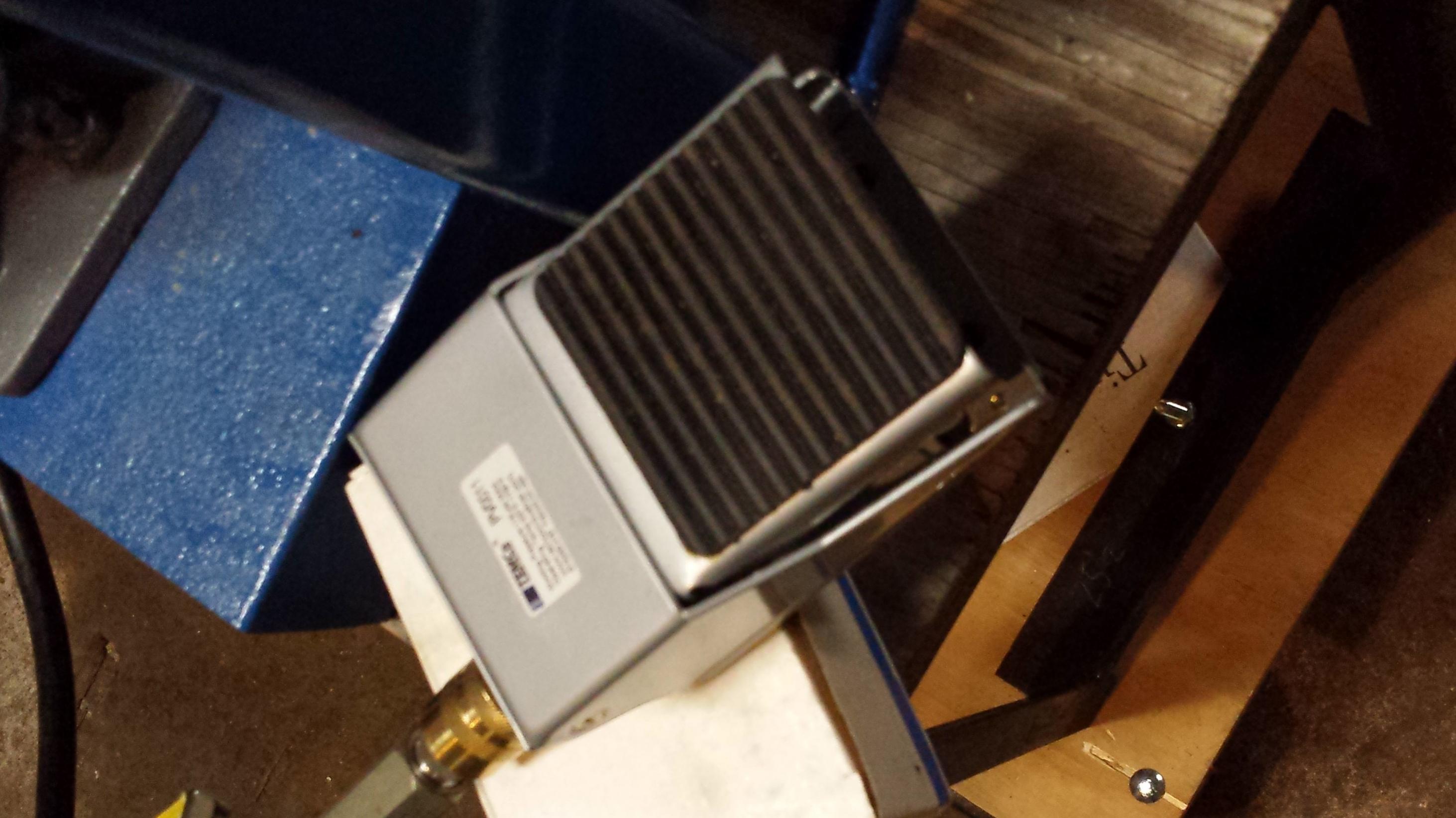

    20 ton Air/Hydraulic Mini Press-foot-pedal.jpg
    this foot pedal has one inlet and two outlets. I capped one outlet. It is a TEMCo PV0011. I got it off fleabay. Hope this helps.
    If I get more involved in the press work I'll have my brother in law put something together for me. That will cost though. This project was actually around $100 with the foot pedal.

    Thanks, I would like to see a video of the dies in action. I ordered that foot pedal.
