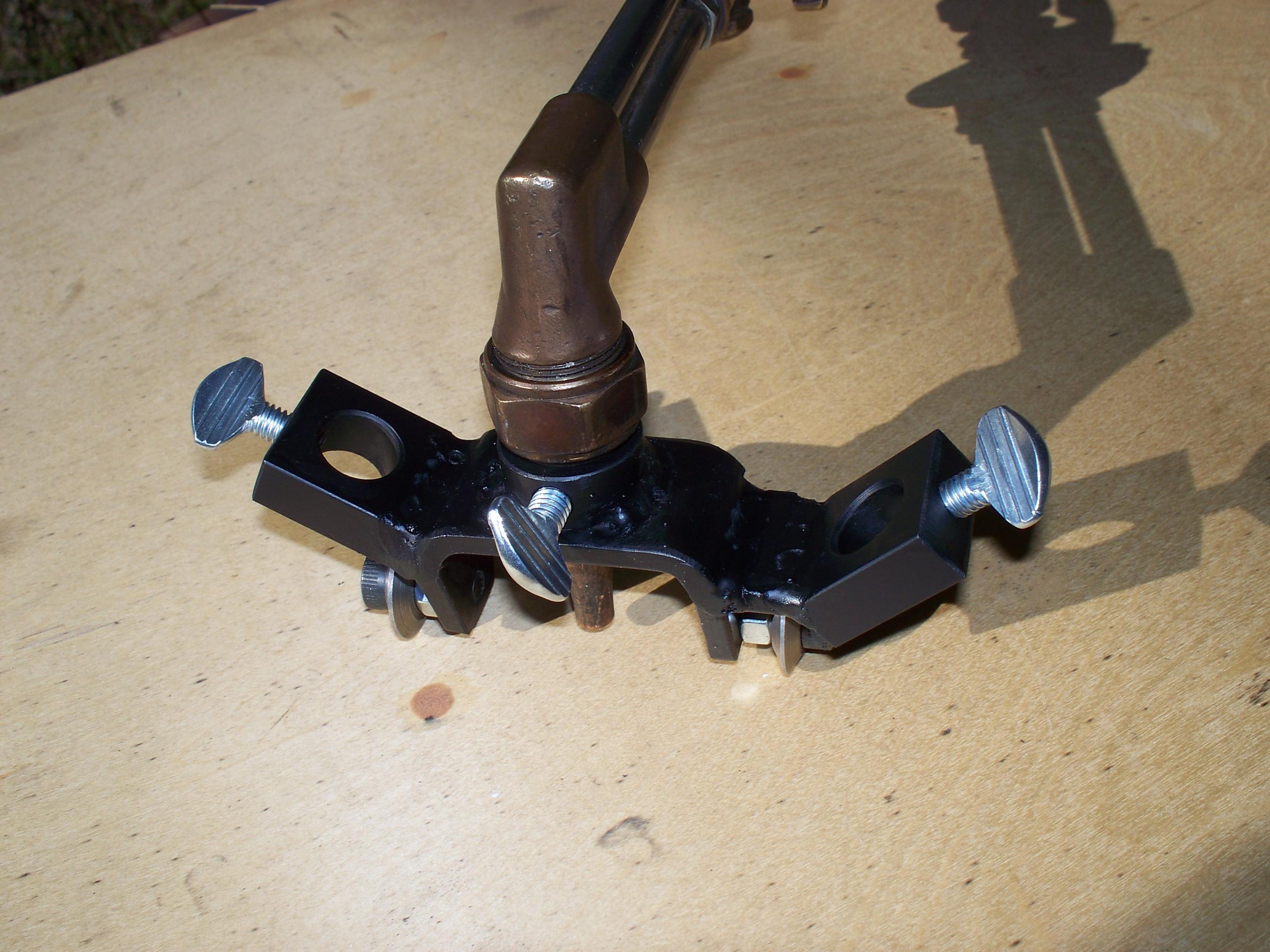

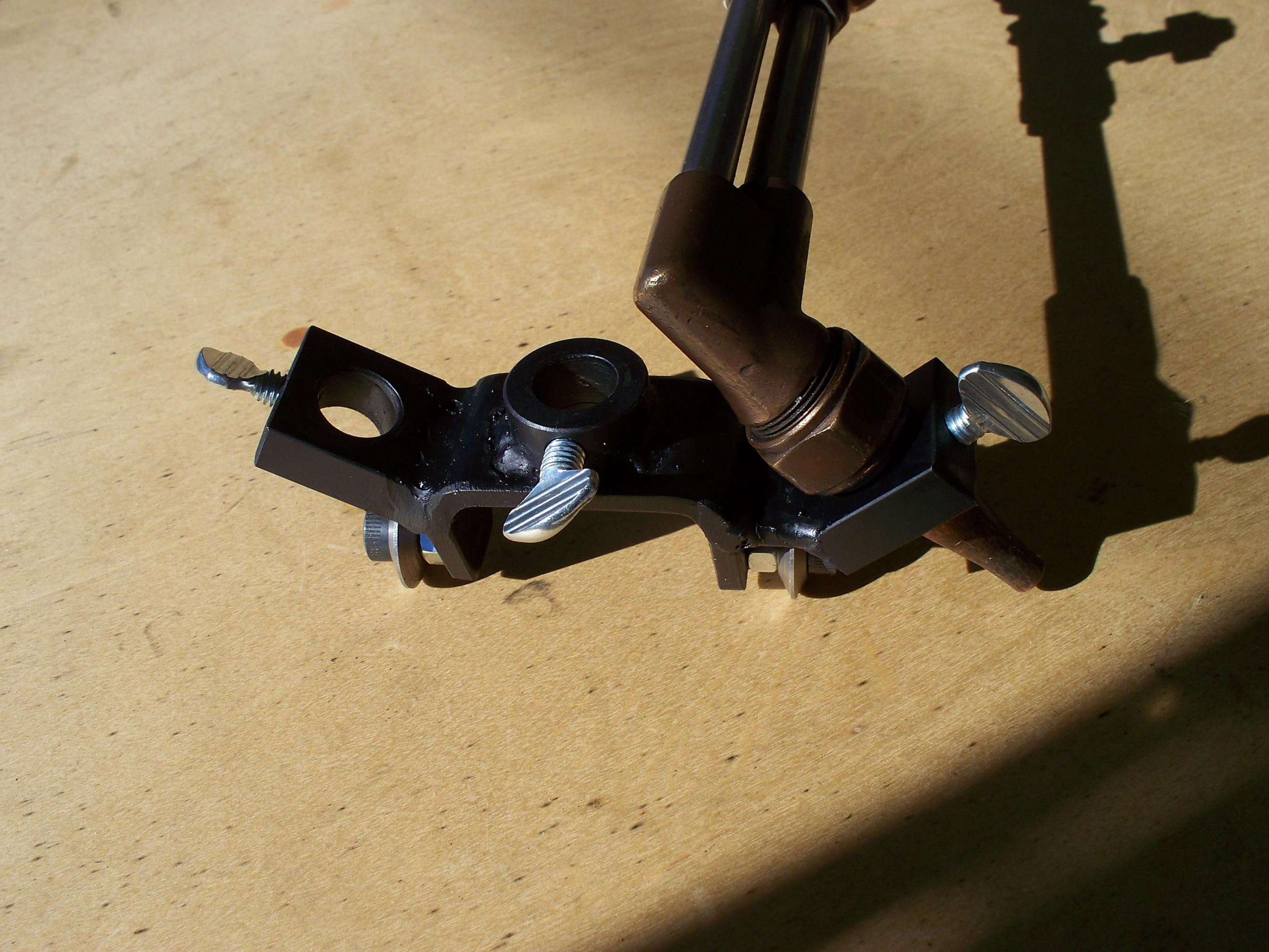

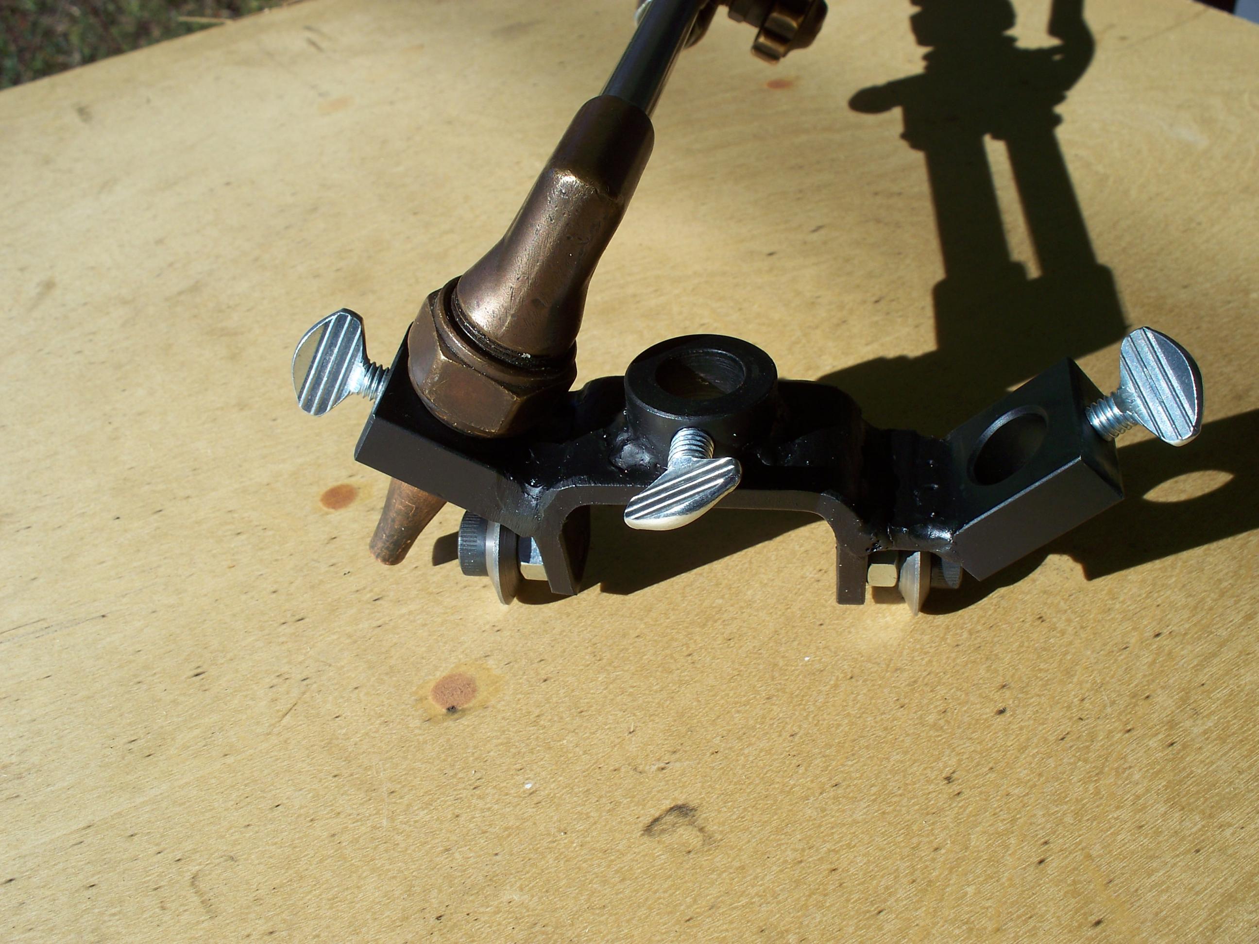

30/45/90 degree torch plate bevel attachment
When I was younger, I could freehand square and bevel cuts with my torch. But this oldtimer is not as steady as I once was, sAttachment 7554Attachment 7555Attachment 7556:smash:o I came up with this gadget for my Victor 2460 torch. The 90 degree setting is great for straight line and contour cuts. The 30 degree angle makes perfect bevels for plate welding and the 45 degree for edge bevels. I made the rollers from 1" stainless steel rod. This could be a useful project for you.
