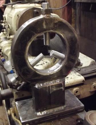

5 inch steady rest for Leblond 19 lathe
When you buy older or used machines more often than not not much of the tooling comes with them.
I needed a small steady rest for an up coming project I am wanting to build so the first step was to make one.

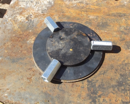

I started out with a couple of 8" dia. 3/16" thick disc that were picked up at the local scrap metal yard. then bought 3 3/4" coupling nuts and a piece of all thread. All thread is not ideal for making the adjustable guides but suitable for a light duty rest.
Attachment 9286

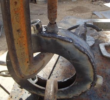

After welding the coupling nuts and discs together I bored out the center
Attachment 9287

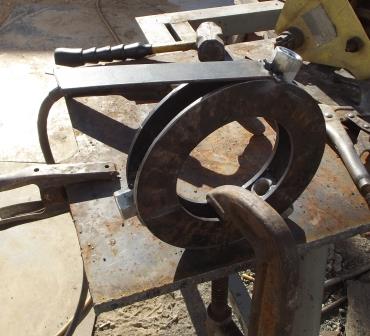

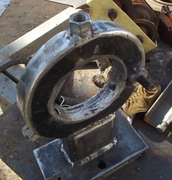

next I welded a 1/8" thick strap around the perimeter
Attachment 9288 Attachment 9289

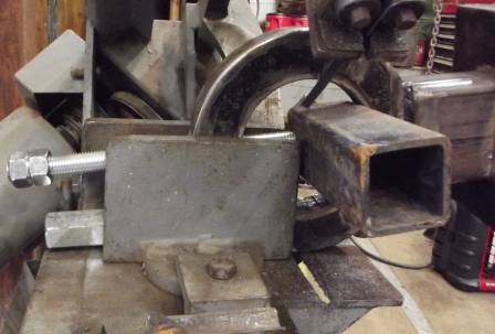

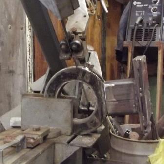

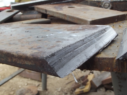

not wanting to try and make a hodge podge set up to mill a "V" grove in the base I elected to simply saw off the end of the sub base with my band saw
Attachment 9290 Attachment 9291

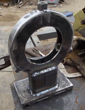

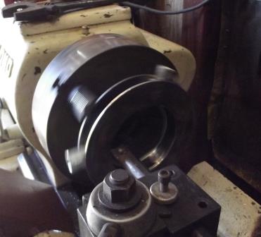

Next I chucked the rest in the lathe and tacked the base and stand to it
Attachment 9292

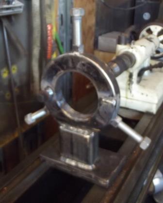

After welding I did a trial fit of the guides
Attachment 9293 Attachment 9294

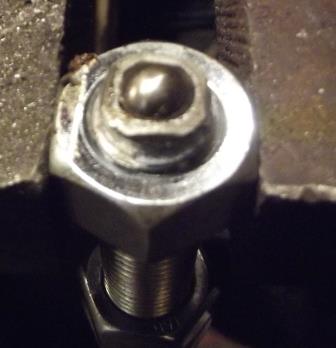

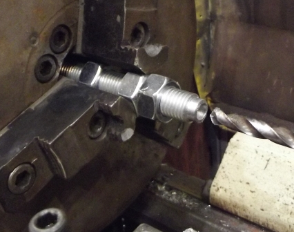

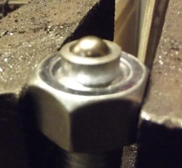

Then I machined one end of the guides and drilled a hole deep enough to accommodate a 10 mm bearing ball
Attachment 9295
then I slightly struck the guides in 4 places around the ball to secure it in place, the ball still rolls freely in its socket.
Attachment 9296 Attachment 9297

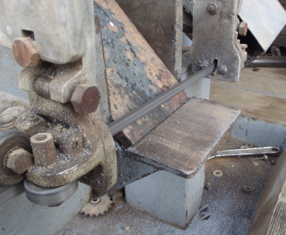

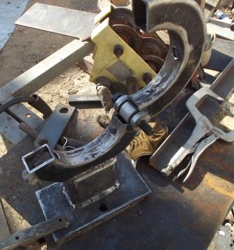

Next I cut the rest in two once the blade had cut nearly all the way through the first side the saw cut closed up binding the blade to free it I simply used a long piece of all thread and a piece of tubing to spread the rest open enough to free the blade
Attachment 9298 Attachment 9299
After separating the 2 parts and trimming one for the hinge I tacked the hinge in place then welded it and the hold down lock tabs to the opposite side
Attachment 9300 Attachment 9301

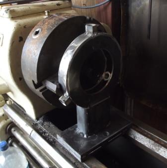

ready to use as soon as I drill 1 hole and clamp it down to the lathe
Attachment 9302
Some day when I have the time I may paint it
