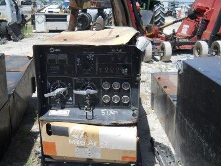

It's been a while since I did this on ebut I thought I would share.

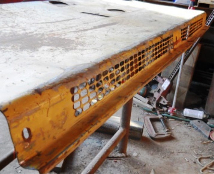

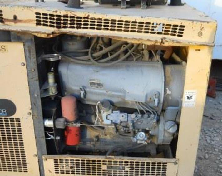

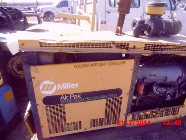

This is a 500 Amp Miller Air pac with a 12 KW 3 ph option it was in pretty sad shape after being used by the railroad for many years, but it still ran and all systems functioned as they should so that made it worth rebuilding
Attachment 20016
Attachment 20017
Attachment 20018
Attachment 20019
Attachment 20020
Attachment 20021

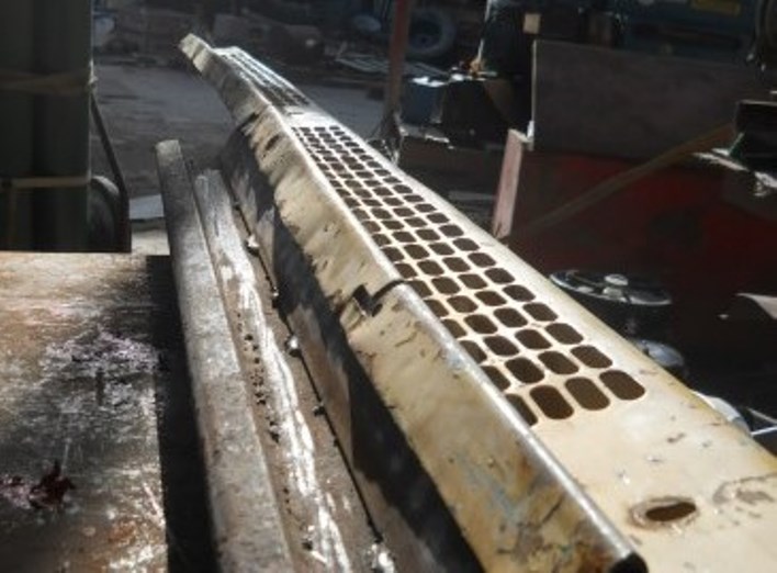

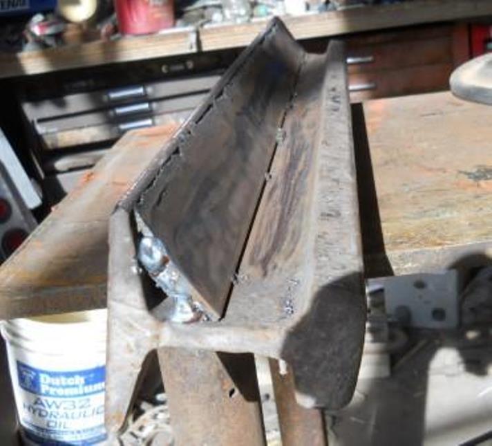

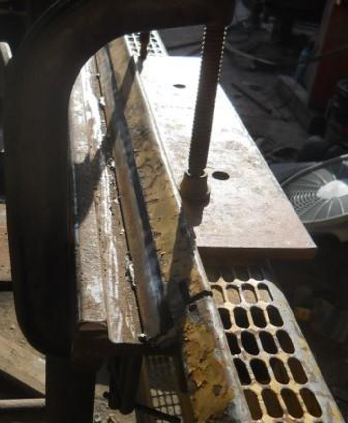

Railroad track Forming anvil die I welded a strip of flat bar to one side of the rr track so I could have a different forming anvil shape for straightening the top and side covers
Attachment 20022
Attachment 20023

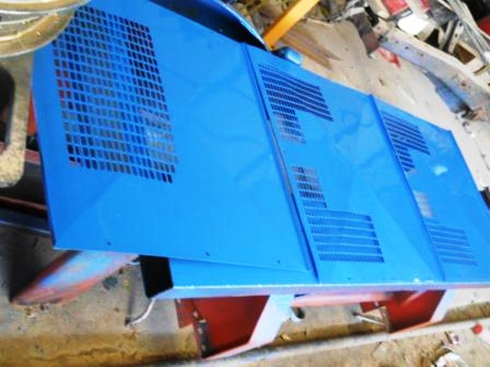

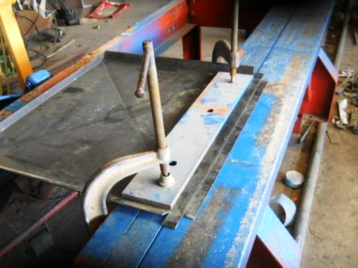

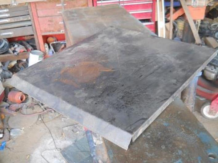

Some covers were missing so I had to hand make them

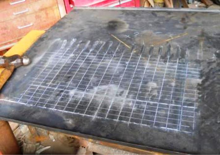

Attachment 20024

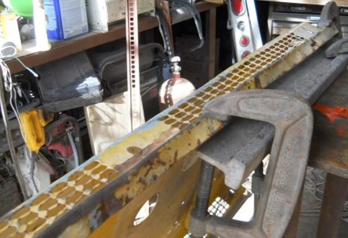

Laying out for perforation punching

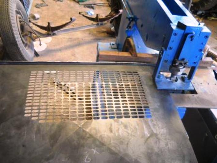

Attachment 20025
Using my Roper Whitney 8 ton manual punch with a special ground die to make the oval perforations the Die and punch were bought from Cincinnati punch works
Attachment 20026
Attachment 20027

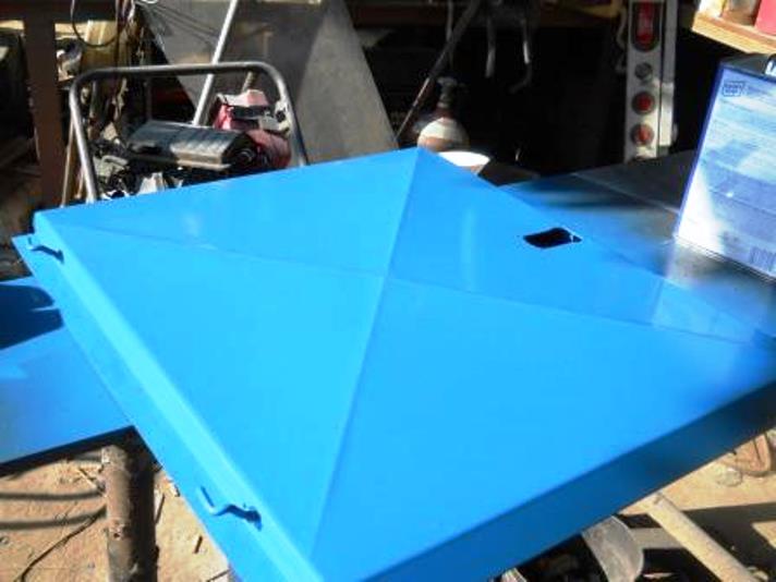

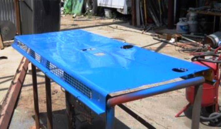

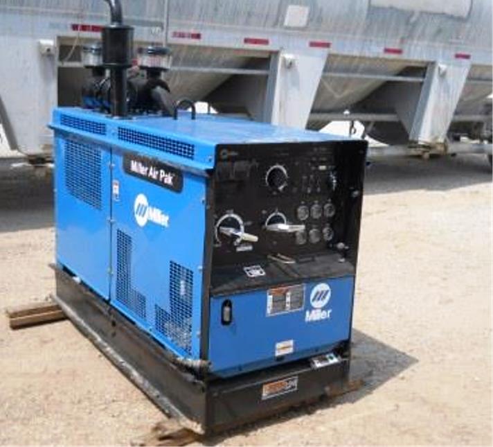

Splash on a little paint and good as new. Almost impossible to tel which panels were straightened and which were hand made
Attachment 20028
Attachment 20029
Attachment 20030
add a few decals and that is how you take a $800.00 salvaged machine to being sold for $15,000.00
