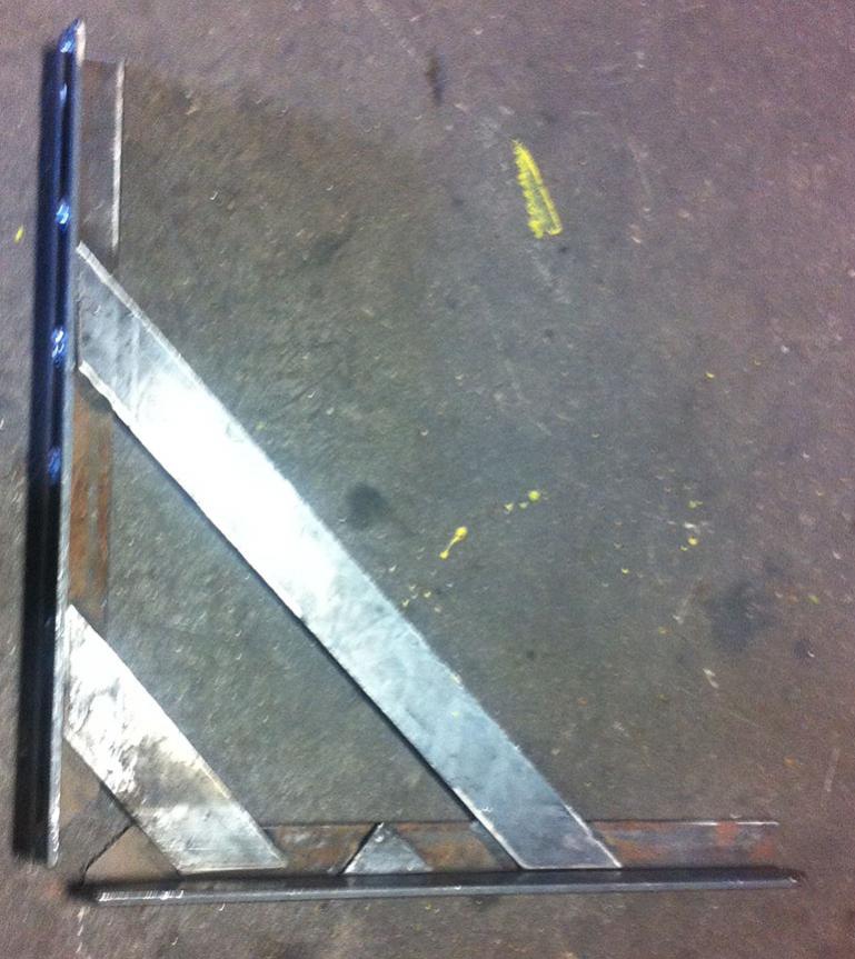

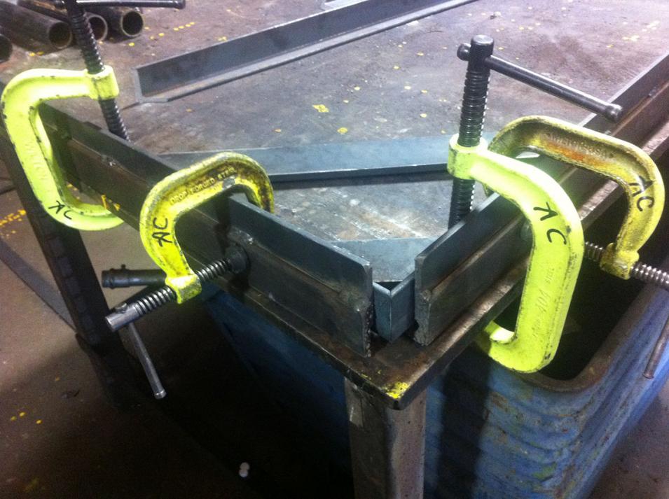

I fabricate frames of differing sizes and types of metal. I fabricated a brace to hold a corner square while at the same time allowing access to the corner of the frame for welding. pic 01 shows the brace laying on the floor empty. The second pic shows a frame ready to weld the corner.
