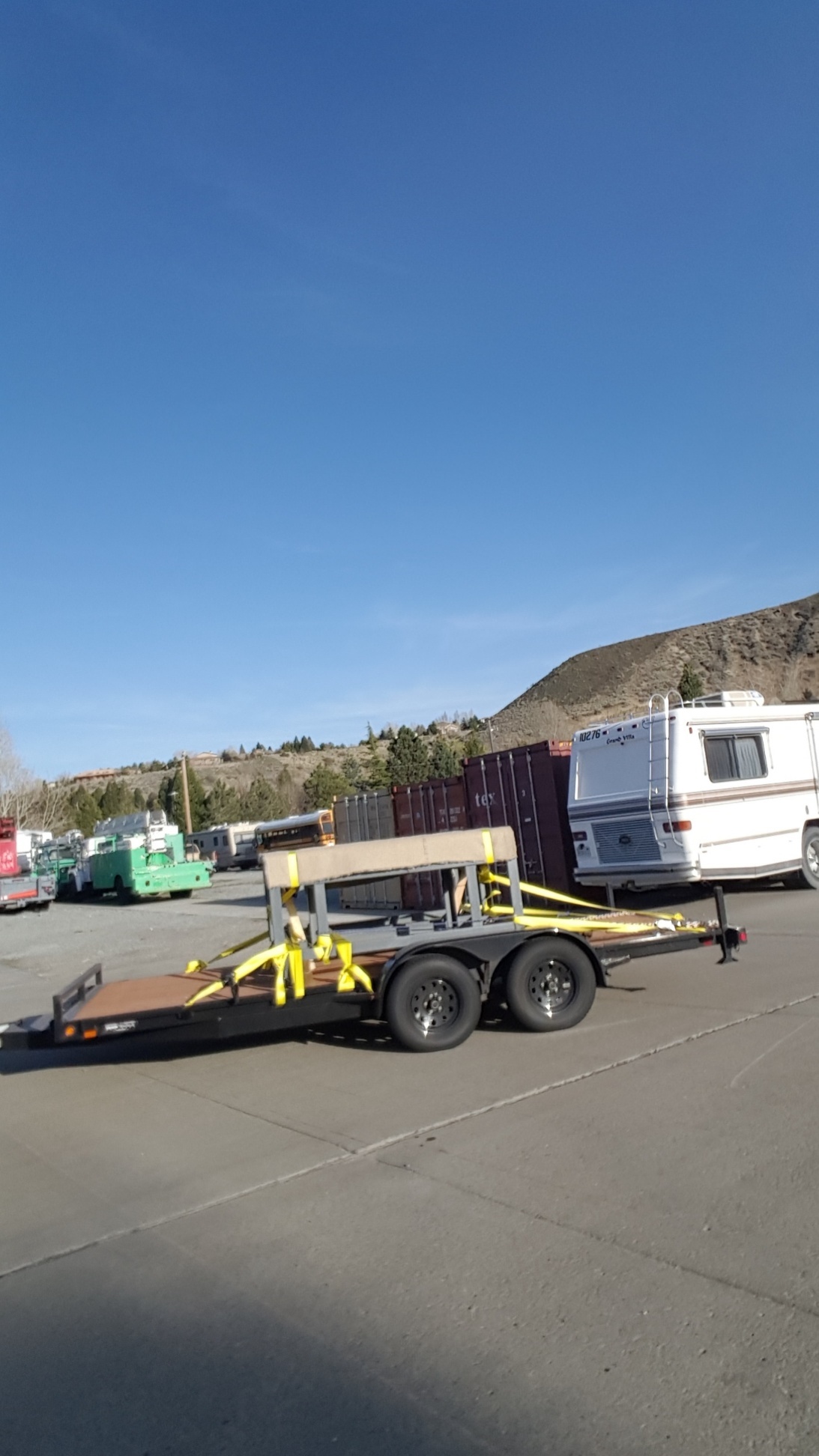

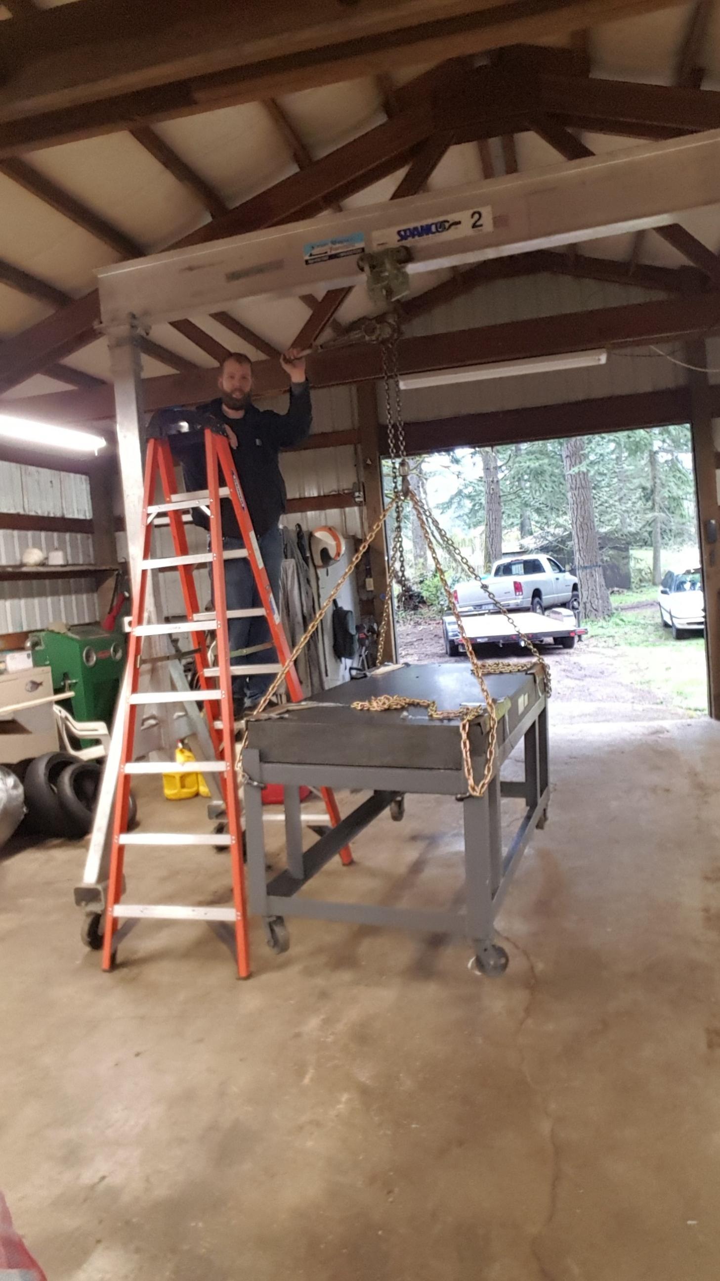

    Thanks to you all gents!
    Got them back home last Saturday without incident! Many nylon straps tying them together and tying them down!
    about to transport-surface-plates-2.jpgabout to transport-surface-plates-1.jpg

    Home in one piece is always the best out come. Looks like you had the right piece of equipment for moving it. Too many times people do not factor in the weight and the pulling vehicle does not have enough power or braking specs, but success is always great.
    Very good job.
