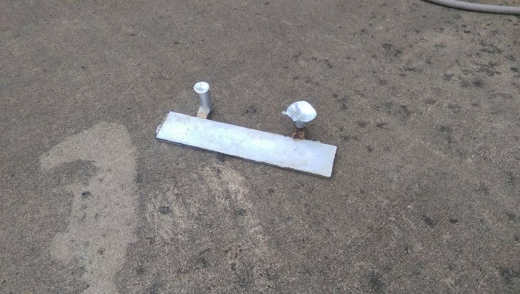

I have just completed my aluminum melting foundry and thought I would share my build. I have been doing a lot of research and watching videos for the last year. I finally found sometime to start working on this just before Thanksgiving. It went together pretty well and I have been having a lot of fun with it so far.
*****PHOTOBUCKET HIJACKED MY PICTURES SO I HAVE EDITED THE POST TO ADD THE PICTURES BACK. THEY ARE NO LONGER IN ORDER TO MATCH COMMENTARY MADE WHEN THE THREAD WAS STARTED. MORE PICTURES AT THE END OF THE THREAD.

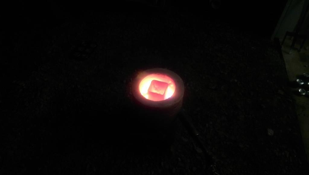

After cleaning it up and some paint.

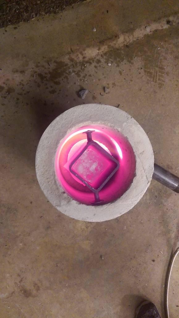

Here is my crucible. It is made from square pipe and 1/4" plate.

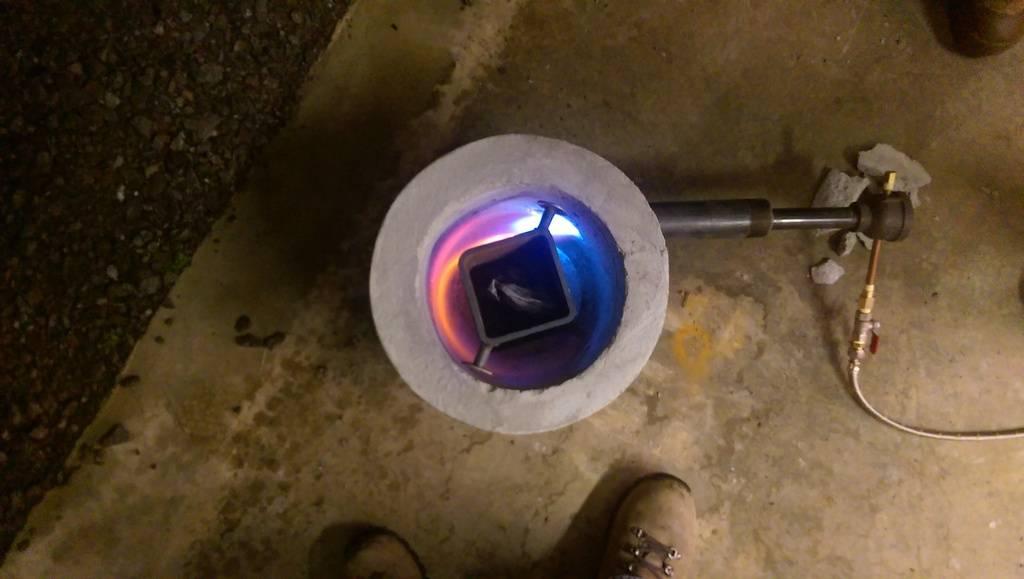

I am using a Reil style burner. It has a 2.5" to 3/4" bell reducer on one end of a 3/4" pipe and a 3/4 coupling on the other. The tube feeding the propane is a 1/8" brass with a small jet hole directed down the burner tube. The coupler and reducer were both milled to remove the threads on the incoming and outgoing sides. The burner if feed from a standard propane tank with an adjustable regulator.
