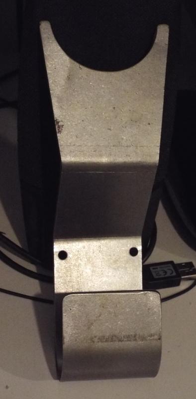

This is something I did a little while ago, like quite a few I have a couple of angle grinders, one with a wire cup brush, one with a flap disc and one with a cutting disc fitted. To keep them neater when not in use I made a few of these holders from 2mm sheet.

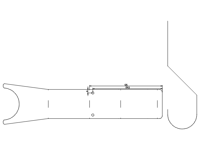

Above is a jpg from my CAD program, it shows the basic idea, where the bends are and final shape.
I tended to group say four at a time and cut them out with my home made CNC plasma cutter, basic use of the flap disk to take the burrs off and then have a bit of fun with a home made press and basic tooling to get the shape.
A rather poor video really showing me with the press, but the job was the angle grinder holder, the two holes allow it to be mounted to the wall.
