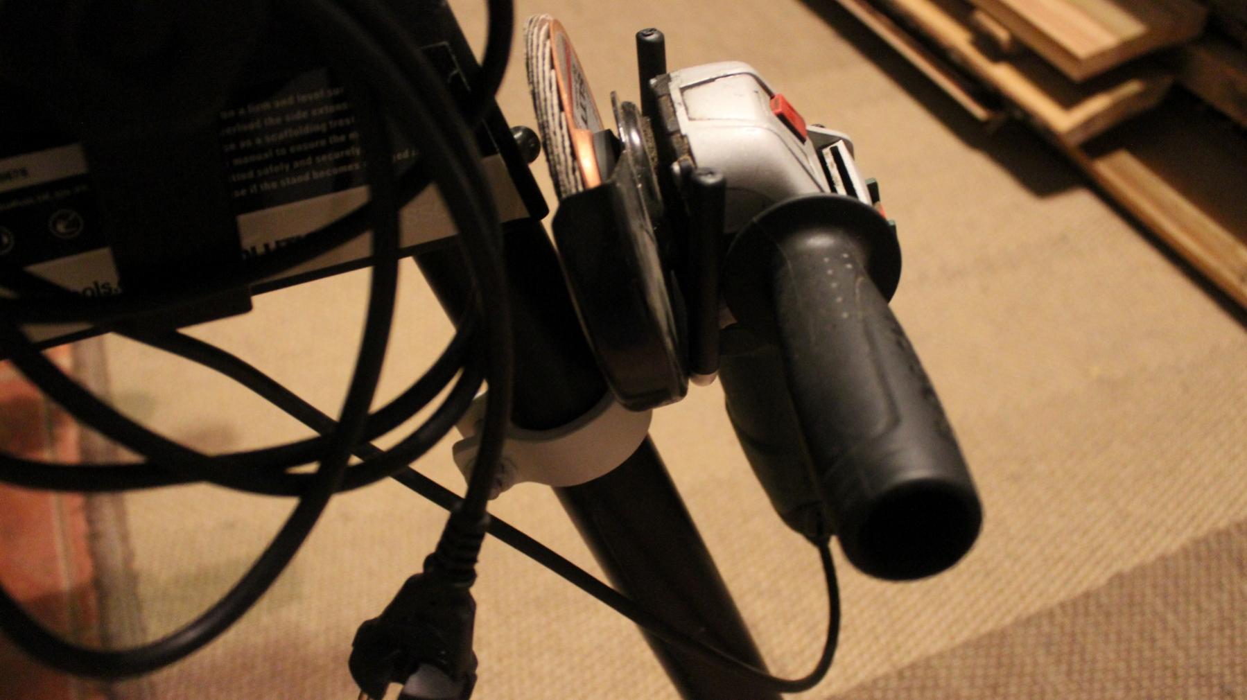

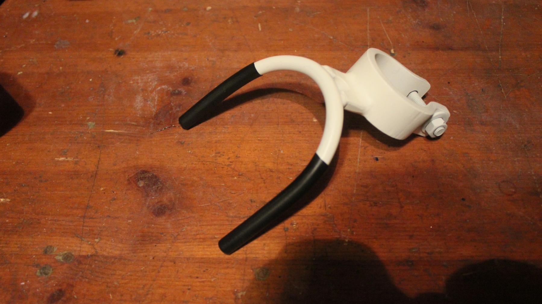

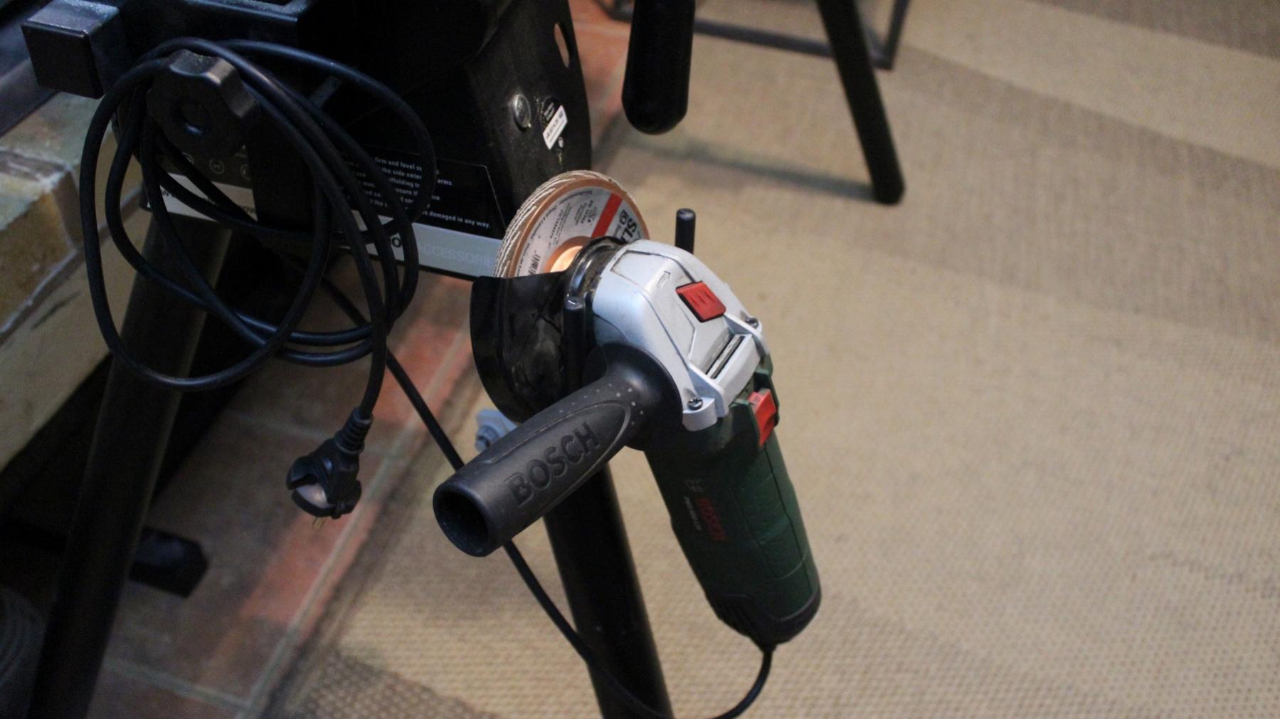

    More universal version than the first one.
    This is actually for random orbital sander, but angle grinder fits to it too.
    Fingers are covered with heatshrink.
    Made it from 6mm flat bar and 10mm rod. Bends made with press. Took couple tries to get that round objects bends right.
    Edit:
    Lol.. both are round, but i mentioned that one made from the flatbar. Bending can be done with press, when piece is shared to sections. I counted the circumference and shared it to 15 sections. ( 50mm diameter x Pi = 157 / 15 ~ bends with 10 mm interval )
    I took measures from the center of the flatbar, made the holes first.
    First i made the outer bends, about 70 degrees. ( ones nearest edges ) These come to the opposite side of the flatbar, than other bends.
    Then i continued from out to the center making similar bends for the both sides, about 20 degrees.
    Last bend comes to the centerline. With little paractise its possible to get round enough pieces easily.
