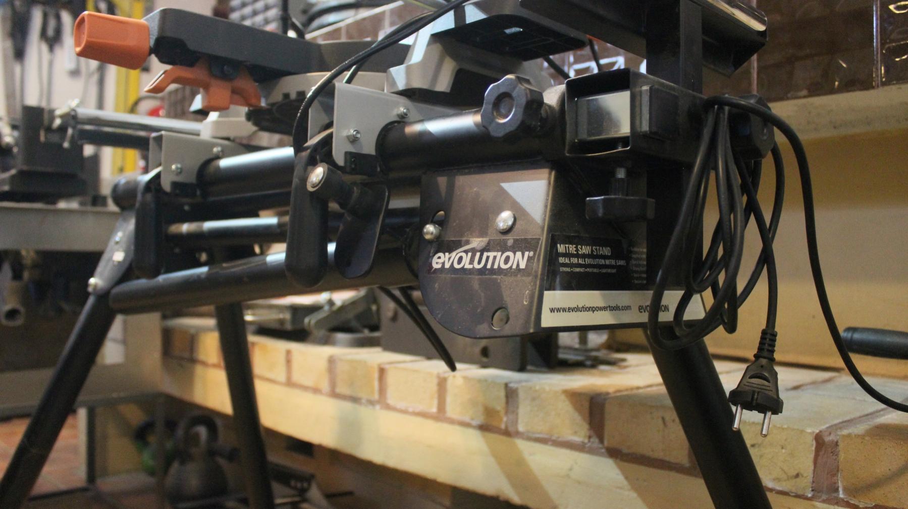

Last days, i have used miter saw quite a lot for cutting metals.
Tought that it would be usefull if grinder comes with it, then i can wipe out coarse right after cutting.

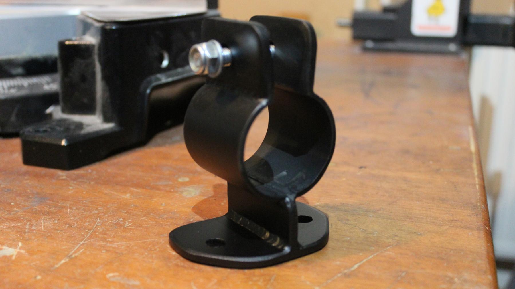

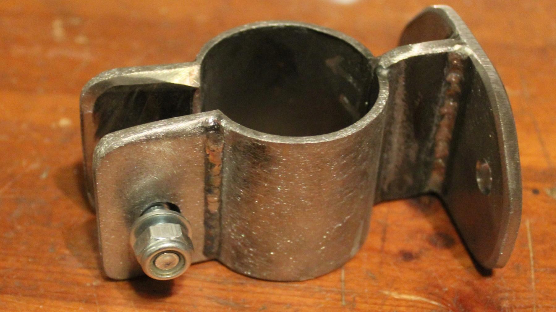

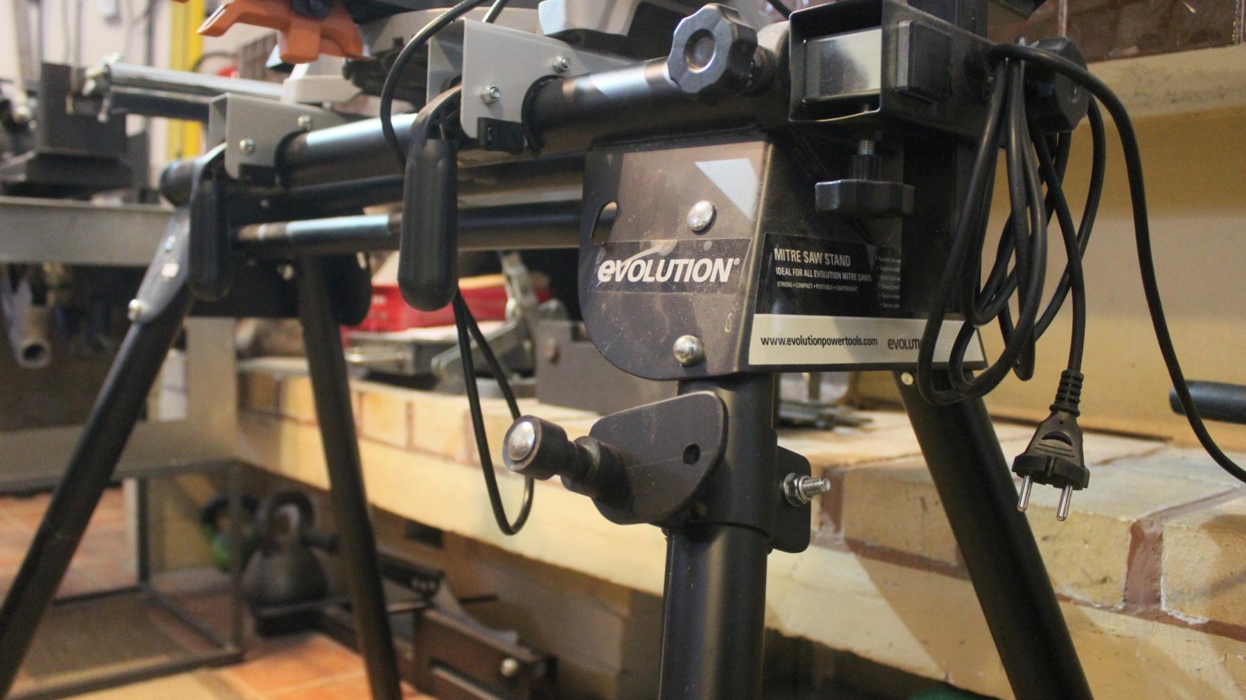

Made this simple holder for my grinder.
Material is 45mm pipe and 5mm steel plate. M8 screw and some rubber plugs that i have hoarded somewhere.

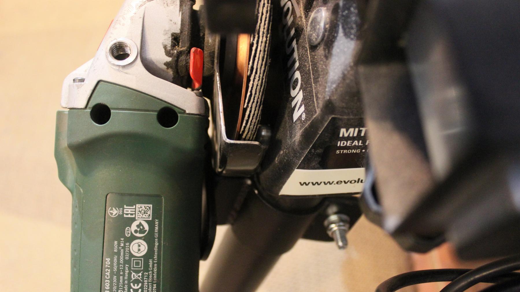

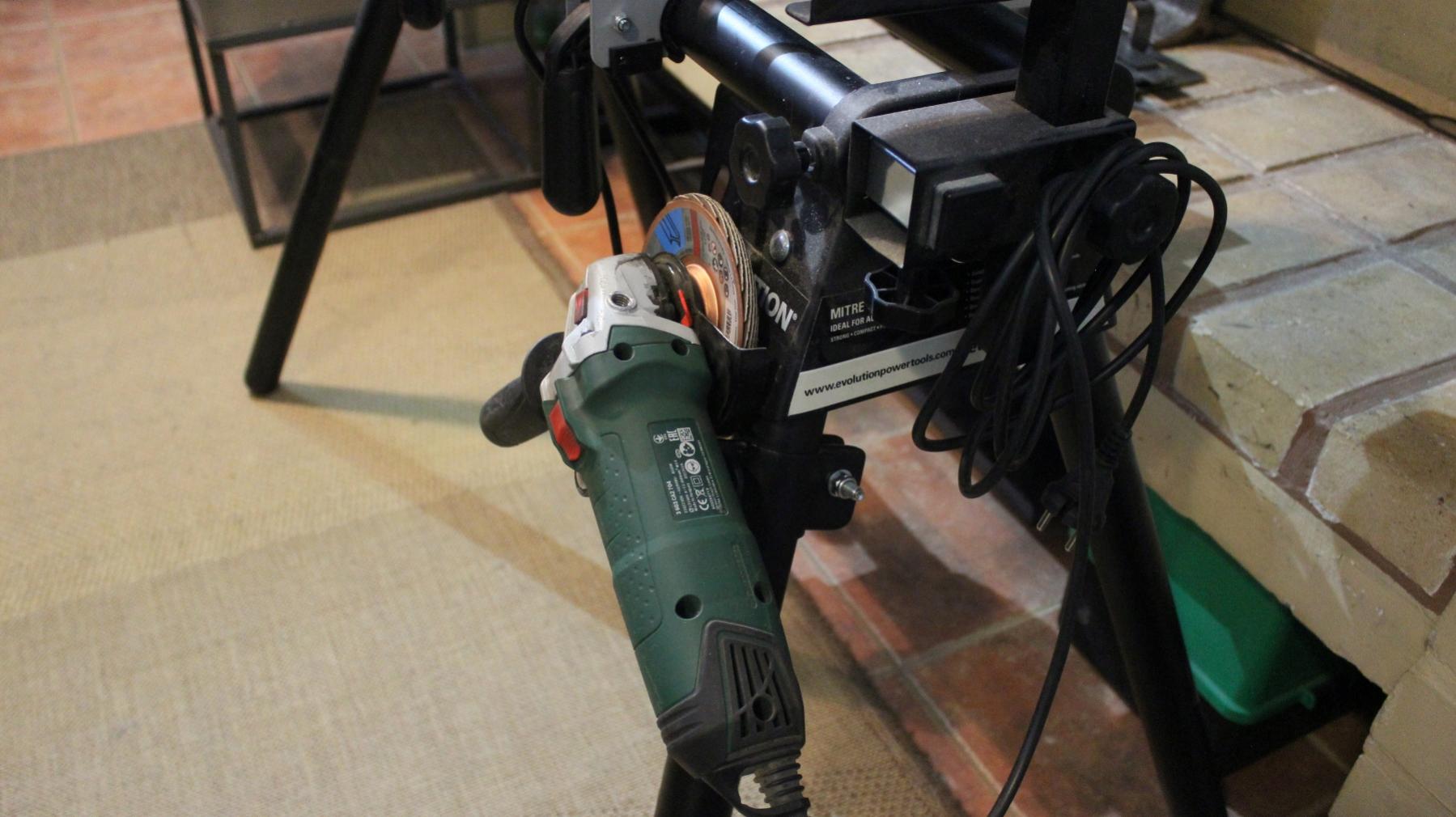

Angle grinder rests between rubber plug thingys, and disc guard leans to the locking button of the stands feet.
Grinder stays nicely on its place, even when shaking the stand. Very simple solution.
