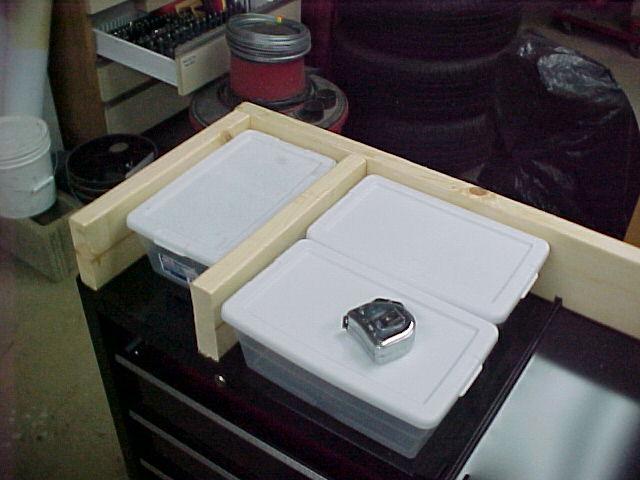

Sears had these 53" roller cabinets on special a while back. They are pretty flimsy but, for cheap tool storage they work just fine. I added a 2 x 6 top to this one to raise it up a bit so it is more comfortable for me to work at. This put the top at about 39".
I leave one side open on these tops I build so there is room for a few clear plastic shoe boxes. Lots of storage and it helps organize smaller projects as I am working on them.
Here I am laying out the spacing for the top. I can get three boxes on each side.
