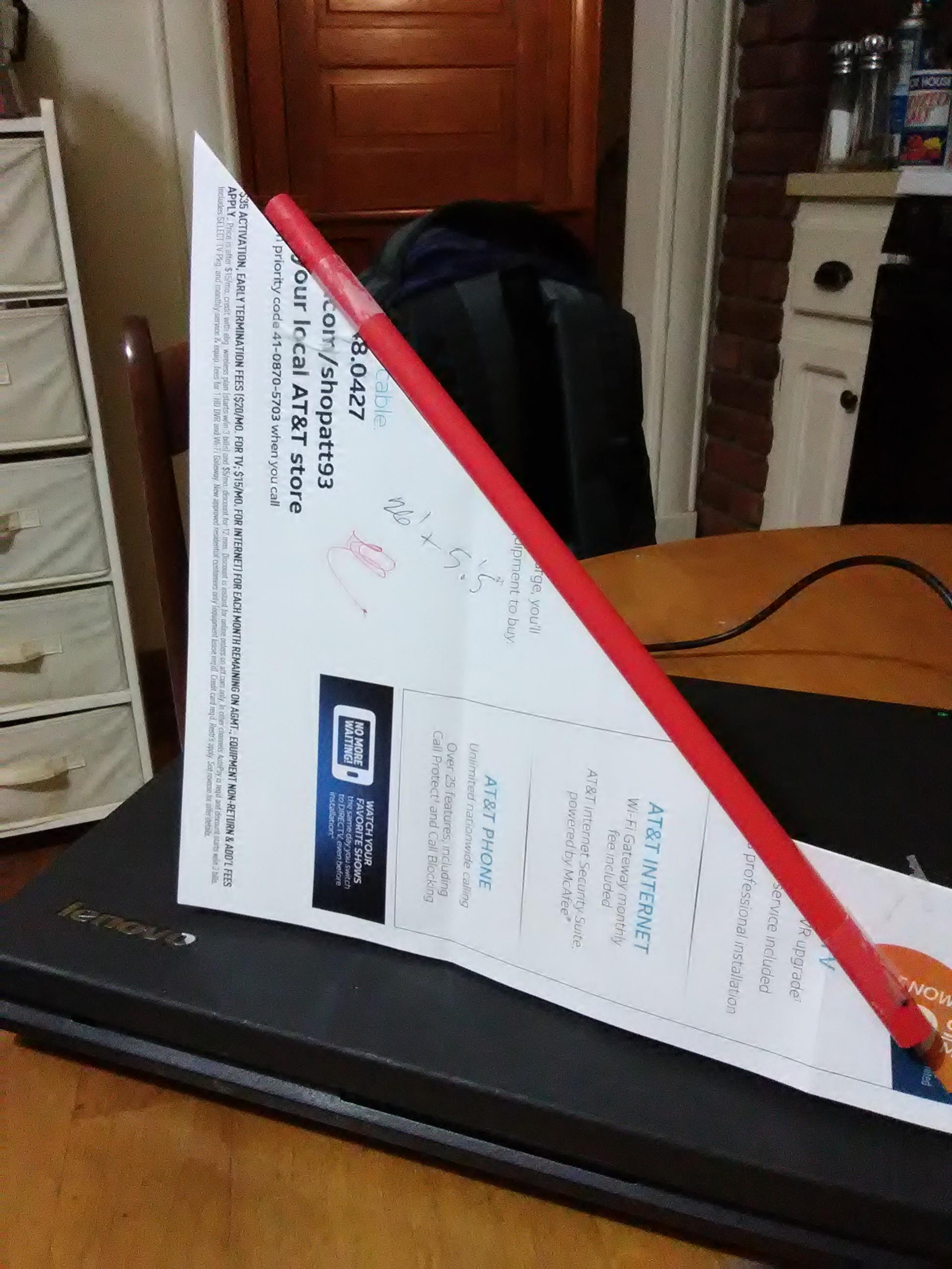

Next day, disposing junk mail I hit upon this solution. By folding over top edge of paper to adjacent side, an accurate square results. Folding two opposing corners creates an accurate 45°. Next, tape plastic drinking straw to the 45° edge.
Attachment 22689 as usual, click the pic for a less microscopic illustration.
Step forward or back, until intended object appears through the straw, while holding corresponding paper edge parallel [or perpendicular if you prefer] to the ground.
Mark the spot on the ground at your toes. Step back additionally the height of your eye from ground level. That new point is intersection of 45° from whatever object viewed to figuratively horizontal plane. Measure distance from that second mark to a spot as close to directly under [plumb] the object sighted in the straw.
My light turns out to be about 31 feet up, in 1" rigid conduit!
