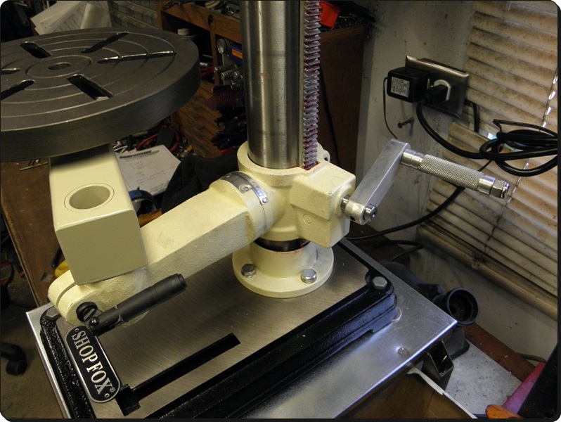

Articulating Drill Press table extension.

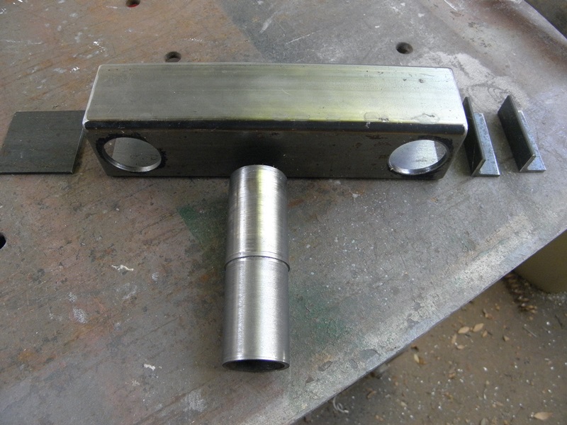

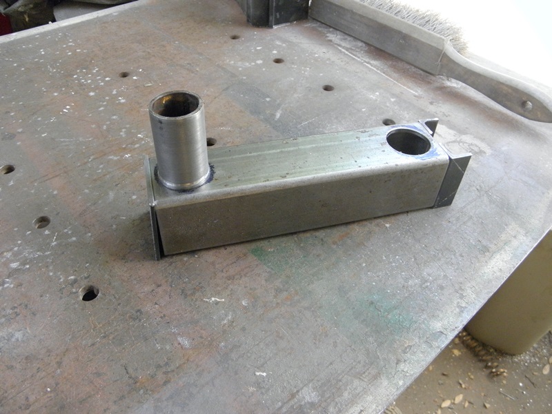

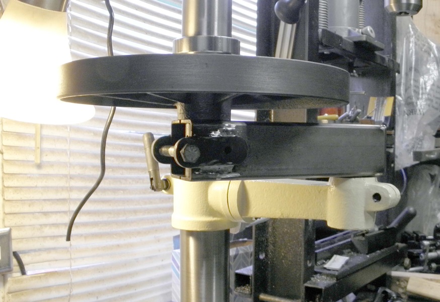

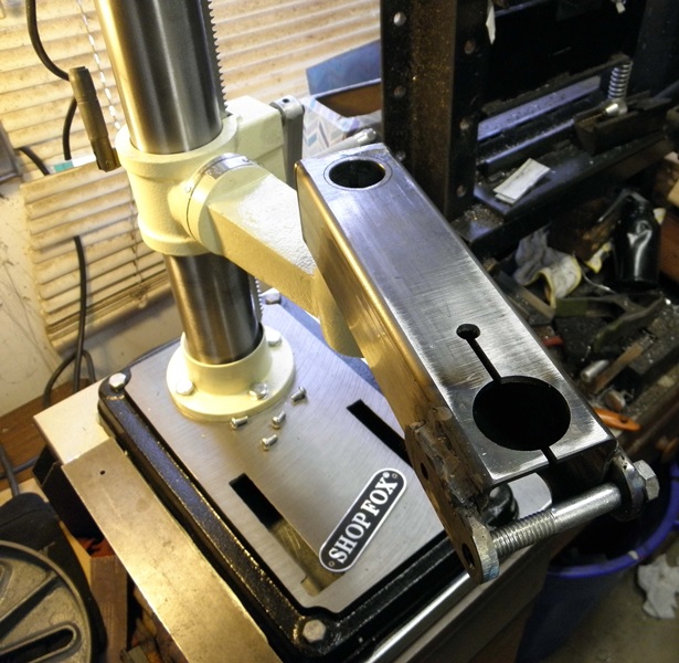

Articulating Drill Press table extension. This drill press has an extending/rotating head on it, and is the reason for the table extension. Made from 2 inch square tubing 1/4x1 1/4 inch tubing cut to size on the band saw and lathe. Shop Fox drill press.
The slit I made is hard to tighten, but it works I will increase the slit for less tension before I paint it.
I did not use the angle brackets as shown I made two 1/4 inch rectangle and rounded on each end, which I welded to the square tubing
on either side to hold the 3/8 threaded bolt to be changed out later for a wiggly giggly handle.
