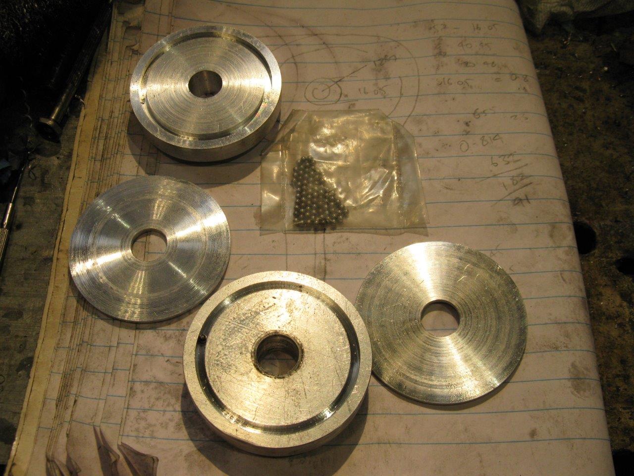

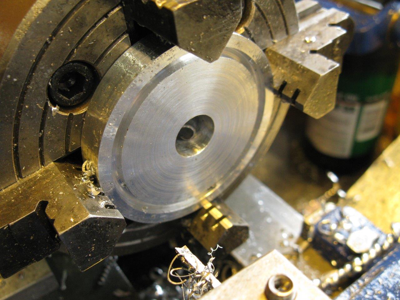

still a bit of a work in progress, but I made these in the hope of balancing a wire wheel which is causing my grinder to vibrate.
Idea is to have a groove in which some ball bearings are free to rotate and come to rest at the point of lowest effective mass on the wheel, thus balancing it. Well, that's the idea anyway, not quite there yet.

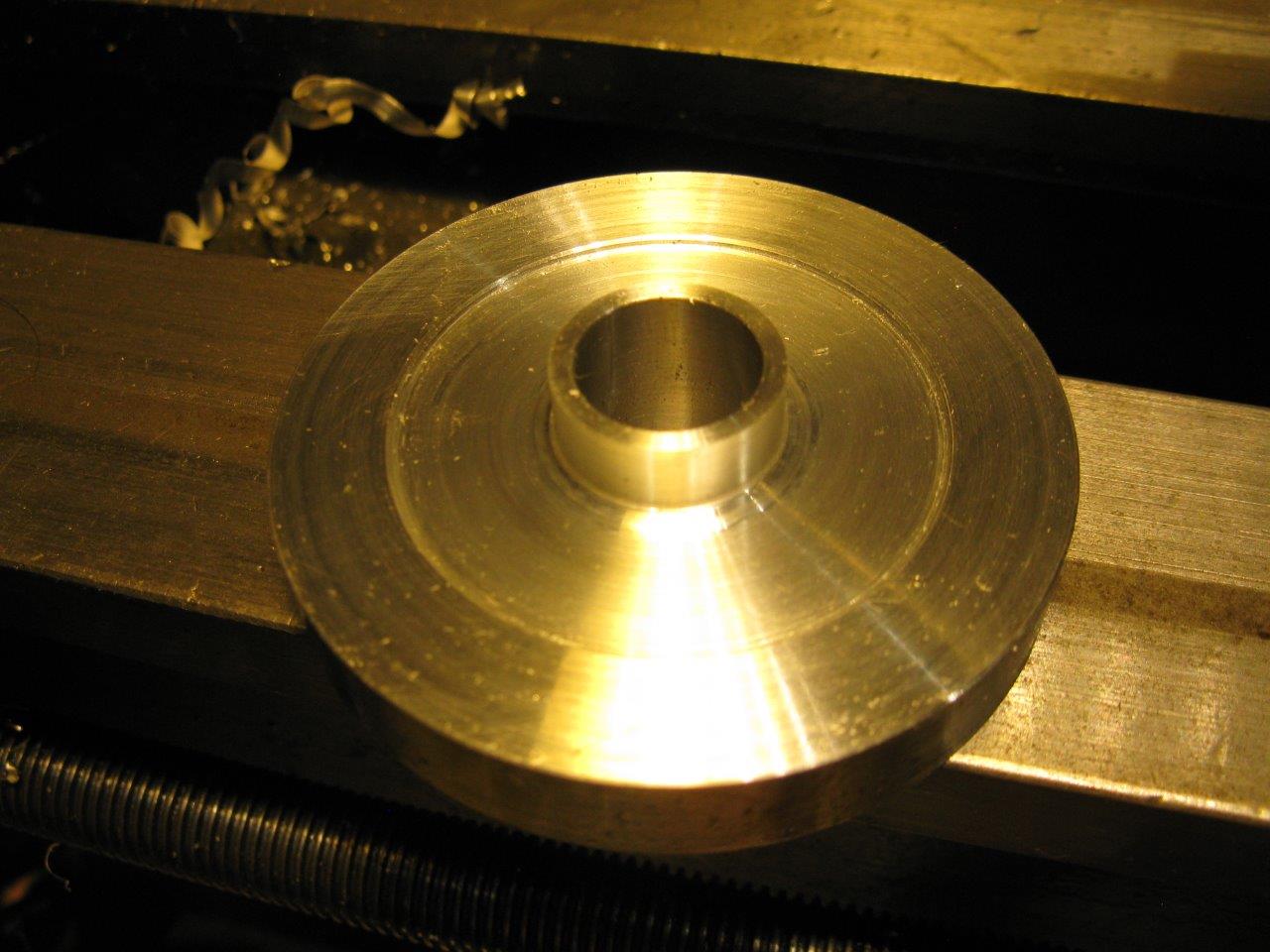

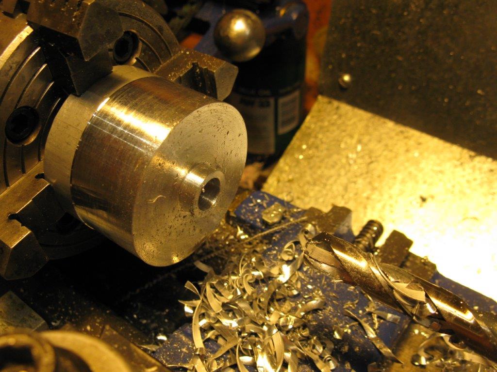

blank turned and drilled
Attachment 13073

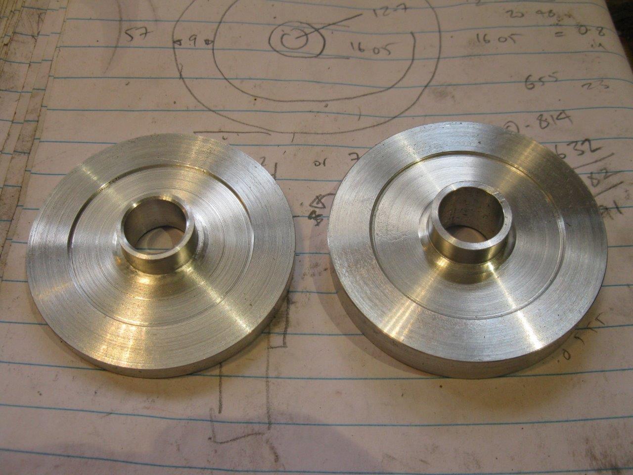

reamed to 0.501 or so, slip fit on the arbor. Face relieved so that the arbor only contacts the wheel at its periphery. Not 100% sure why this is necessary, but that's how the original ones are made so..
Attachment 13074

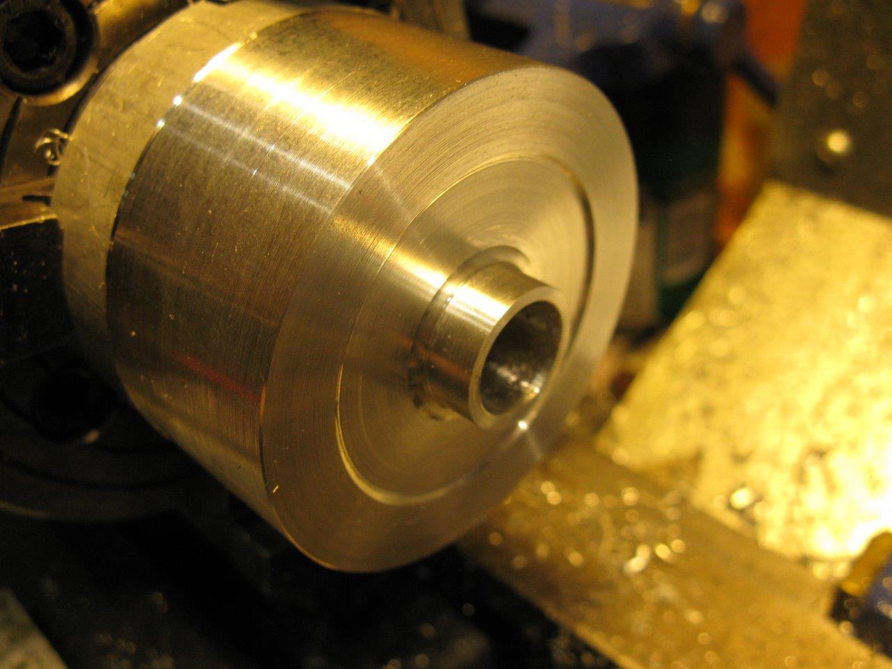

first arbor parted off
Attachment 13075
one set done - the other set was already made from a previous grinder
Attachment 13076

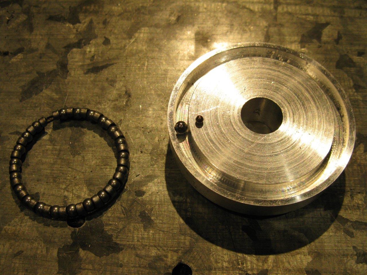

mounted, centered and a groove trepanned for 3/32 balls (for my mtb pedals)
Attachment 13077

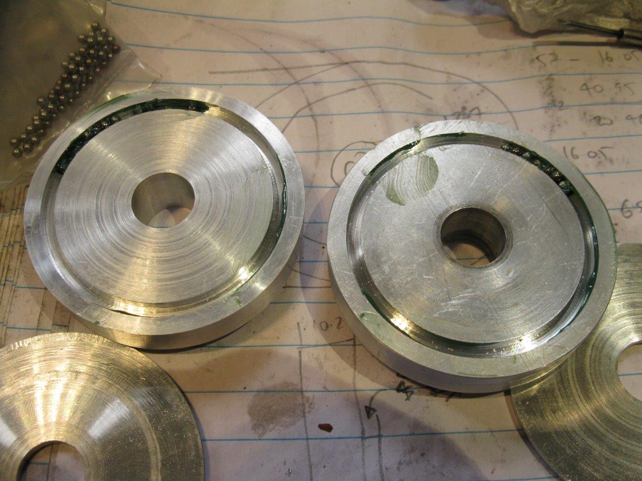

both sides done, with the bearing covers also parted off from the same blank
Attachment 13078
test fit
Attachment 13079

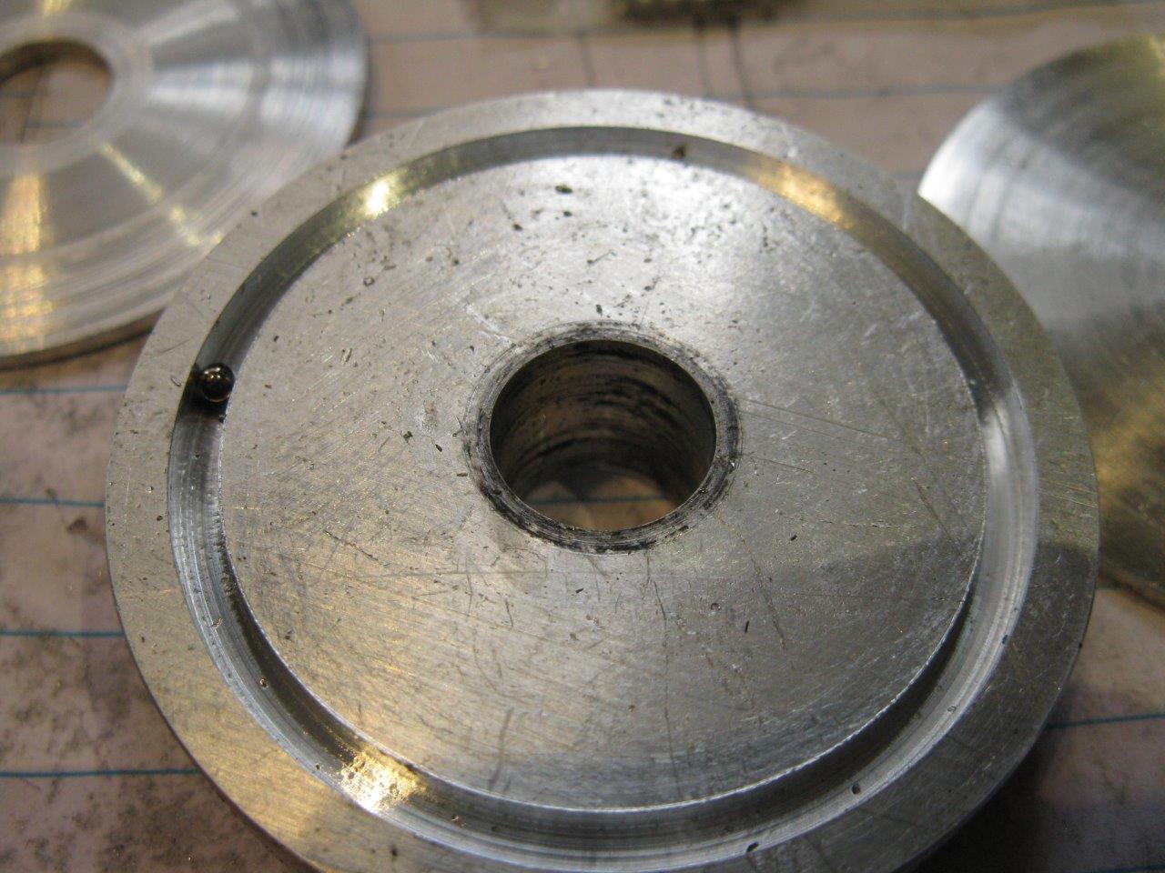

balls loaded. After the 1st try, where nothing happened, I cleared out the grease. Still nothing, so I added more balls - 25 on the wire side.
Attachment 13080

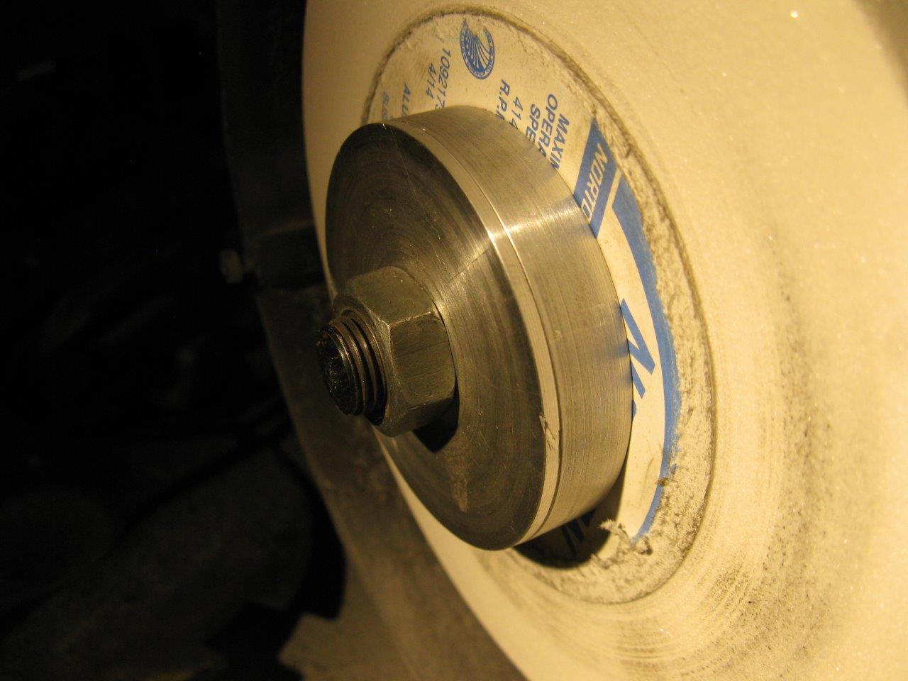

stone side. This side really didn't need any balancing, ran really smoothly without any balls. Figured I'd add them anyway in case the balance changes over time with wear
Attachment 13081

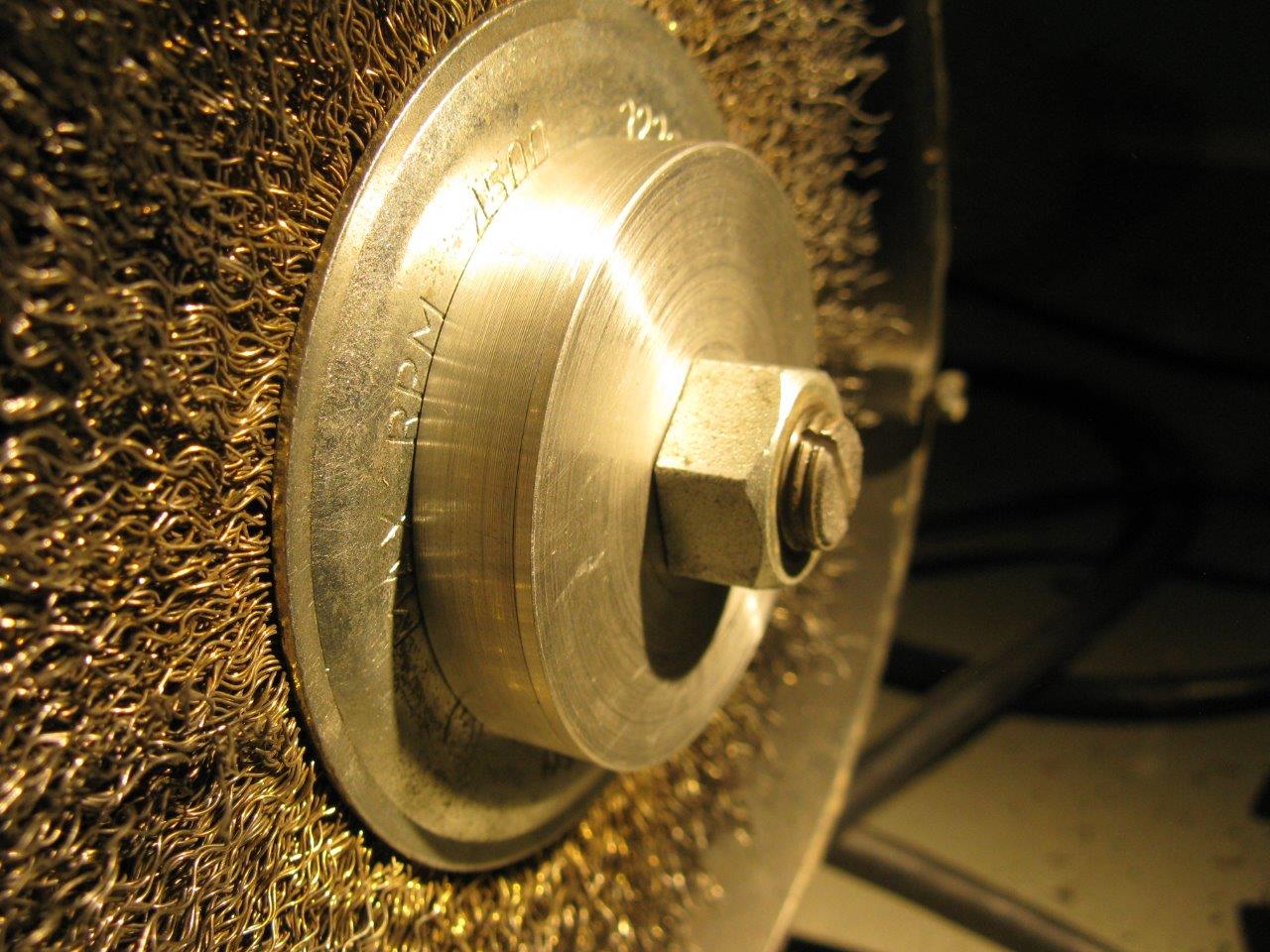

wire wheel side
Attachment 13082
the arbors did help reduce vibration a bit, but not eliminate it completely. I'll be cutting the groove to 2x ball width to allow the balls to bunch up to see if that improves things. If not, I cut the groove deeper and use larger bearings for more mass. I'll report back with my findings!
