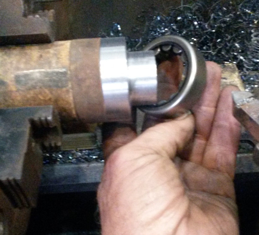

The proper tool to install one of these bearings must have a pilot long enough to reach complexly through the bearing this prevents the rollers from possibly falling out of the delicate cage often made of plastic

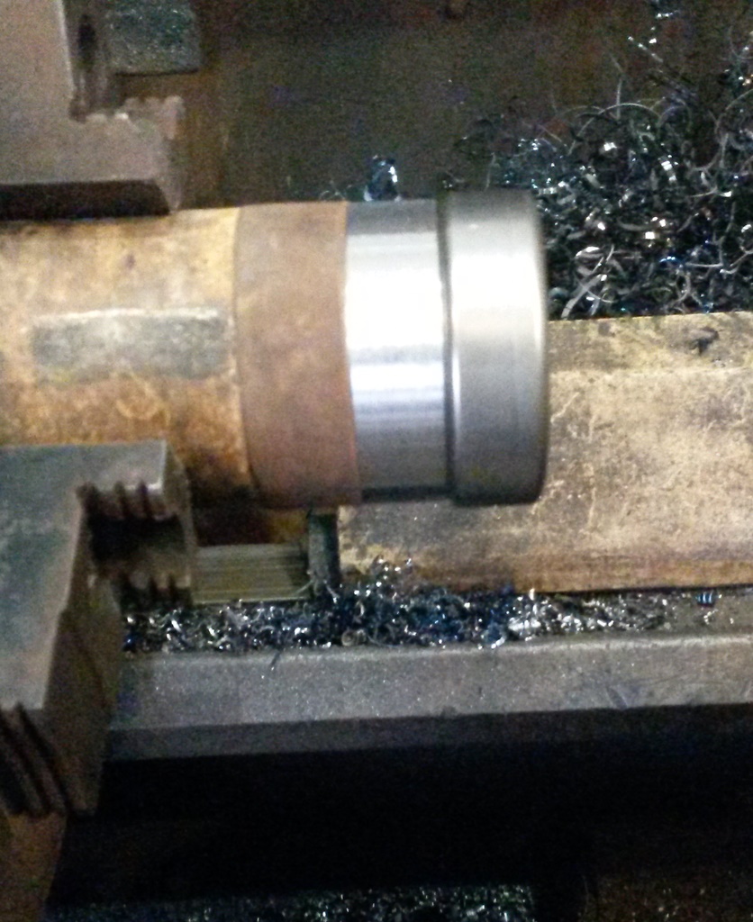

Here is what I did first i located a scrap piece of cylinder then turned it down for the pilot
Attachment 24757

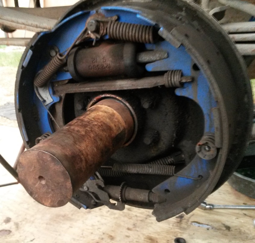

there was no reason to turn it any further. Later I might part it off and drill the center to fit my driver handle just because it would take up less space in a box.
Attachment 24758

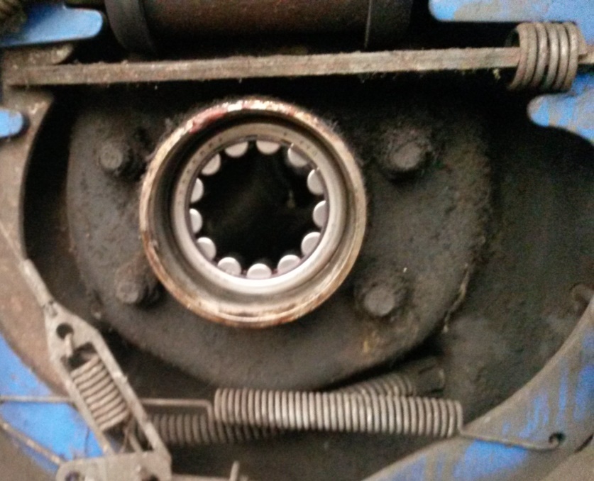

Bearing driven home
Attachment 24759
Attachment 24760
The plus side is if I polish the surface and radius the end I can use the same tool to install the seal
