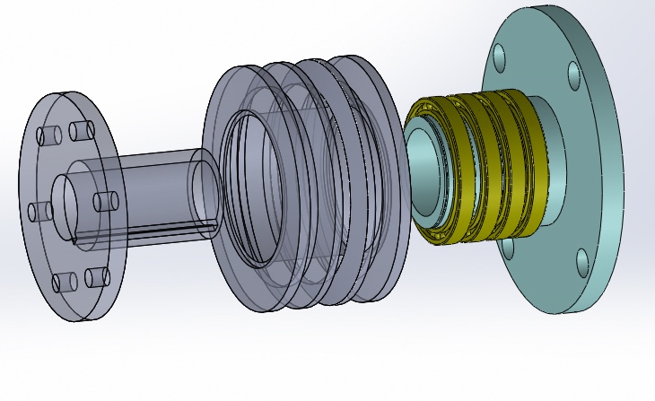

Pretty sure there is a bolt pattern in the block for a housing to be mounted on. If it were me I would look into making an overhung load adapter like this
Attachment 24814
OK kind of hastily drawn the flanged housing would bolt to the engine the coupling with 6 holes would be keyed to the crank and fit inside of the housing or hub the bearings would fit the hub and the pulley shown is a overhung load adapter for a 1.5" crank shaft the pulley is 5.5" OD the bearings are 65 mm ID 85 mm OD use 3 or 4 a seal could be used in the pulley to the hub if open bearings were used. If that were to be the case then a seal between the coupling and the hub housing would be required as well as a gasket between the coupling and the pulley and a grease zerk installed in the coupler
Nice drawing Frank. Looks like you've done this before.
What complicates the V-belt drive, is there is already a hydraulic pump stand mounted to the engine. Motor shaft was fairly long, so they used a Browning wedge type pulley for the 3 v-belt shiv. Then a spider type jaw coupler that drives a hydraulic pump used for the loader arms and bucket. It is a horrible mess. Someone welded a pulley to one of the jaw couplers, and mounted a Delco alternator, as they burned out the original charger system. As well the original fuel pump failed so they put a metal plate over the opening, and installed a general purpose electric pump. But just buying a starter pinion gear was a jaw dropper, and that was when they were supporting the engine.

If you wanted to build an overhung load adapter such as or similar to what I have drawn it would be no step to add additional drives extending out from the shaft coupler just a matter of machining a slight counter bore to the crankshaft coupler and machining an extension shaft to go from there which would have the same bolt pattern then you could have a pulley for the ALT and direct couple the hyd pump to that if you needed
