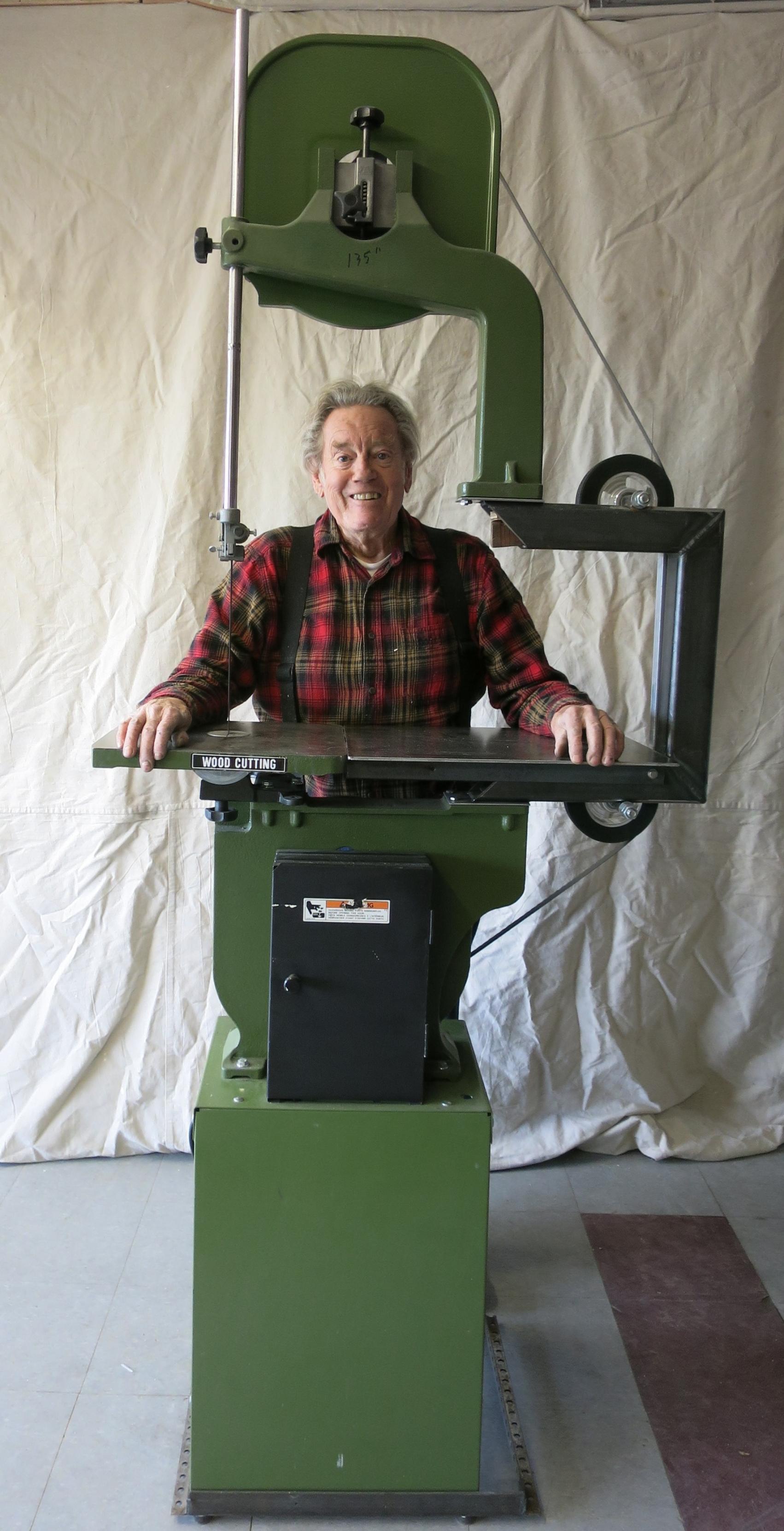

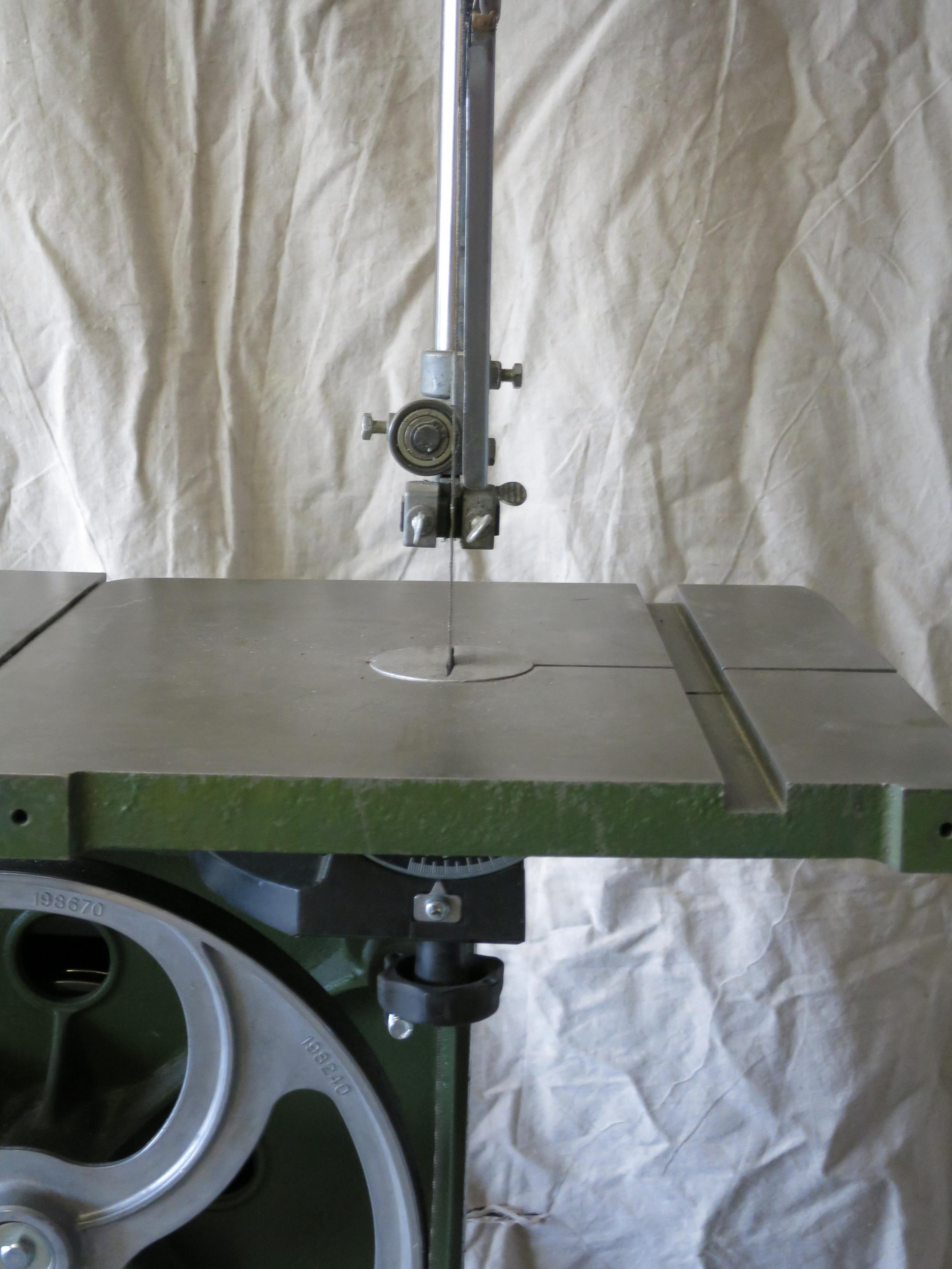

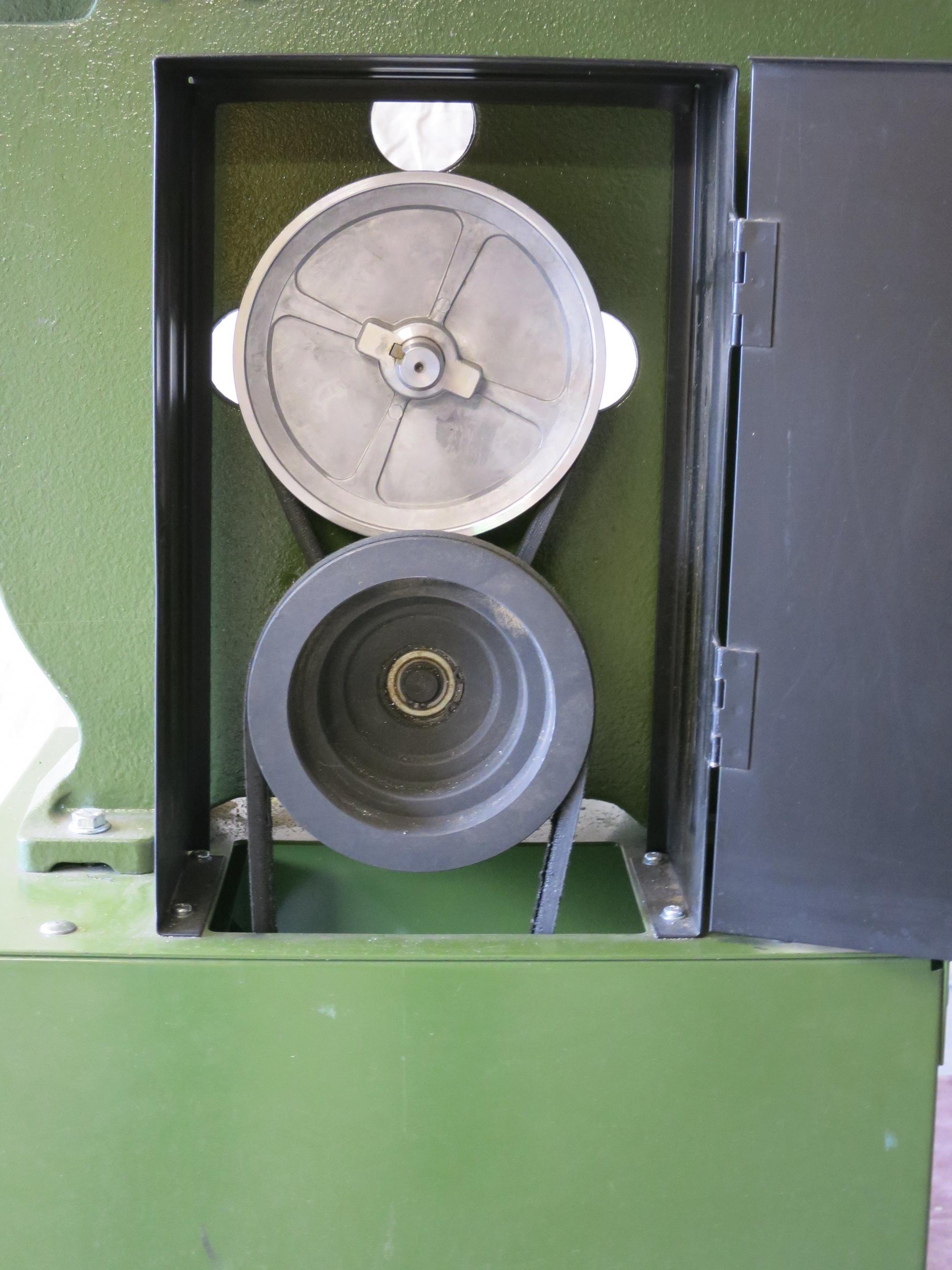

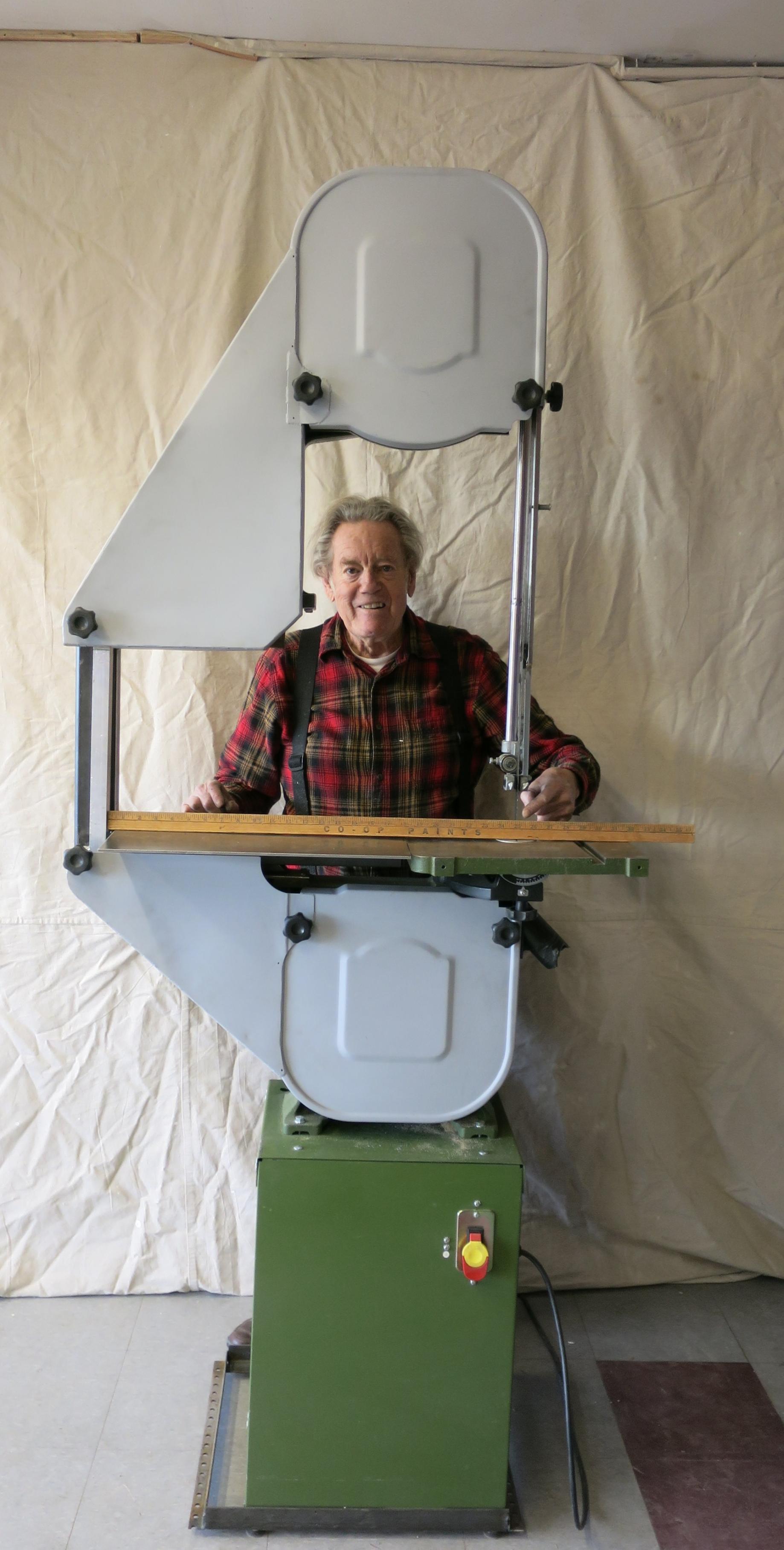

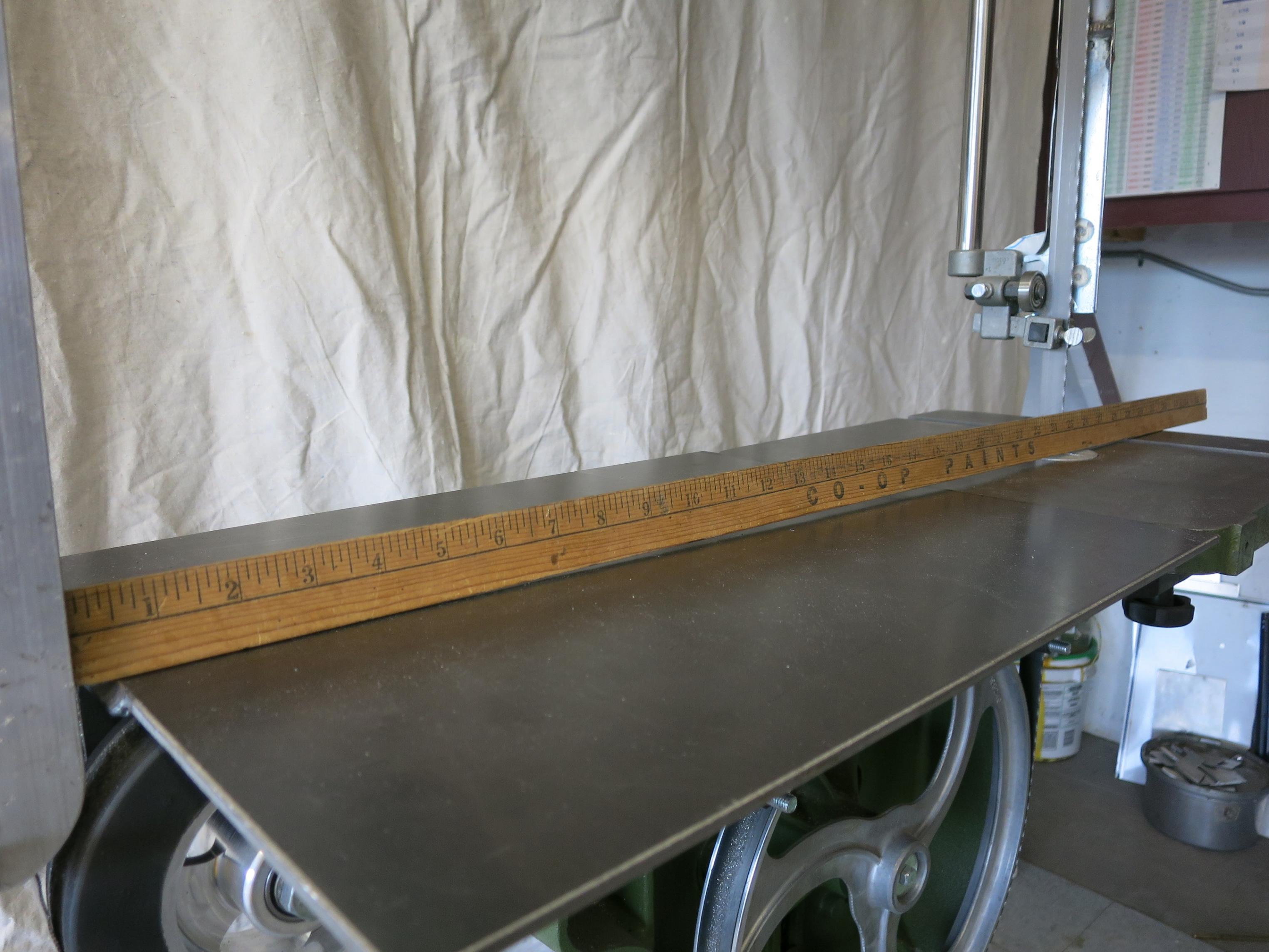

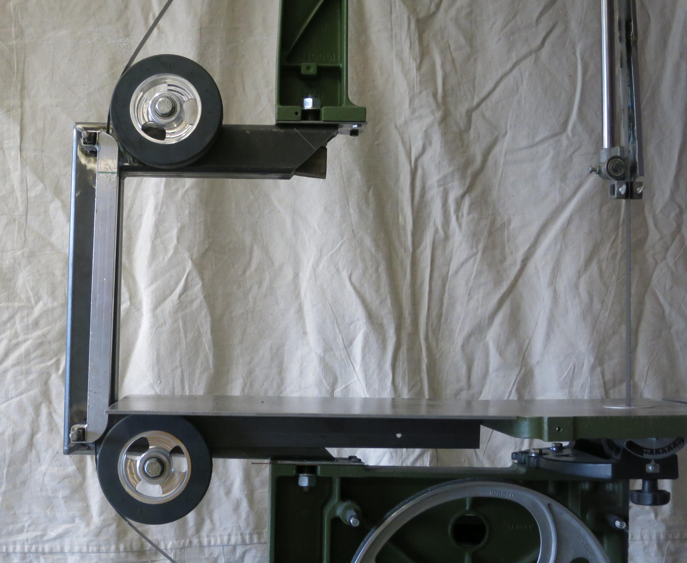

I've converted a 14 inch bandsaw to 28 inches, so that I can now cut a 4x8 in half, that is, rip it down the middle.
See the pictures and ask me any questions if you'd like.

That is very clever Ron. I like how you placed the rollers. Do you find any problems with vibration, alignment or flex? Also what are the back rollers or wheels from? You have added an impressive amount of width capacity.
Bob
Quite an achievement. Is this engineered ? -- you know blade tension,loading etc or seat of the pants or a combination and/or Uncle Harry dropped by a few times. Any info would be great.
What is the blade length and diameter of the small wheels? I'm trying to decide between your approach or Stumpy Nubs 3 wheeler or restoring a very old Chicago Machinery 27 in 2 wheeler all cast iron sitting in my shop.
