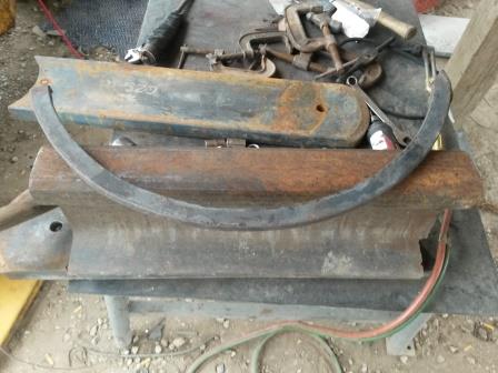

Here is what I came up with
Attachment 13171
I really do need to take the time someday to make a froge

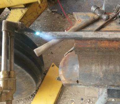

Attachment 13172

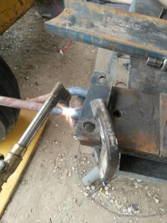

Attachment 13173
the bits fit together ready for welding

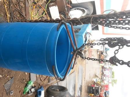

Attachment 13175
Works perfectly even on a drum with the head removed

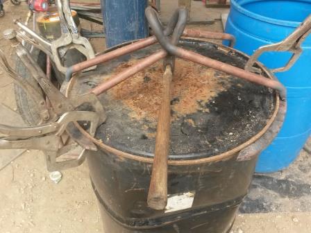

Attachment 13174
