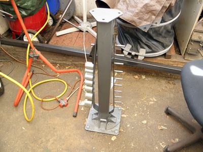

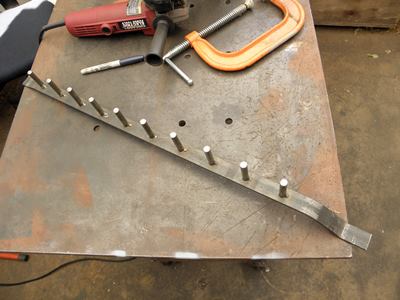

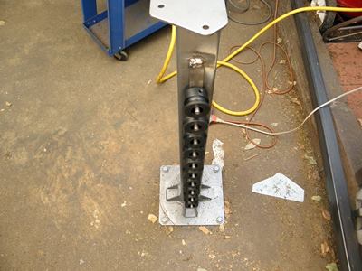

Bead Roller Die Holder. This is a HF Bar Bender stand that I use for other machines including a bead roller and English wheel. The holder is made from 1 inch strapping with 3/8 x 2 inch inch rod.

Well thought capainleeward. Looks really nice with the dies. Saves you the trouble of rummaging through the die storage boxes.
