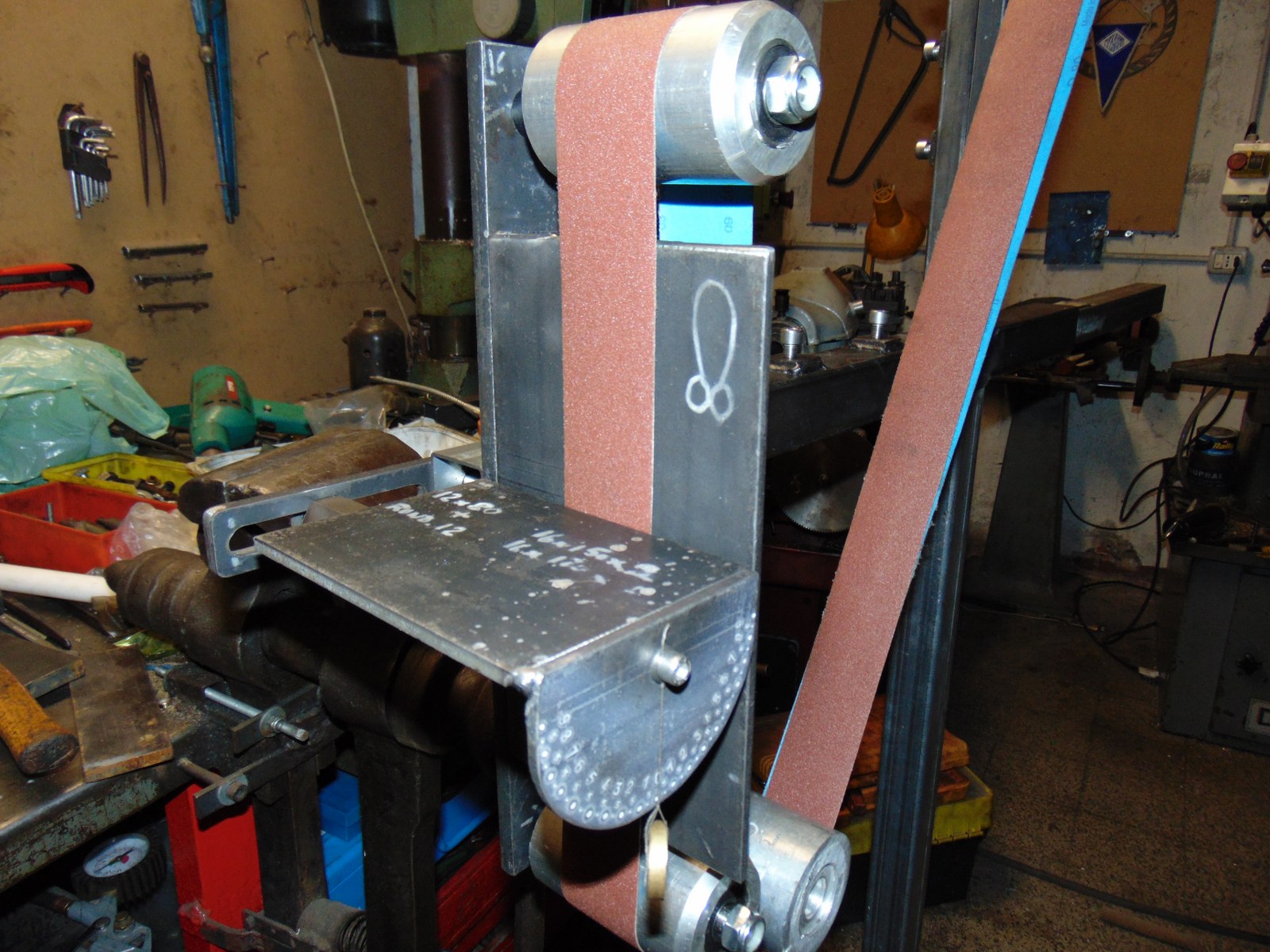

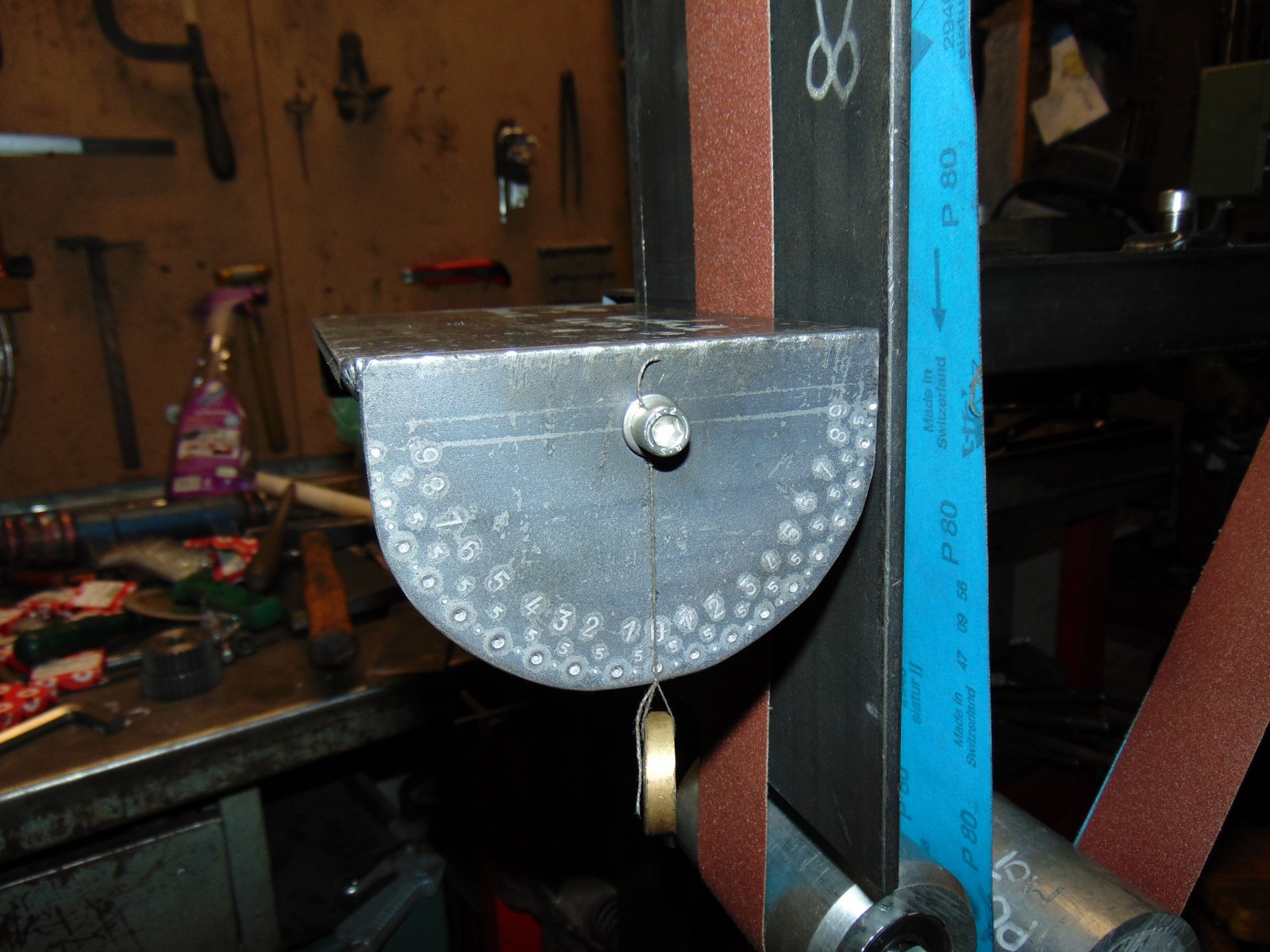

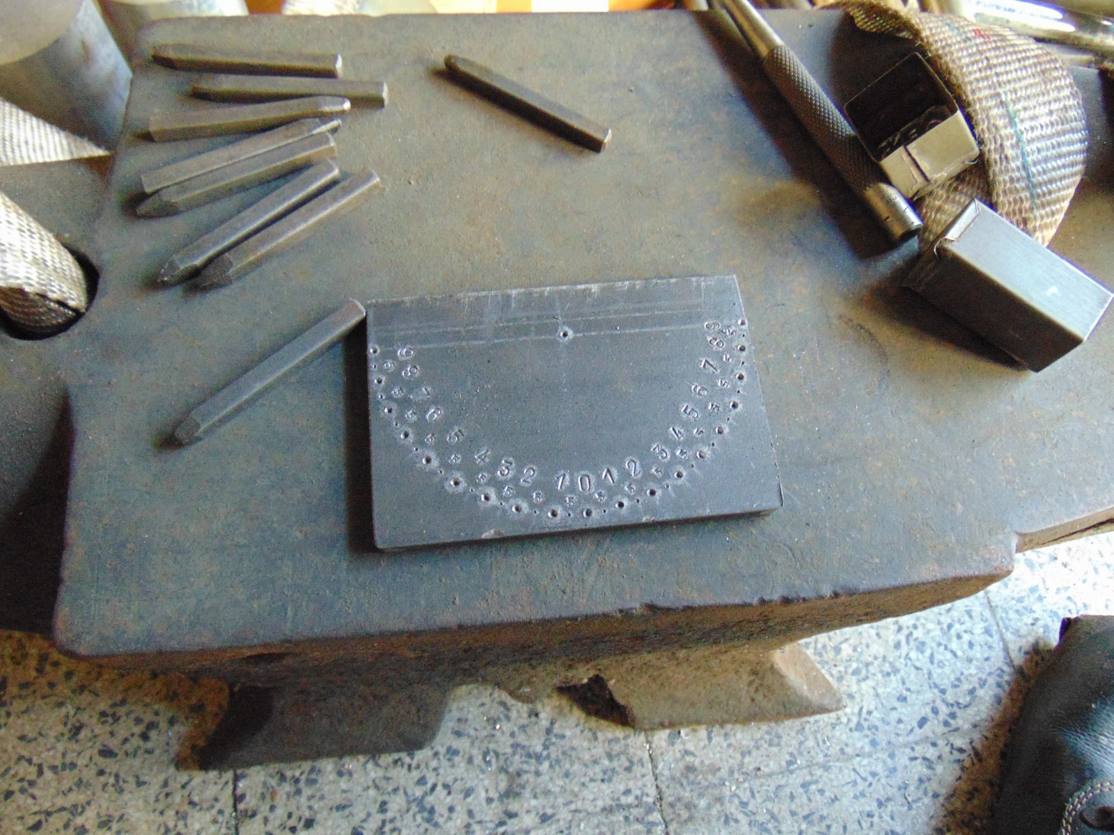

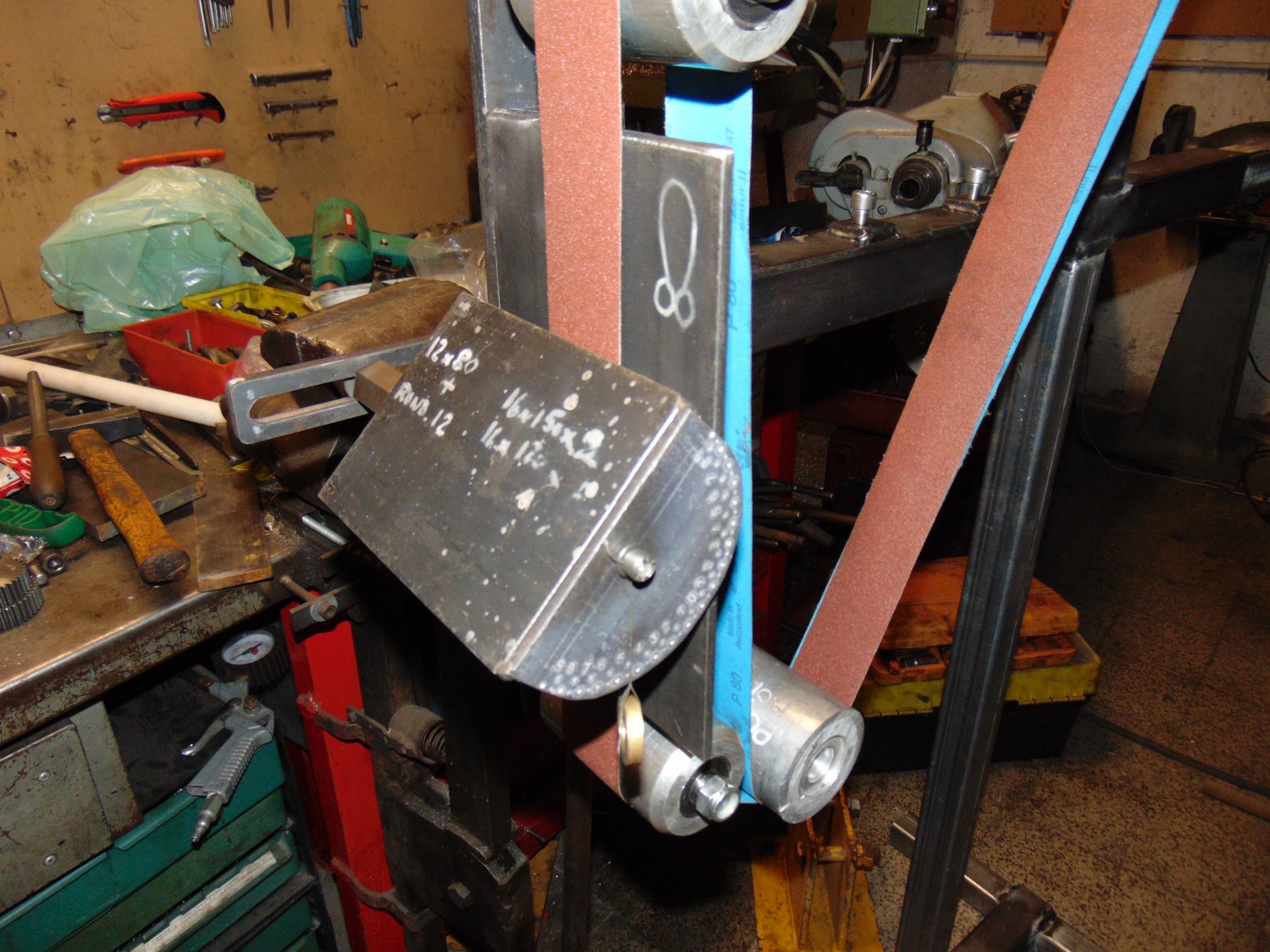

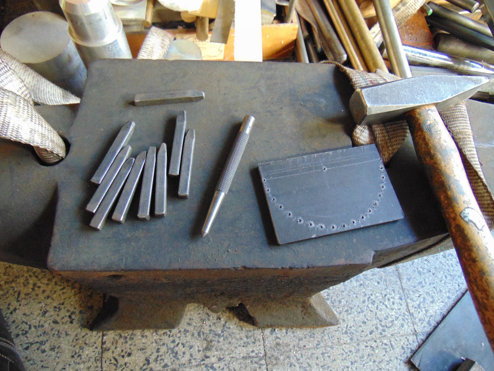

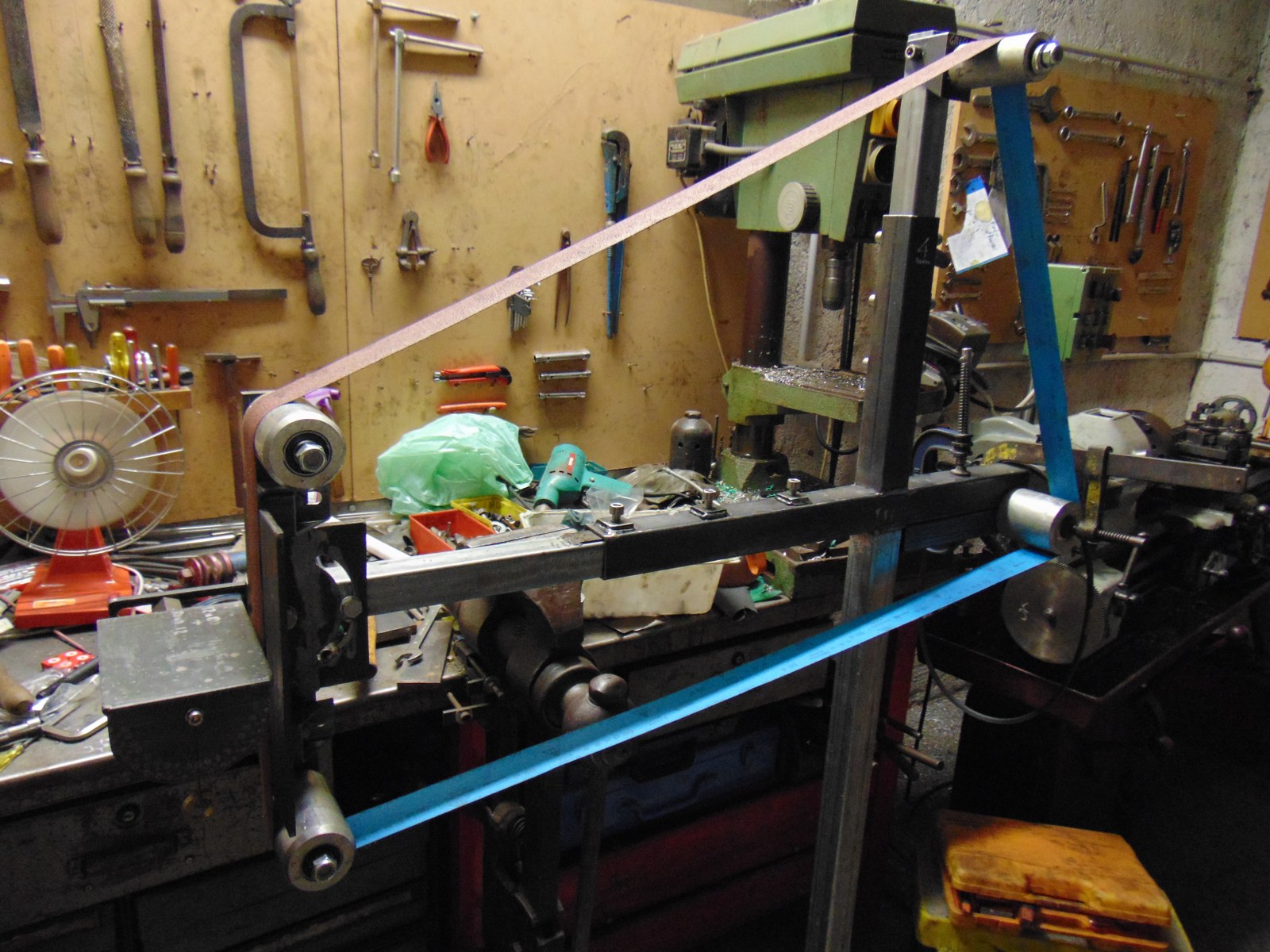

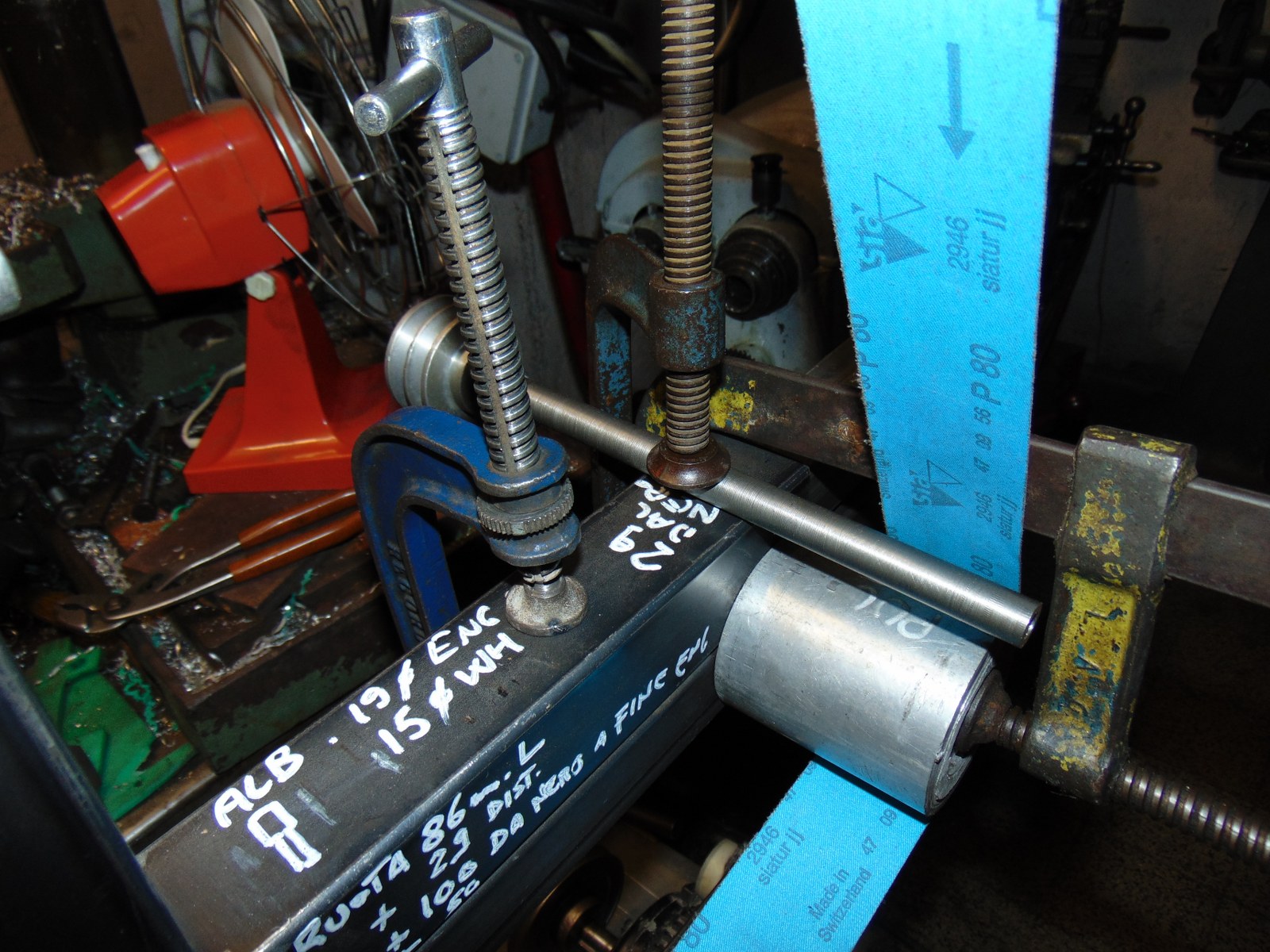

I built a kind of protractor from steel, I thinked different ways to solve the problem, but at the end I think that's the easiest. Wire in picture is only demo, I will make something more valid.

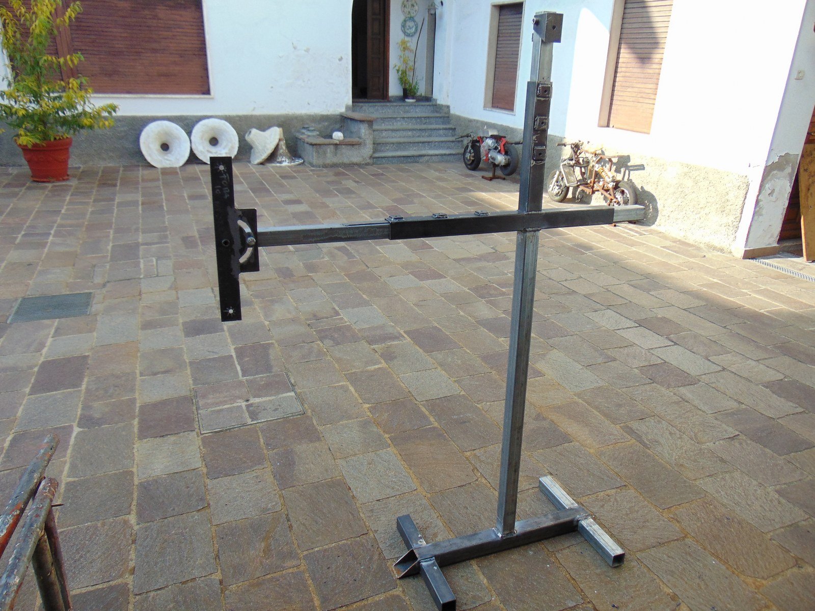

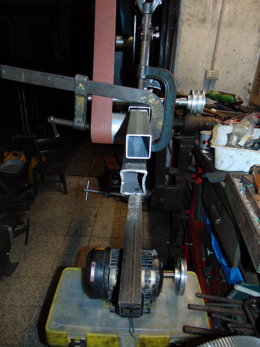

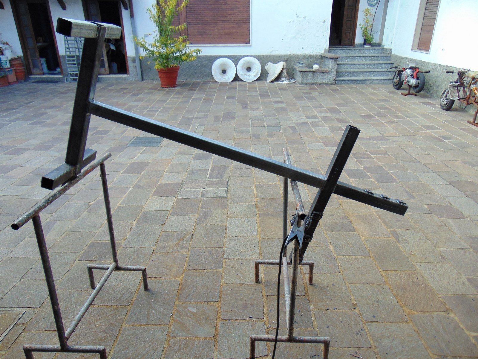

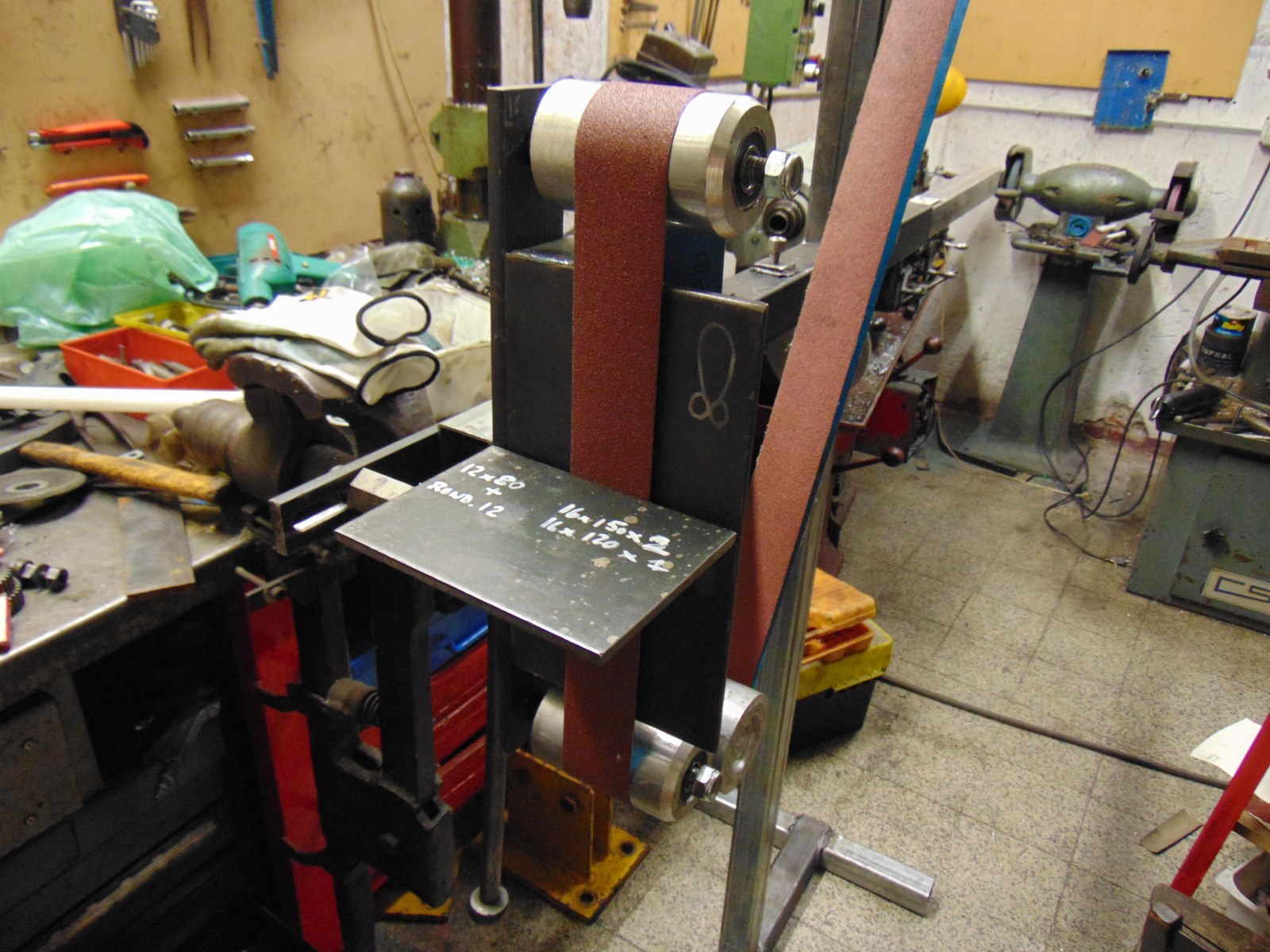

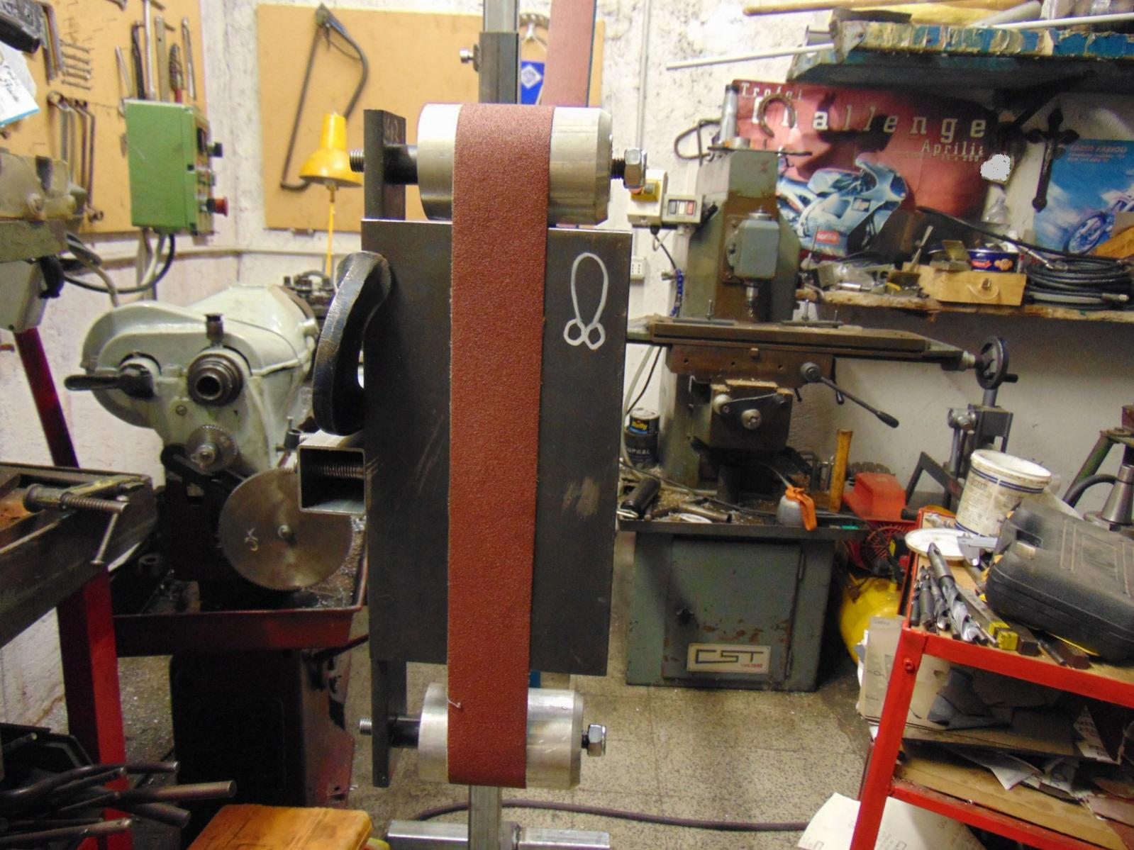

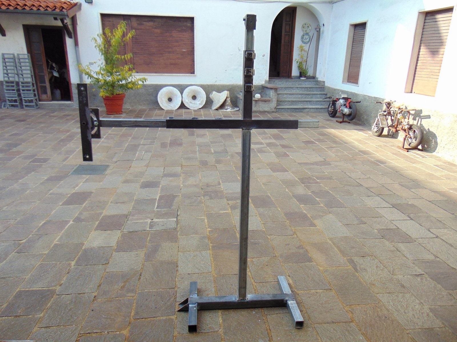

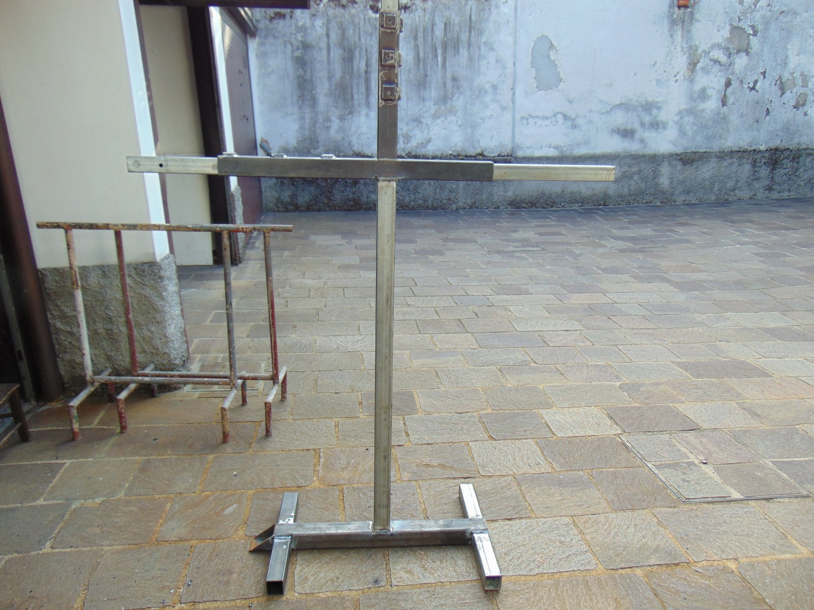

It's time to take measures for last wheel shaft, and decide motor alignment.

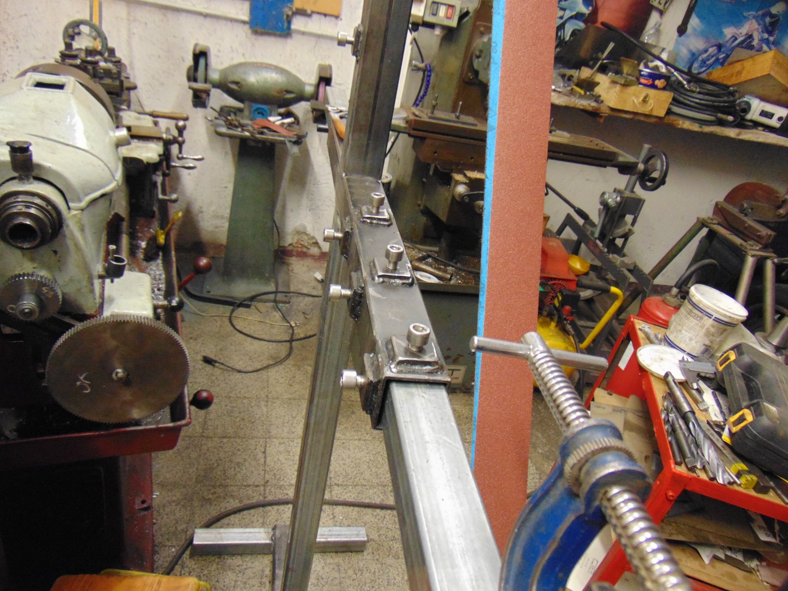

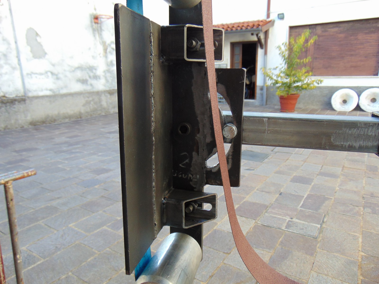

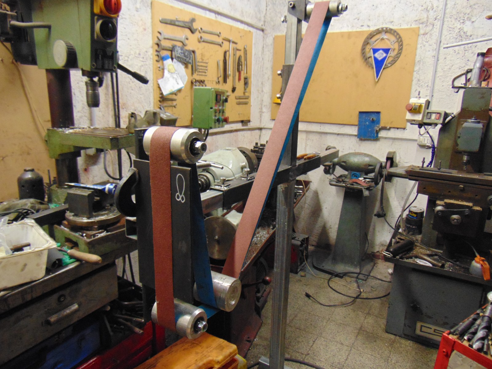

In last picture there is the longest belt 3m ( 118" ), I got also some shorter 1,8m, I think the outreach of arms is good, I hope to not have problems with vibrations, for this reason I put 12x m10 lock on both vertical and horizontal sheath.
Ps: this anvil is really beautiful! Hammering punches has never felt so good, Pieces motionless and sound attenuated, I'm happy

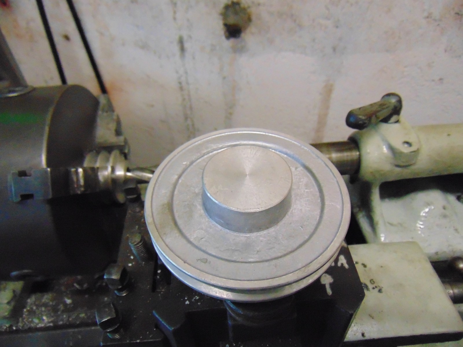

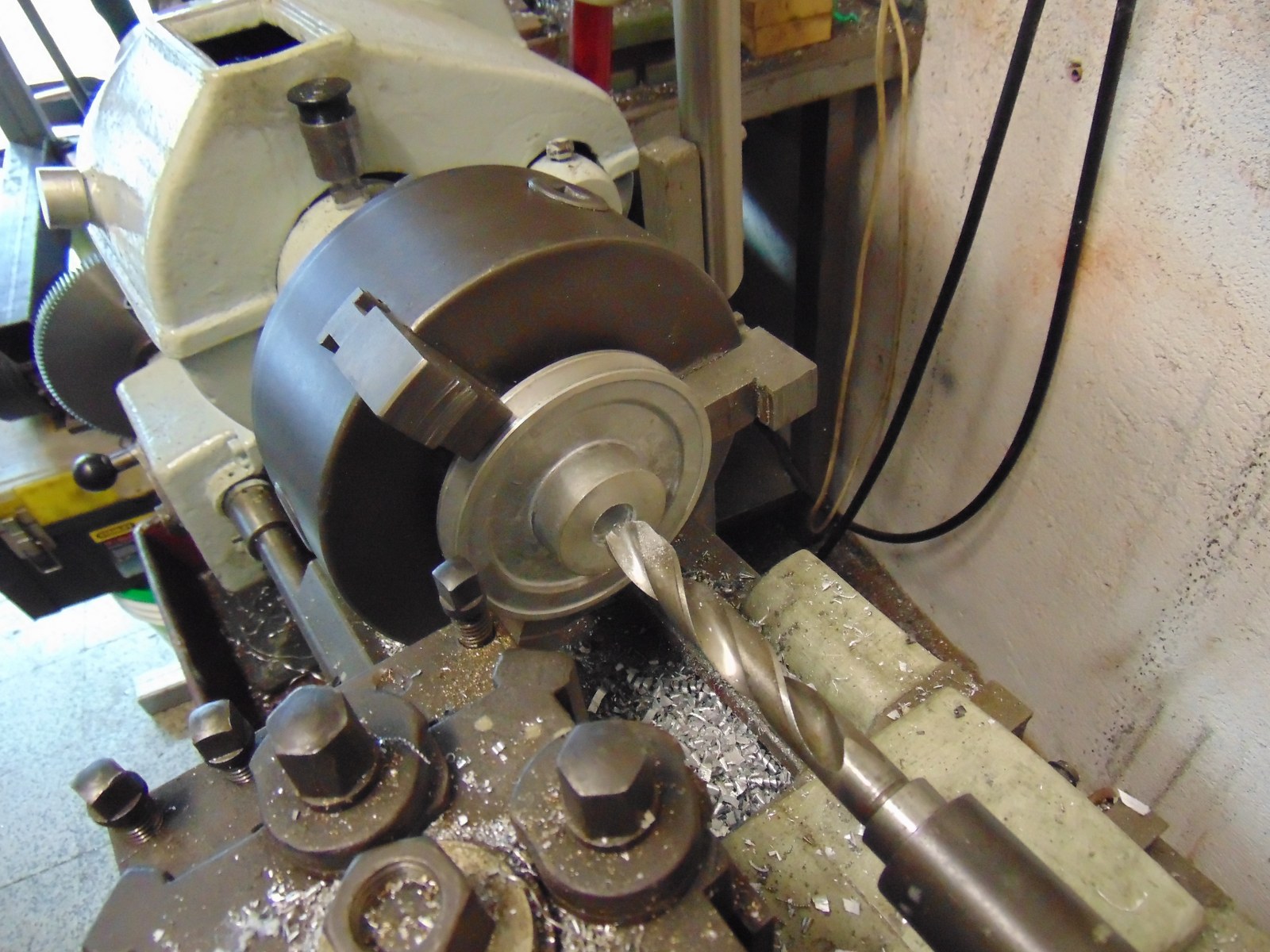

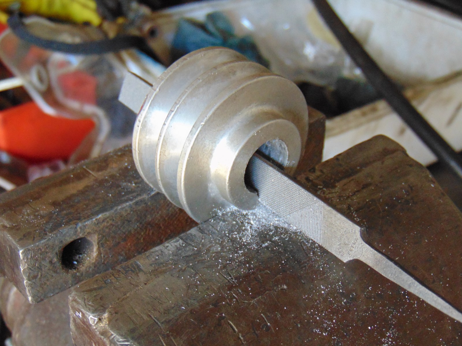

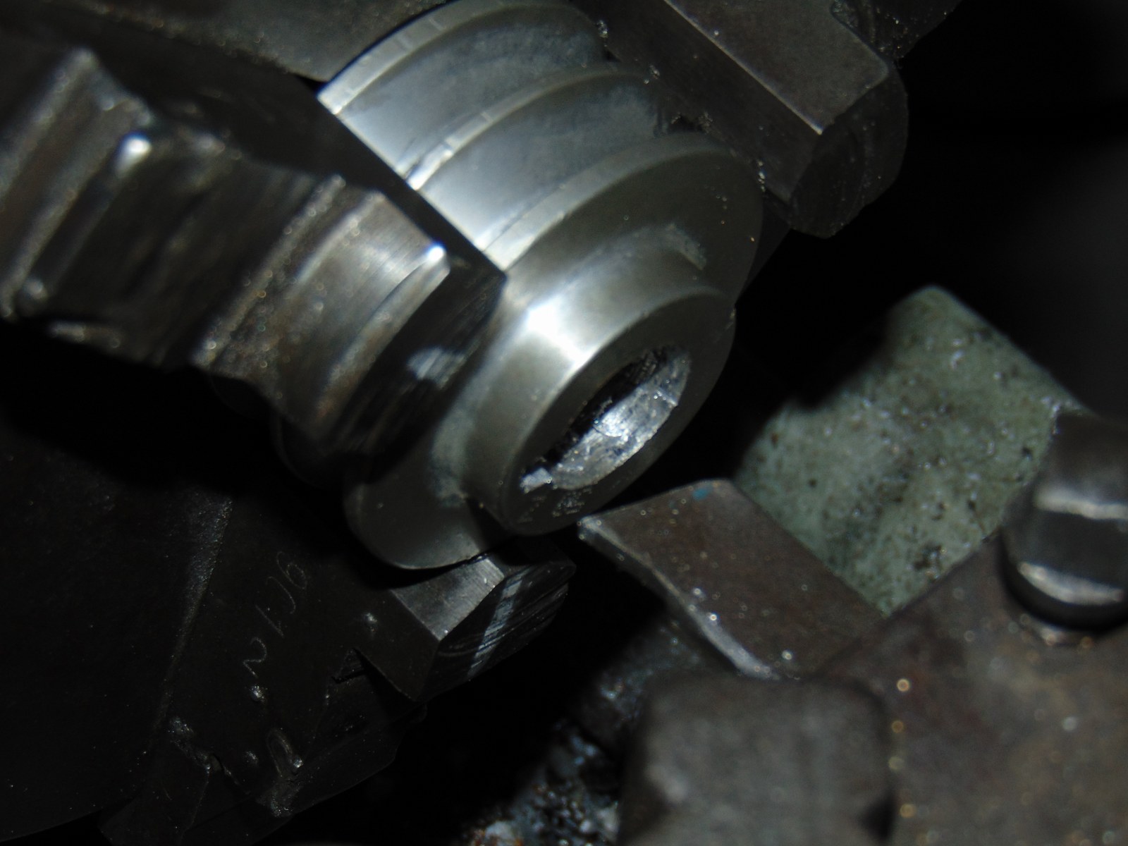

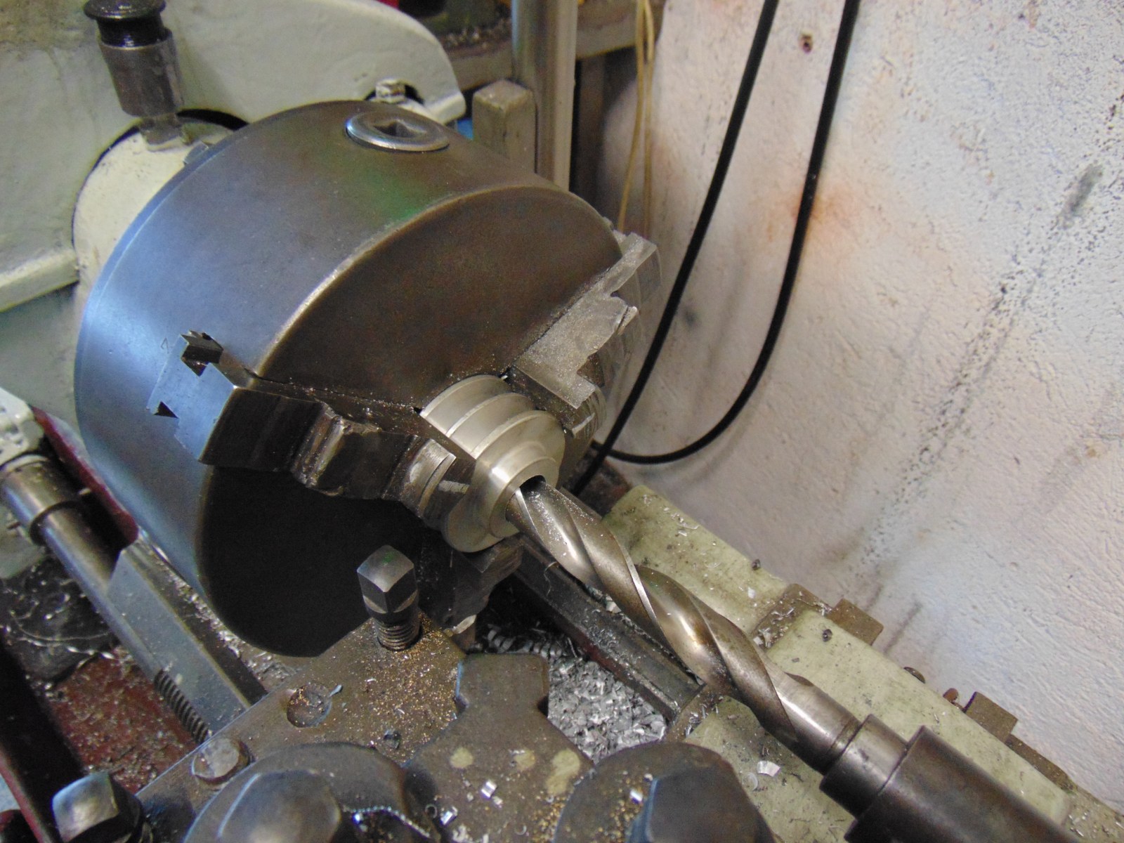

a good work maybe needs a couple of keyways, I can easily do with mill on the rod, but i got troubles doing them on internal of pulleys... Should I try with lathe and a parting tool? or maybe with 4\5 blades stick togheter? or maybe with a couple of grains ( I think the worst job possibile )
In august shops are closed, it's difficult to find things, but here I not lack of imagination
the way I make a lot of my internal key-ways is to run a small end-mill through the bore roughly removing most of the metal then chuck the part in my lathe and lock the spindle with the precut key way exactly on the horizontal center-line then grind a piece of HSS the size of the key mount it in the tool holder with half above and below center then I hand cut the finished key way using the carriage travel making very small cuts until I reach my desired depth of cut. you can do this without using the end mill first but requires more material to be removed by hand
Thanks FrankS!
I tried, not the best work ever done, but at least it works
I used 3mm hss for cutting 19mm bore. Now I'm thinking about the last wheel, bore is 15mm, the exact height of the tool, i got no insert or hss so tiny to be used.
I'm thinking of drilling the wheel+shaft and put 6 grains, or maybe i should use file till Tomorrow, trouble is that wheel is 85mm long, maybe a 30mm key can be enough

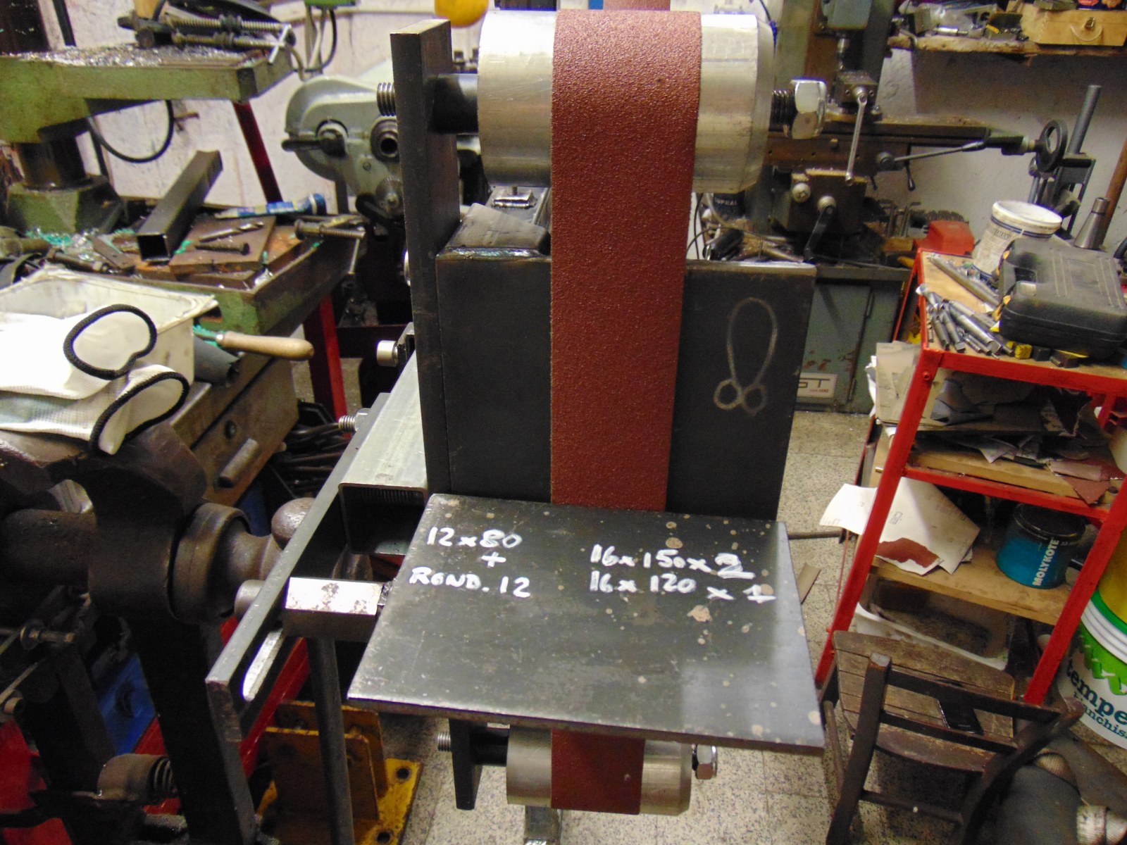

Very nice tool!!
Thank you and thank to Frederic that passed me a useful link to a similar tool
Question for you, it's ok about shape and operation, but what kind of insert can be used? I'm surfing aliexpress page for indexing tools and parts but there are really many type, they have a specific name?
