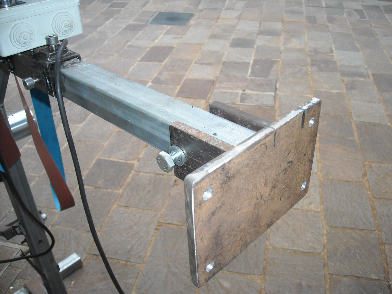

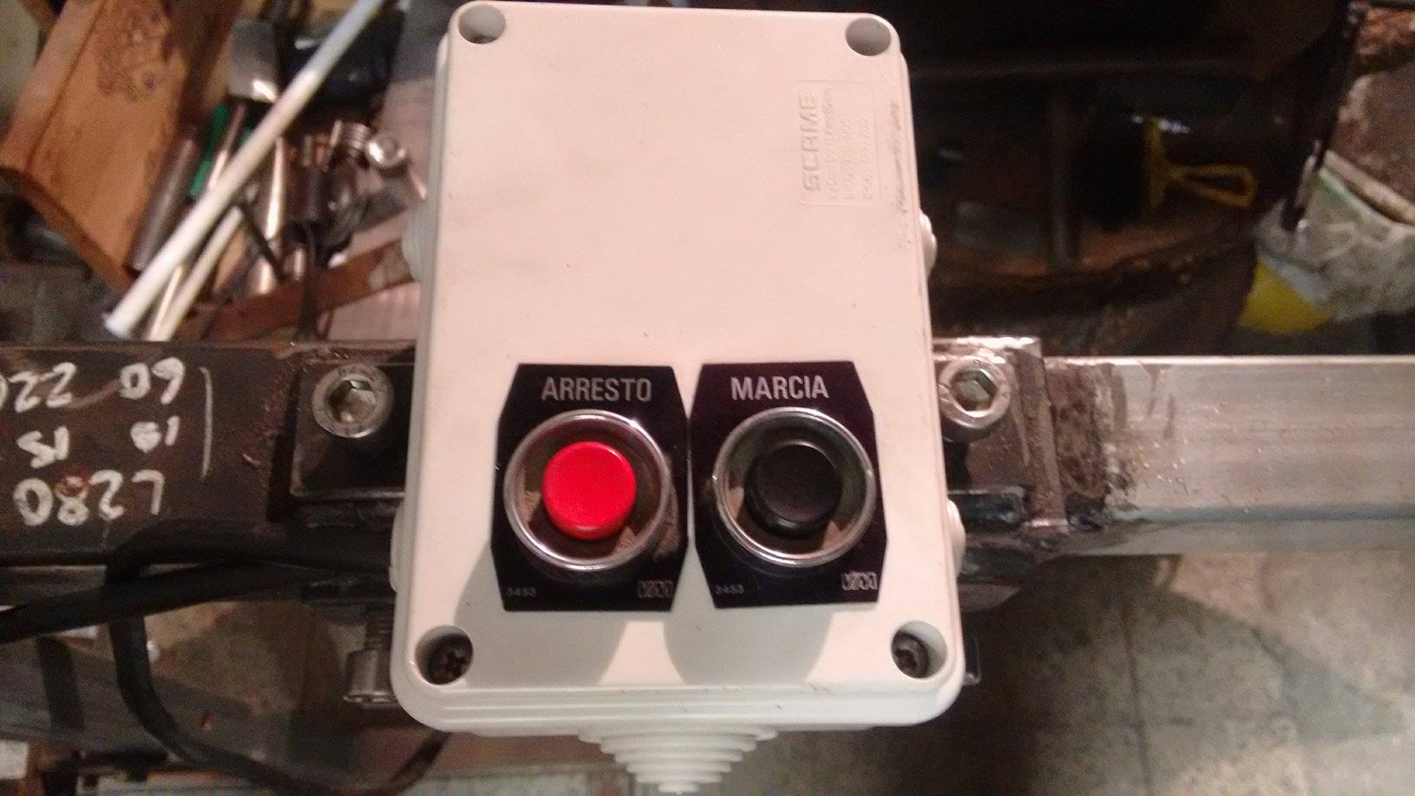

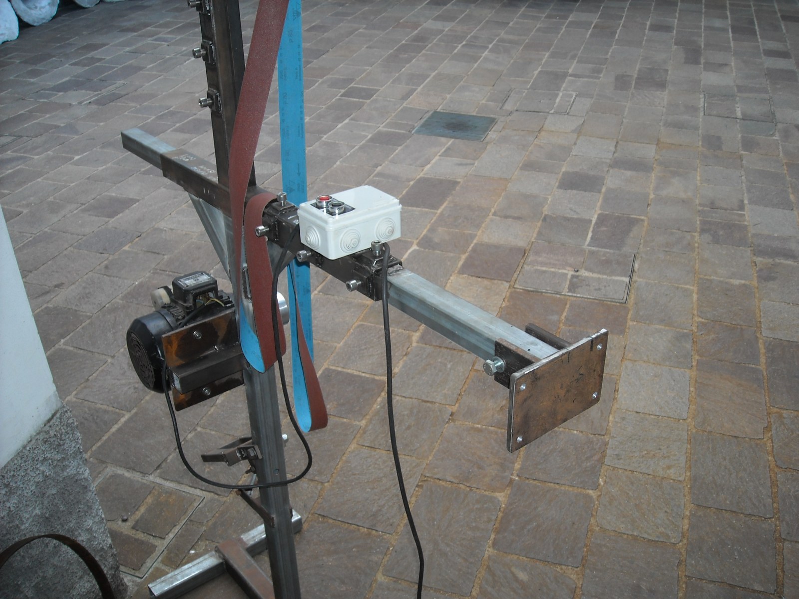

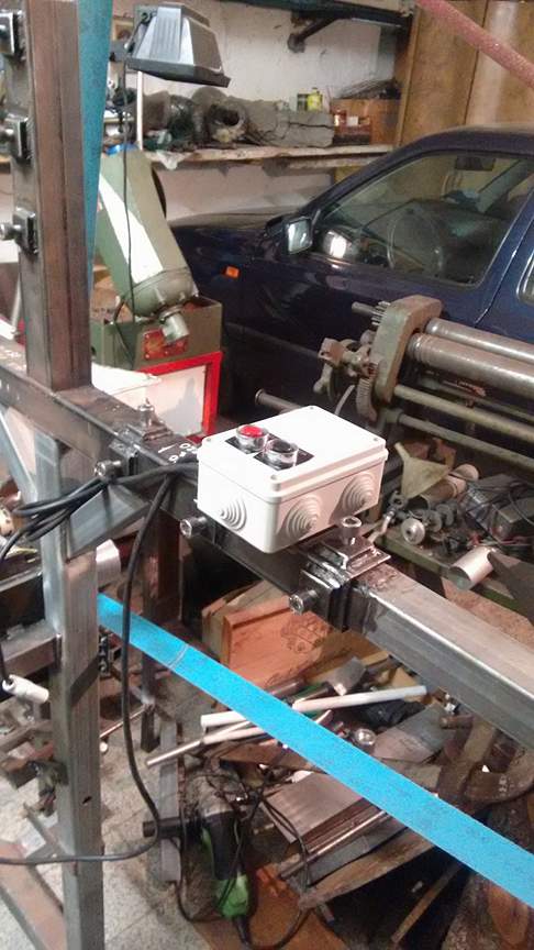

    I used a contactor with open and closed button, rated up to 4kw. I didn't think to put a safety mushroom, the buttons are close to working position.
    I want to make the buffing- polishing shaft, and maybe a rear rest with the size of the belt, in order to use the edge

    You can supplant a e-stop mushroom with a hinged paddle. Make large as you care to. I like them, to elbow the stop switch when both hands are manipulating a wide part.

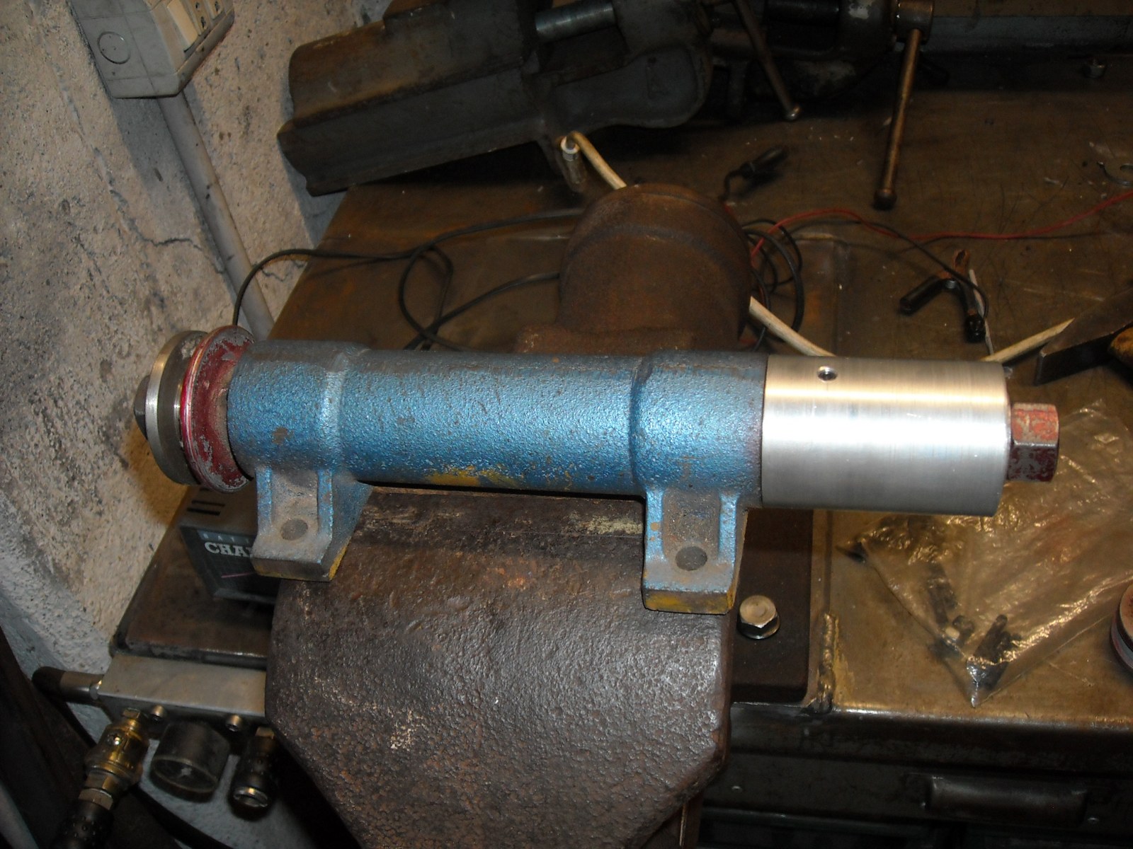

    Thanks for the advice!
    I'm modifying a part maybe intended for the same purpose, the original used a pulley for trapezoidal belt. I made with lathe only a wheel for the belt, kept in position with a grain, as the original place. Next thing to do a small frame, fast to detach for the long shaft already mounted on the sander.
    The shaft is good for 15 and 20mm cotton wheel, or other attachments

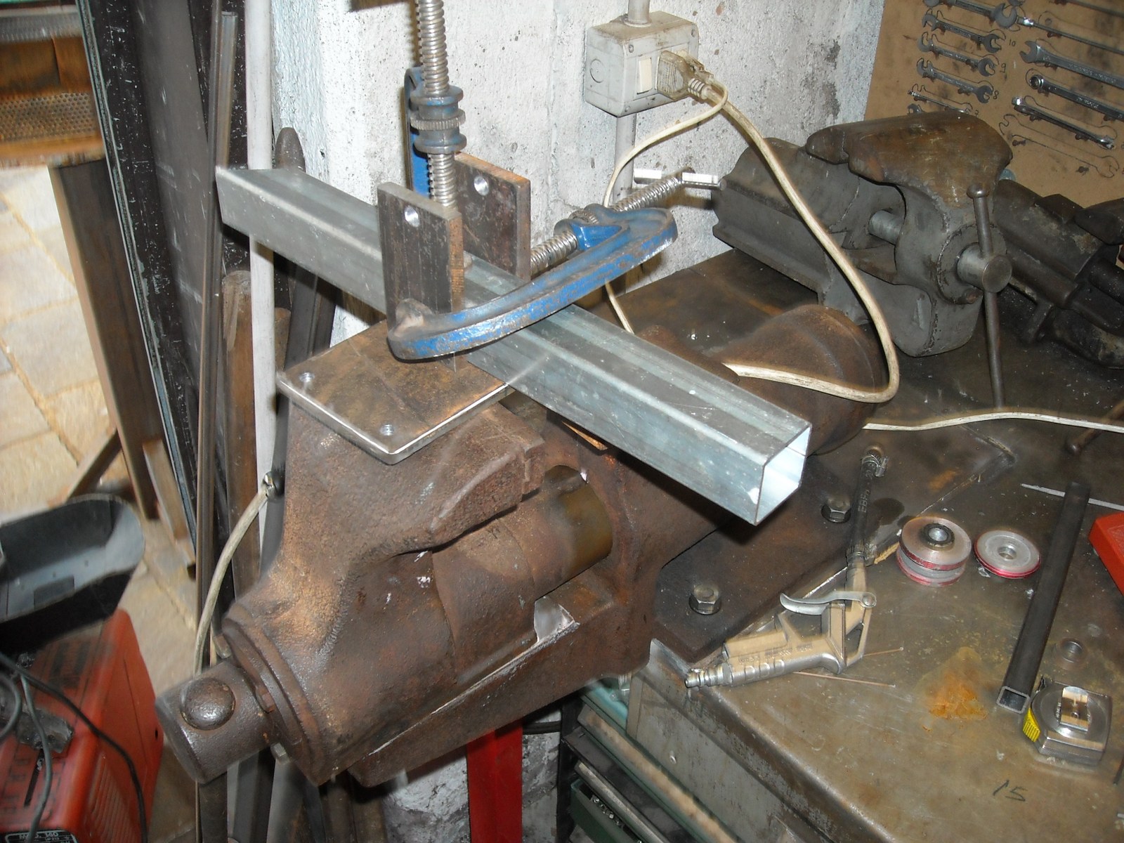

    Small frame for polishing, recycled parts
