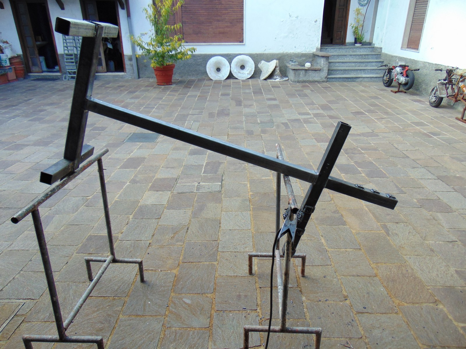

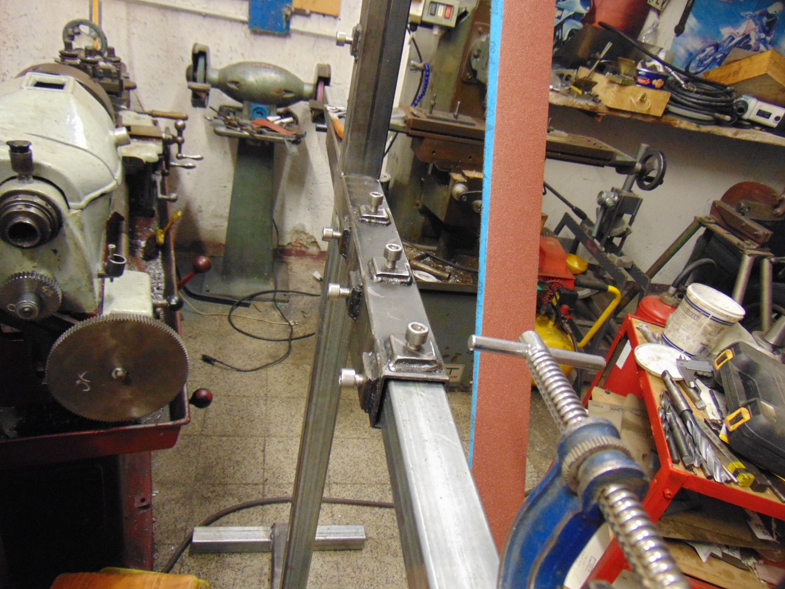

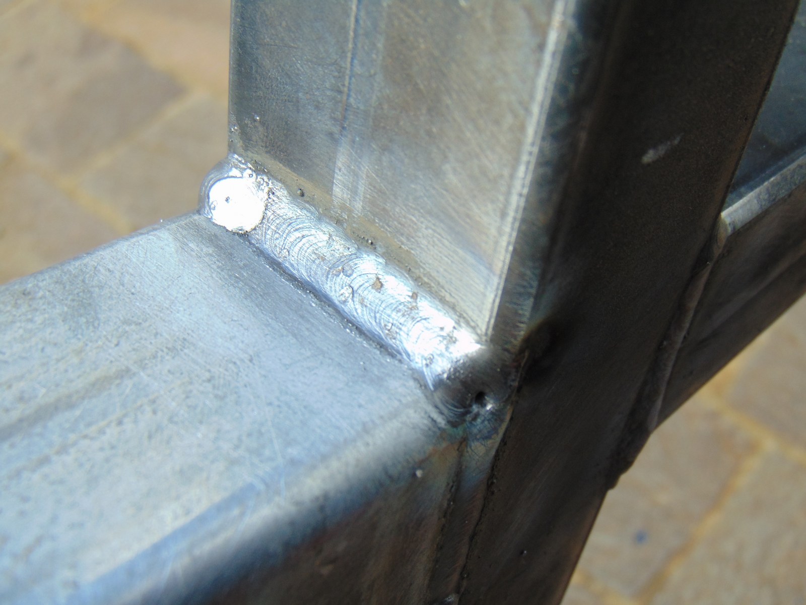

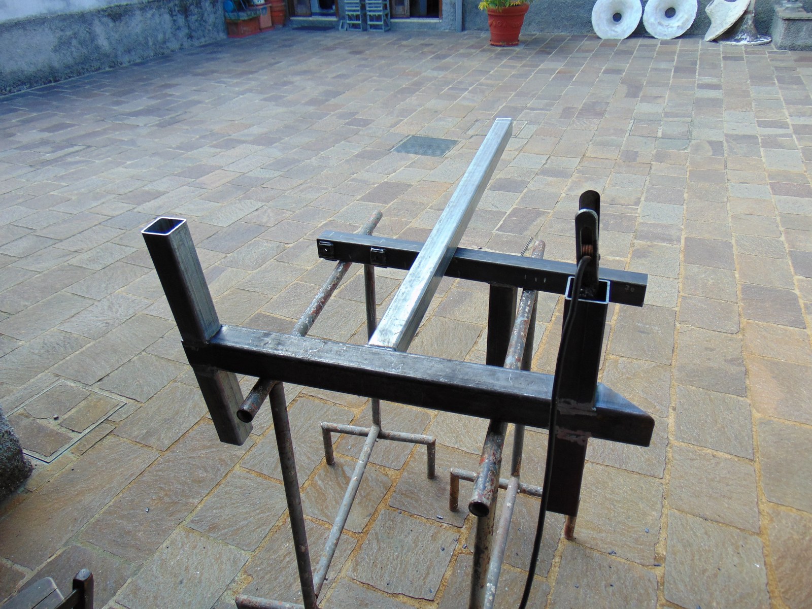

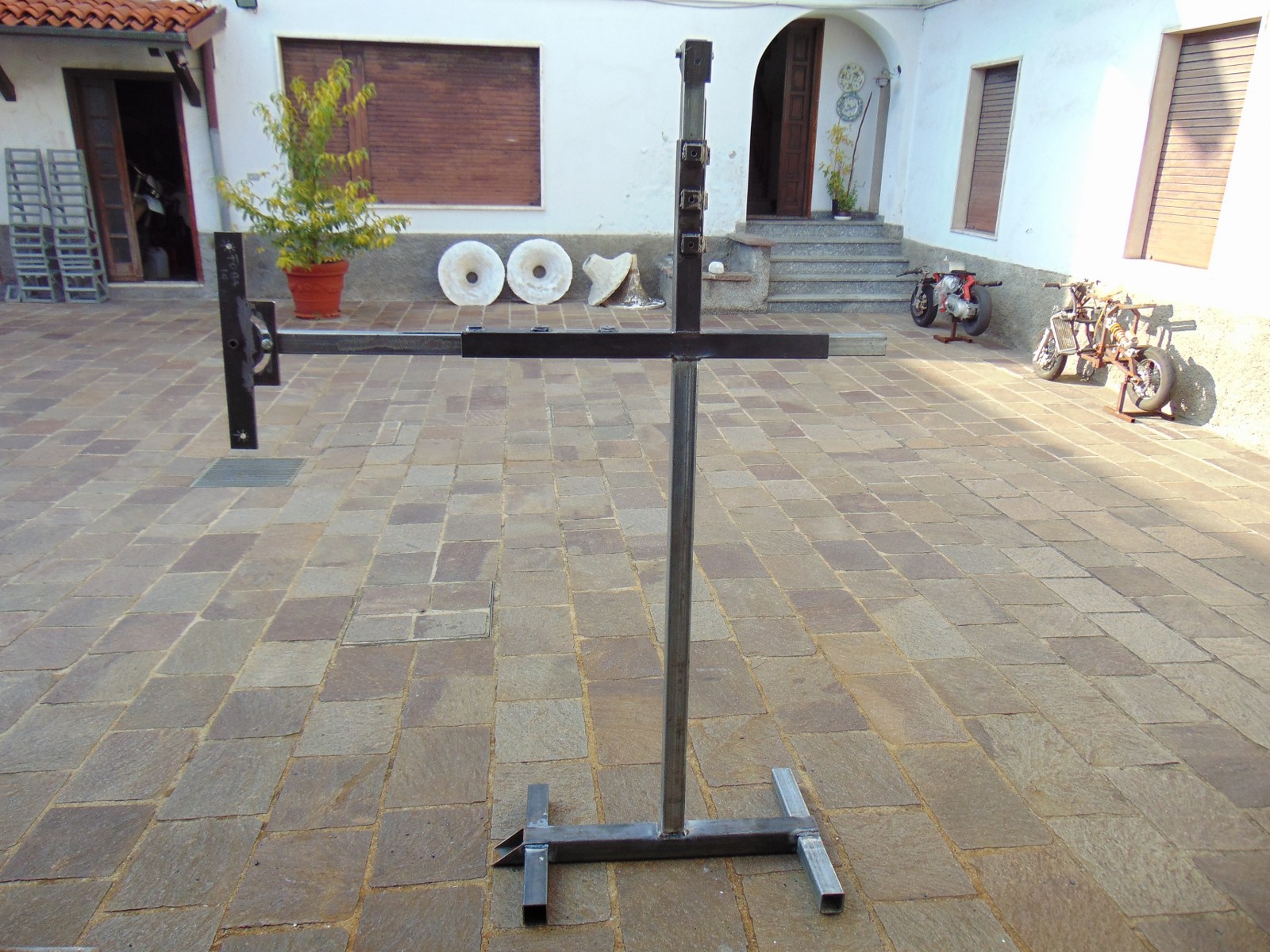

I started welding frame, maybe I need some 45° reiforcements, structure is also stable.

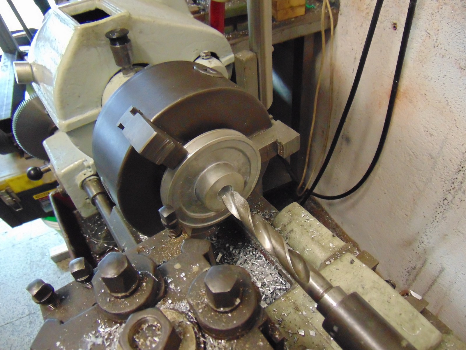

Next thing to do. alu wheels and shafts

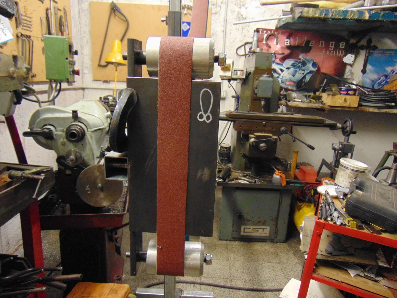

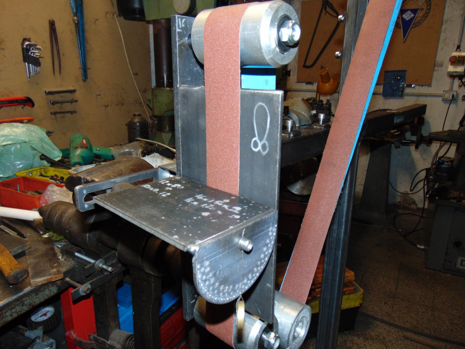

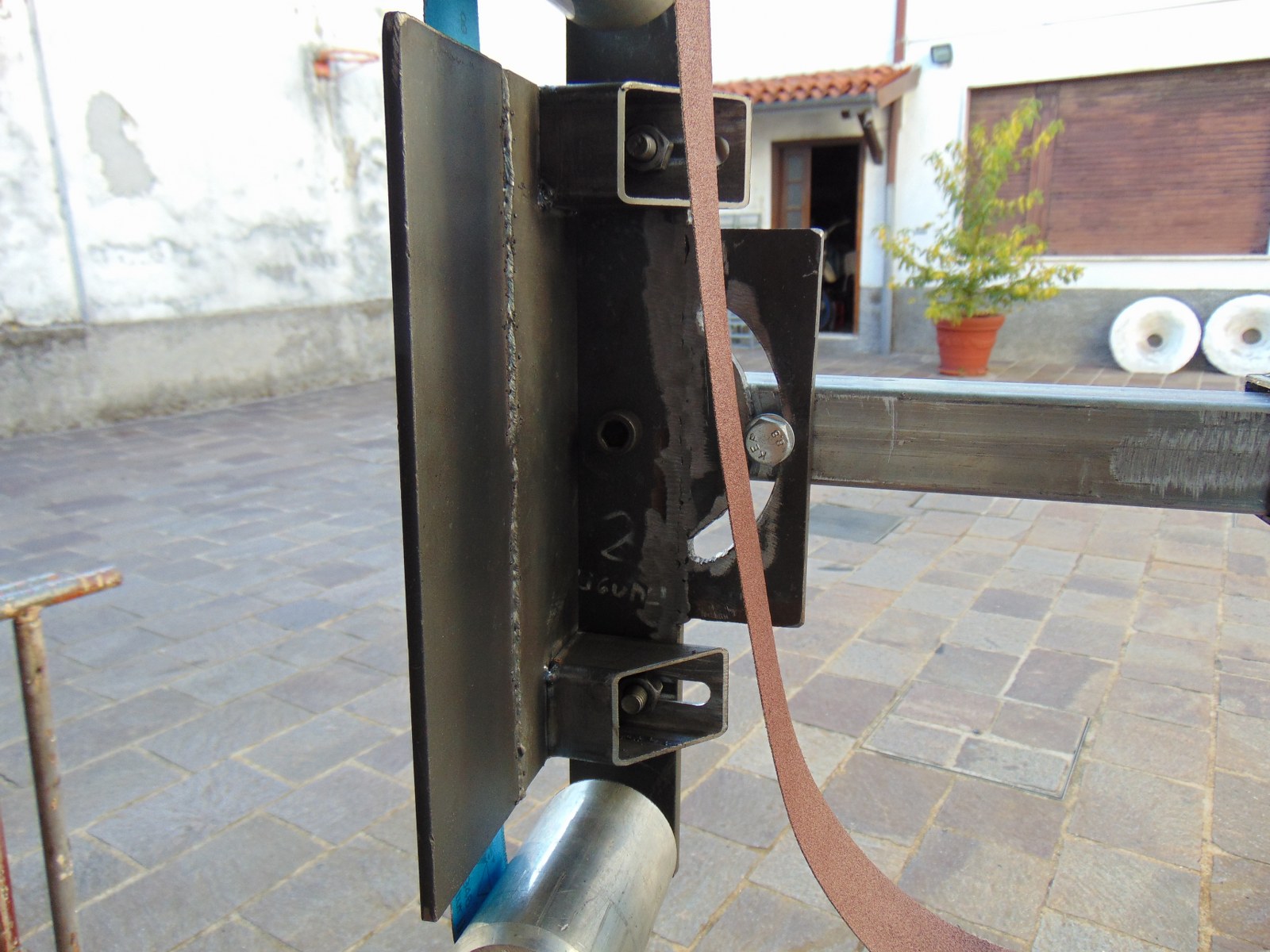

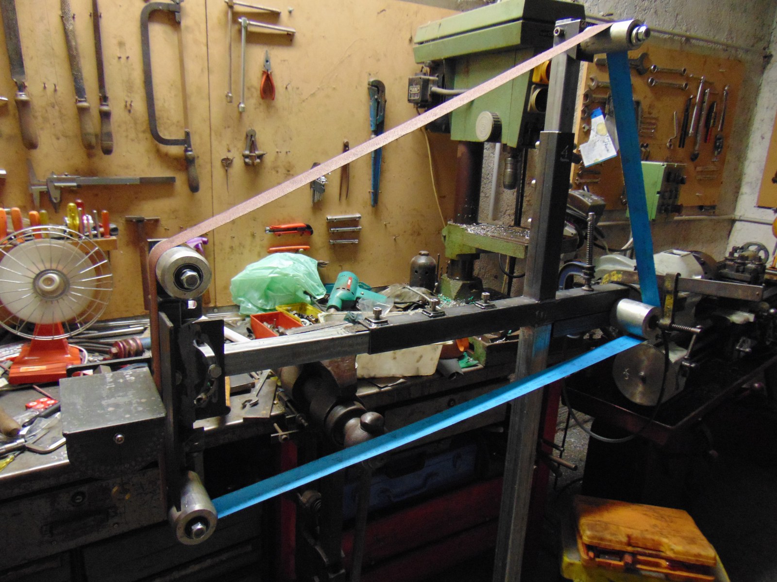

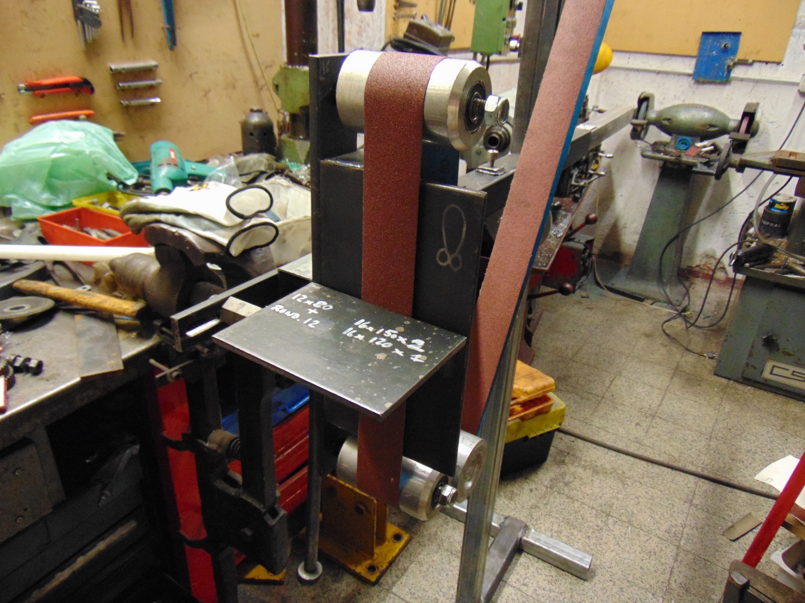

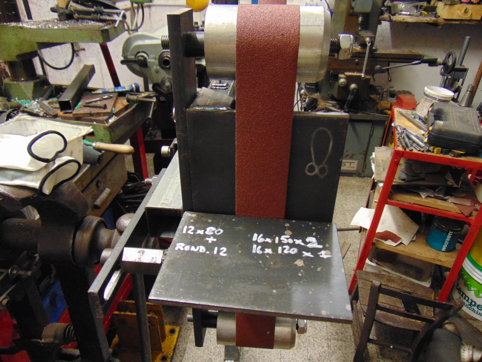

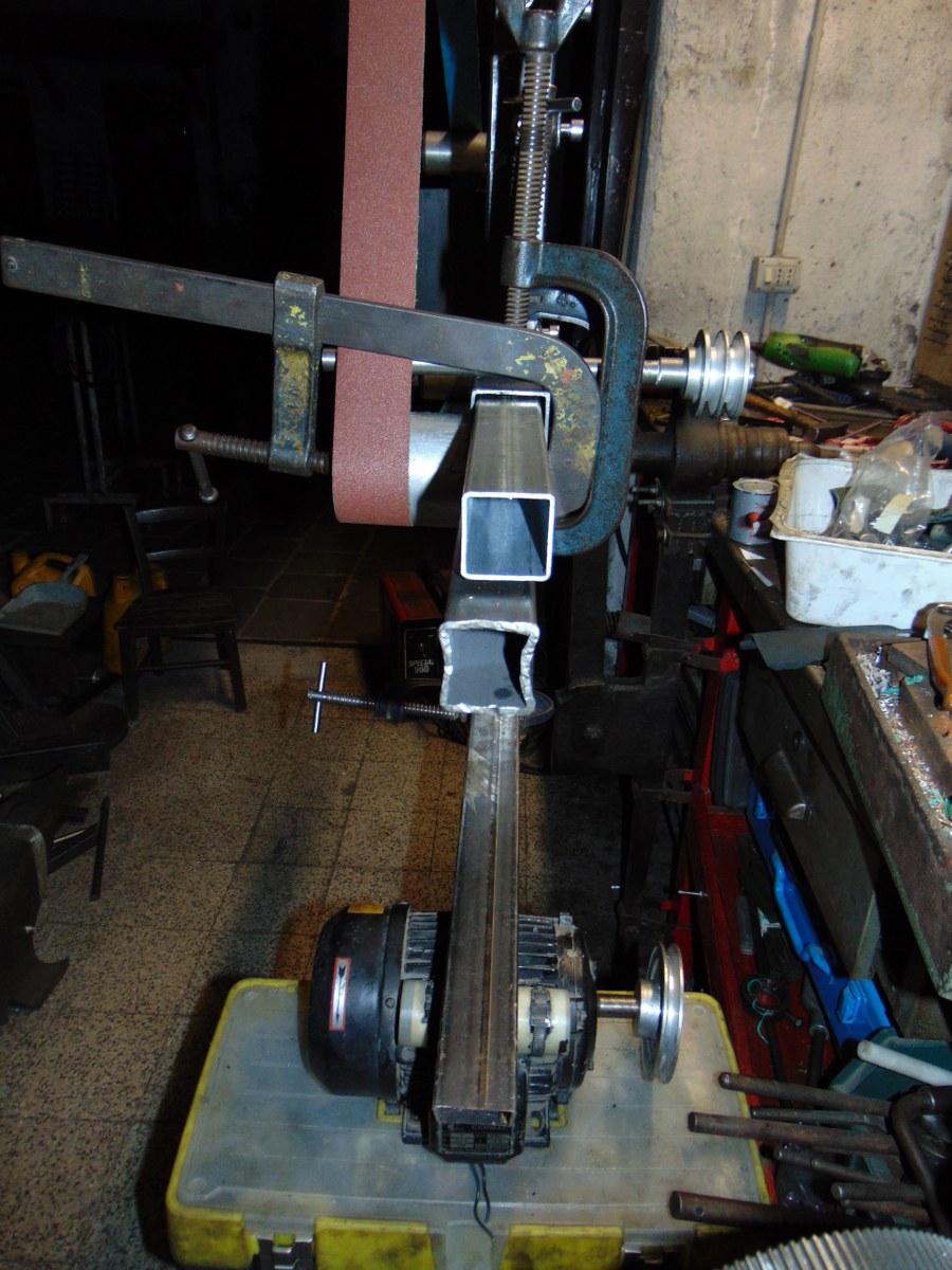

Hi!
Slowy but I am continuing the work on grinder.
Next thing to do: front rest, last rear wheel + pulley and a stand for engine. I Have to finish the alu wheel, they are just mounted for taking pic

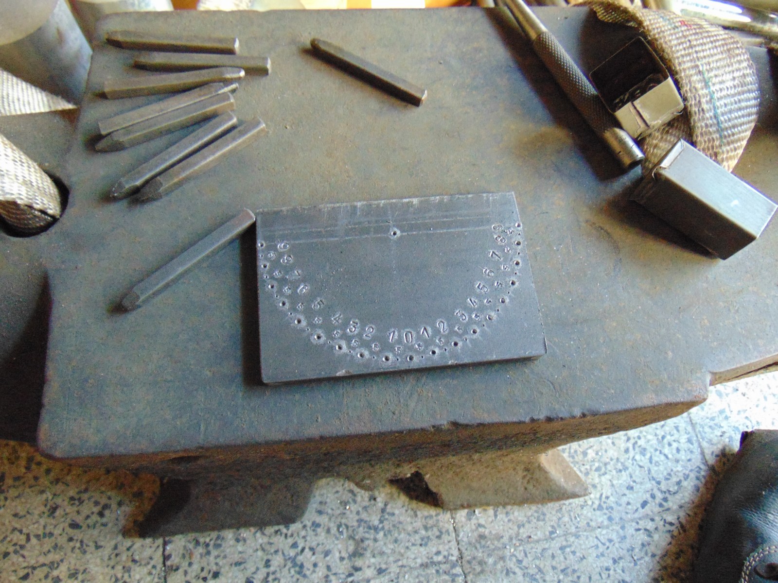

occult simbols are reminiscent of the cult of Priapus :lol:
Attachment 12897 Attachment 12898
Attachment 12899 Attachment 12900

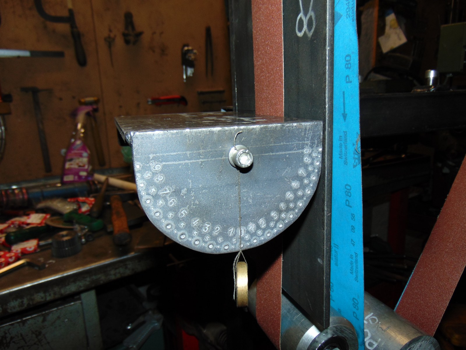

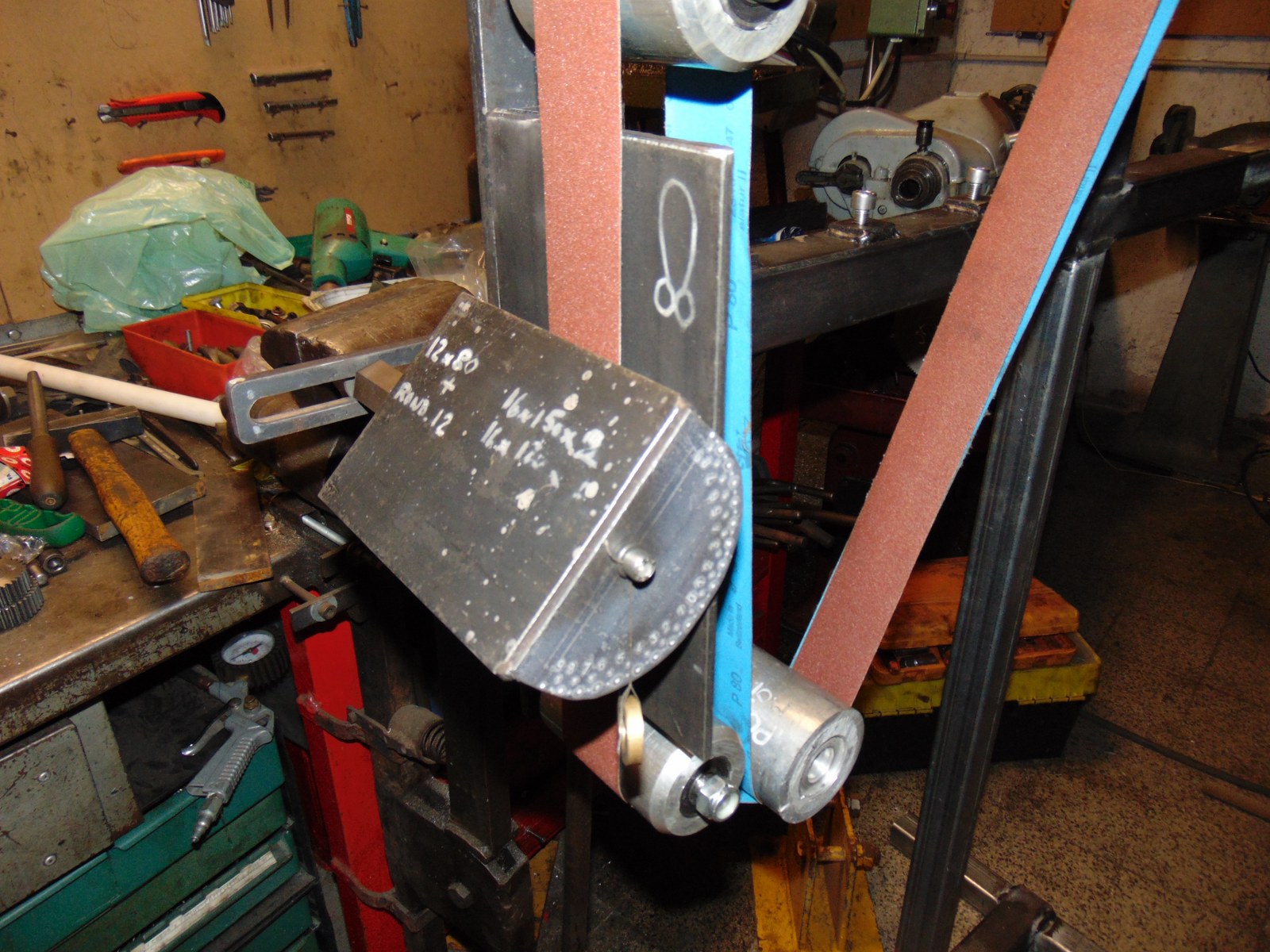

I'm thinking about adding a protractor to the support, just to set the right angle with no external tools.
Next thing to do is the ensemble large engine wheel + pulley and motor brackets, maybe the worst part to do... I got no flanged bearings, only normal type, I have to build a nice frame
Attachment 12921 Attachment 12922
Attachment 12923 Attachment 12924
Attachment 12925

It's going to be killer. If the worry about flanged bearings I bet you can duplicate what they do. If its end play [thrust] a spring and bearing ball [ball only] with a set screw could control it. Flanged, could be housed, or maybe auto front spindle bearings, [very common to rear wheel drive cars] drive taper is built in, use same on both sides, shaft shouldered one side, nut and cotter pin other end. They are inexpensive here. Lots of motorcycles use them too, even in swing arms. Hope the terms are universal enough that you can ID them. You might look at RockAuto for photo leads. Try 1965 Chevrolet Chevelle, they were drum brakes, RWD and occasional chick magnet.

Thanks for advice!

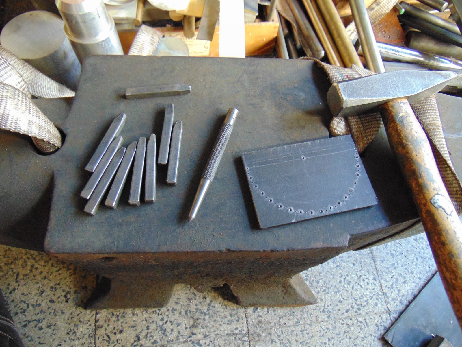

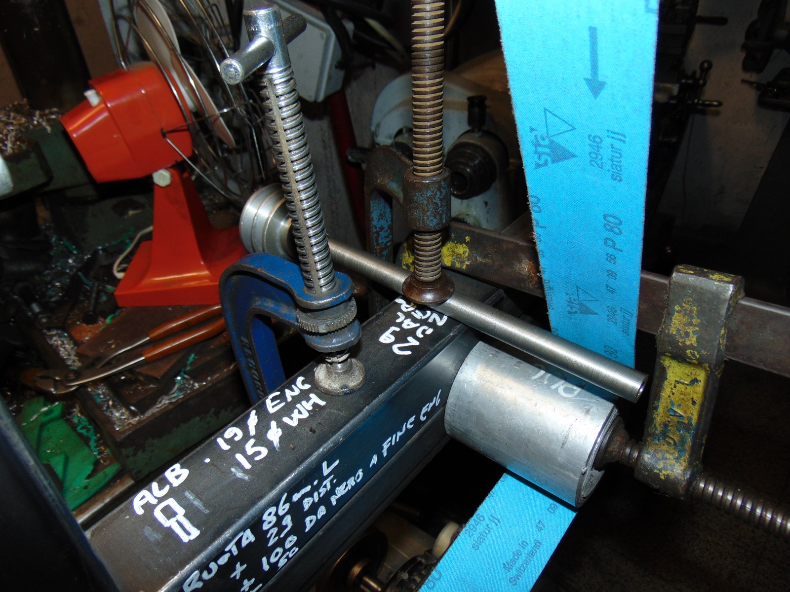

I built a kind of protractor from steel, I thinked different ways to solve the problem, but at the end I think that's the easiest. Wire in picture is only demo, I will make something more valid.

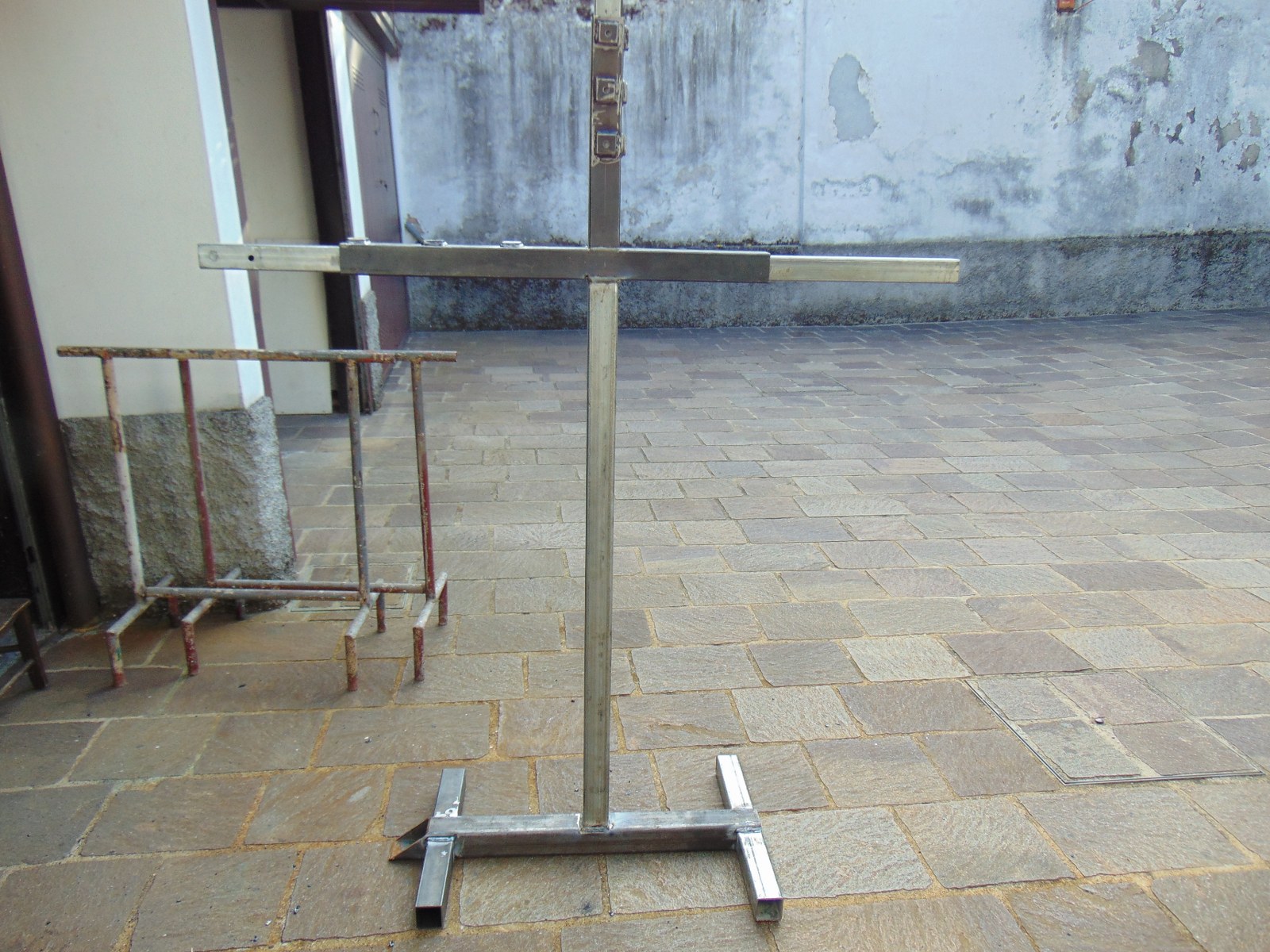

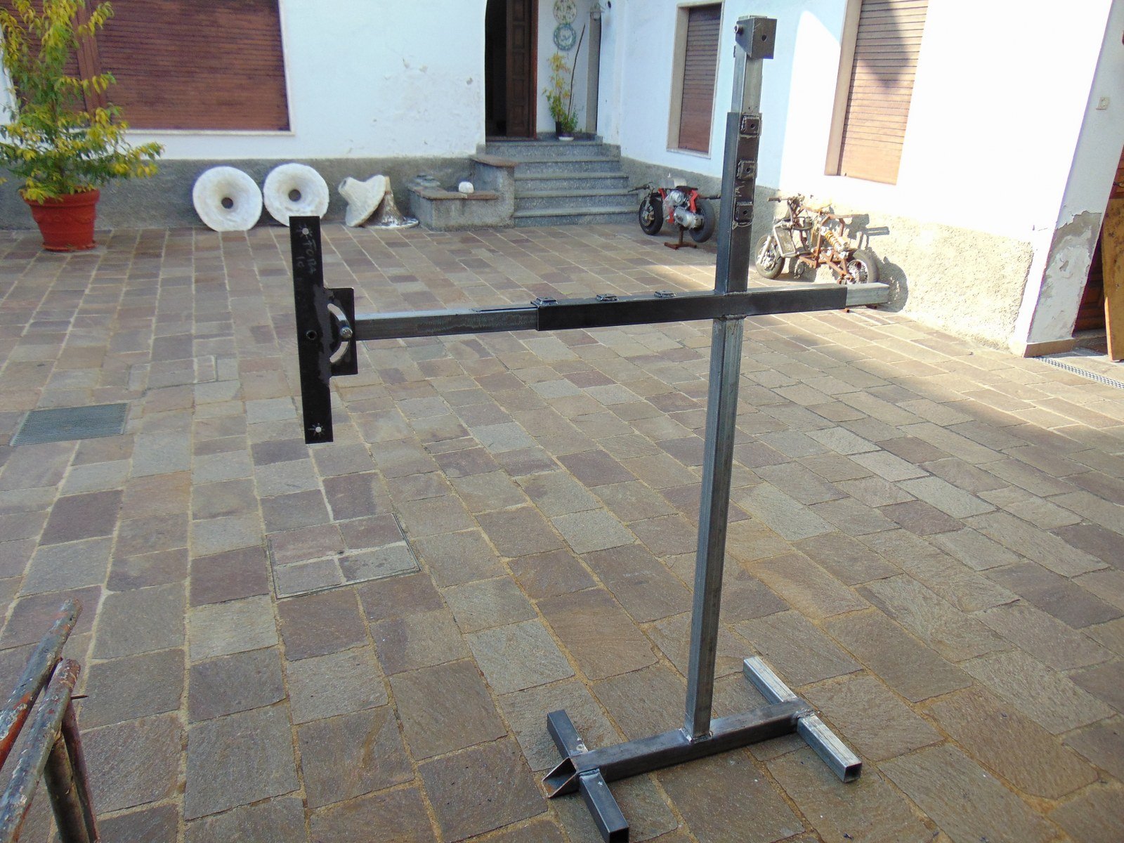

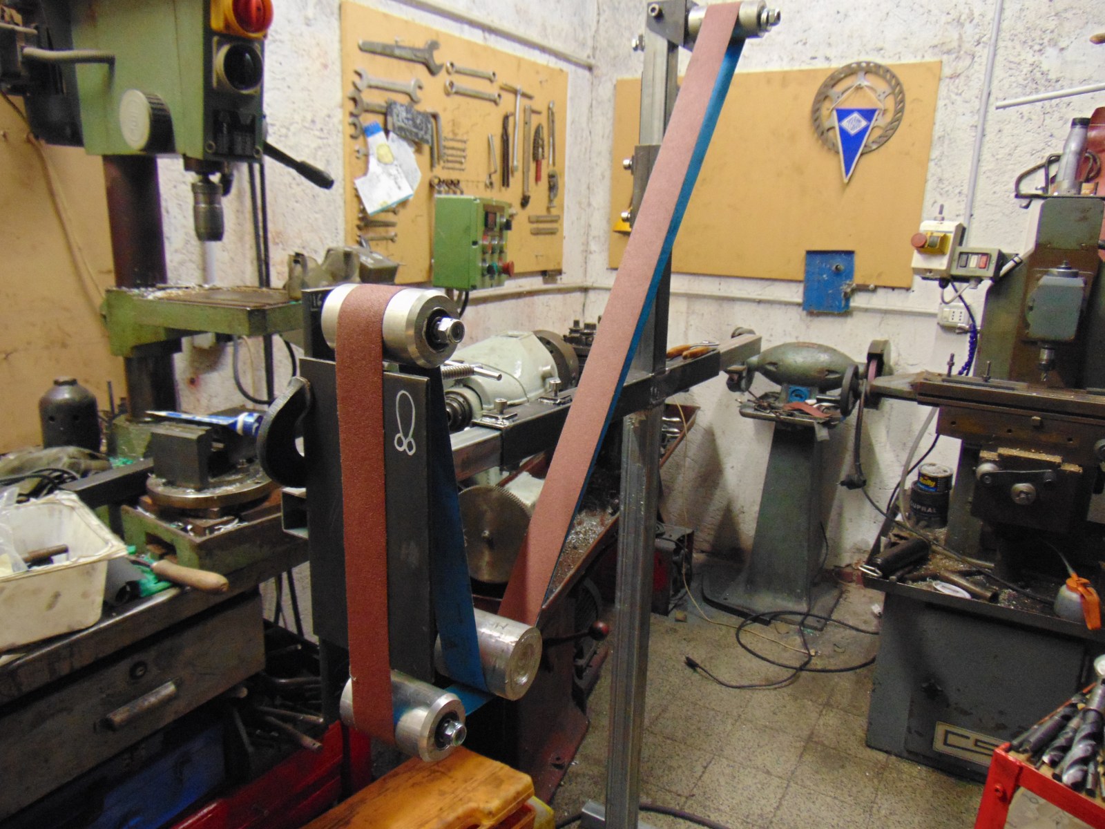

It's time to take measures for last wheel shaft, and decide motor alignment.
In last picture there is the longest belt 3m ( 118" ), I got also some shorter 1,8m, I think the outreach of arms is good, I hope to not have problems with vibrations, for this reason I put 12x m10 lock on both vertical and horizontal sheath.
Ps: this anvil is really beautiful! Hammering punches has never felt so good, Pieces motionless and sound attenuated, I'm happy:D

...thinking the next step...

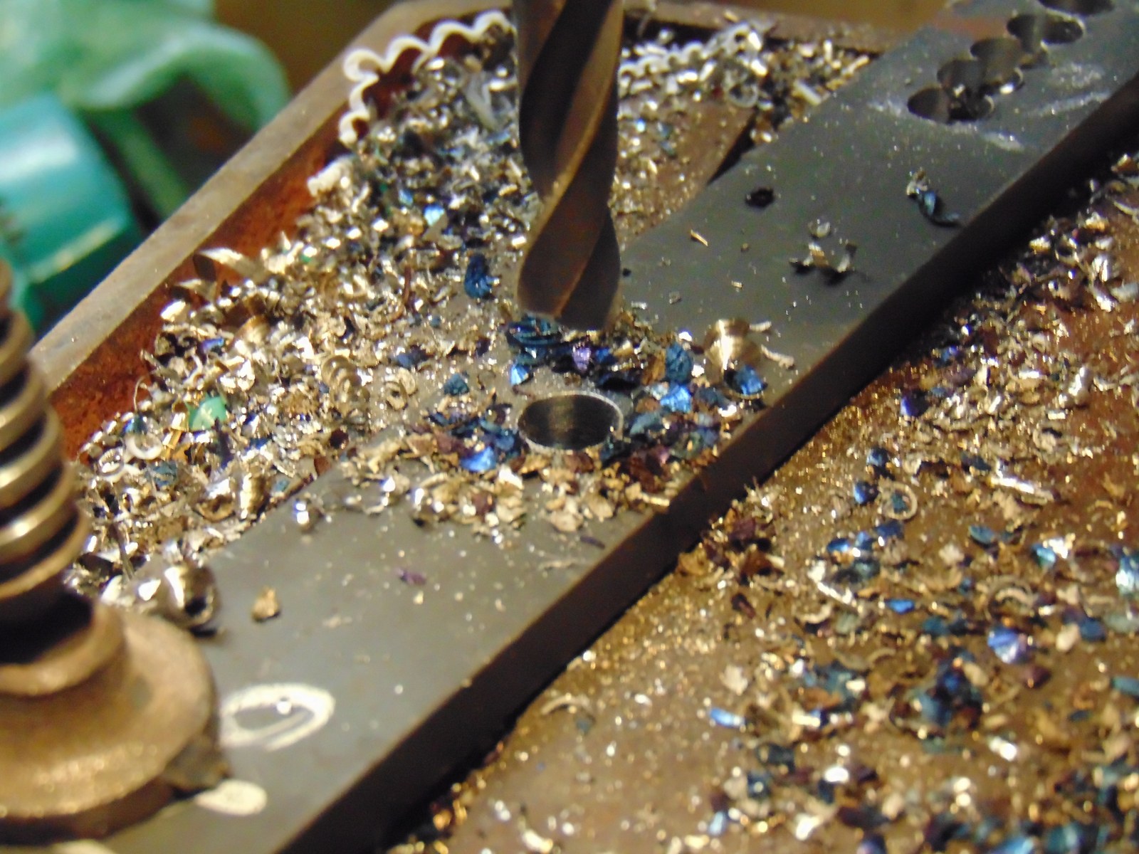

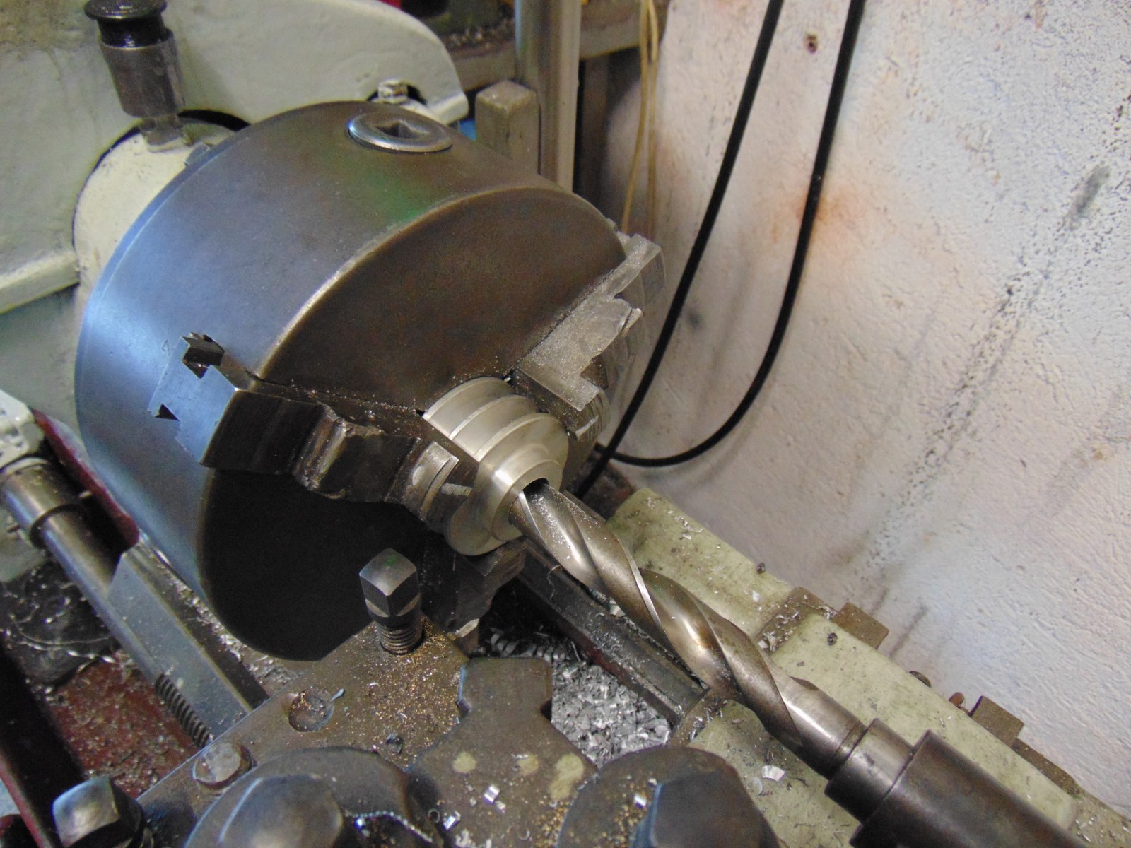

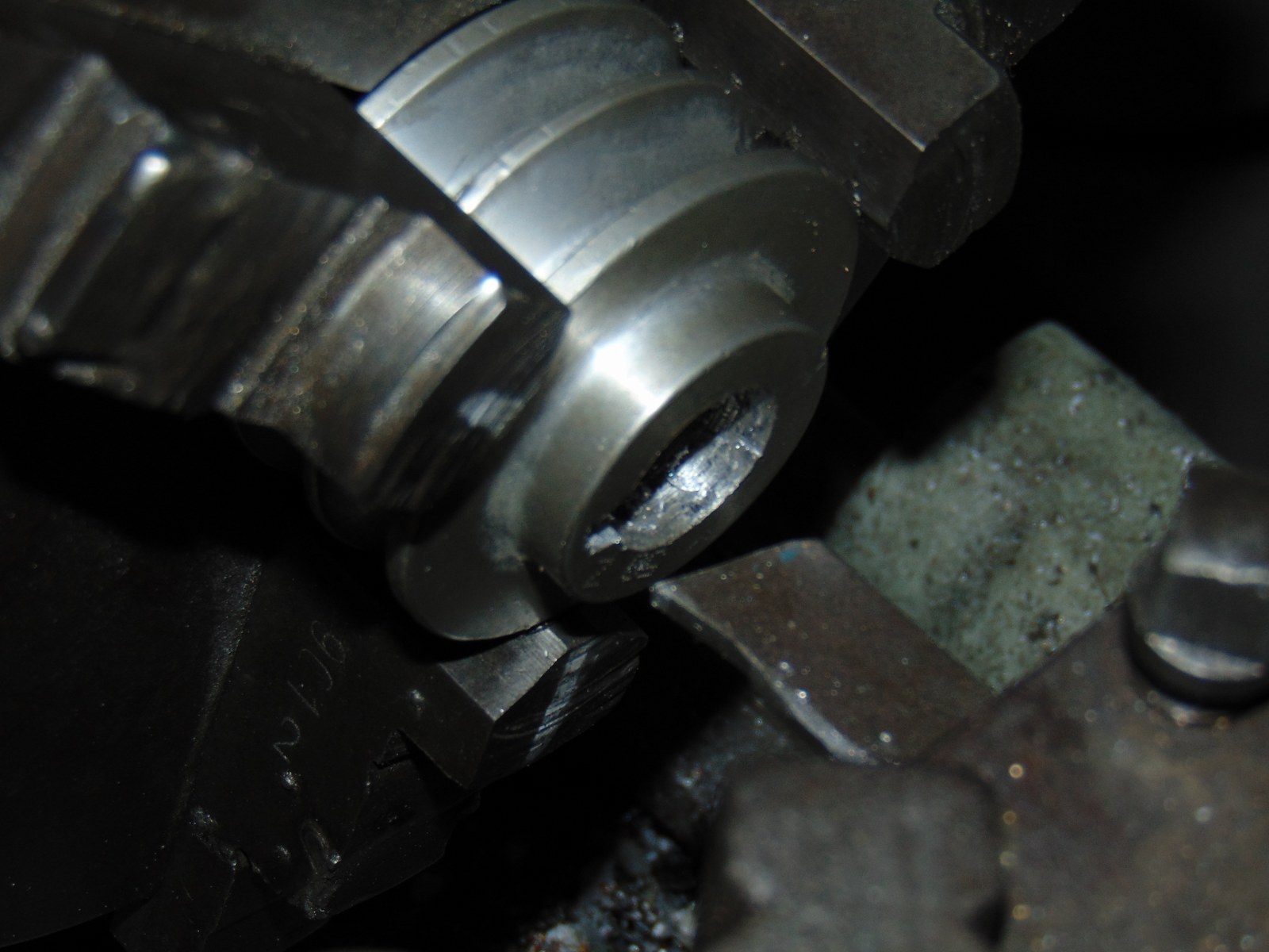

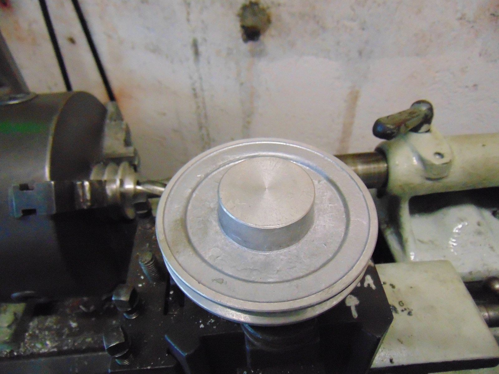

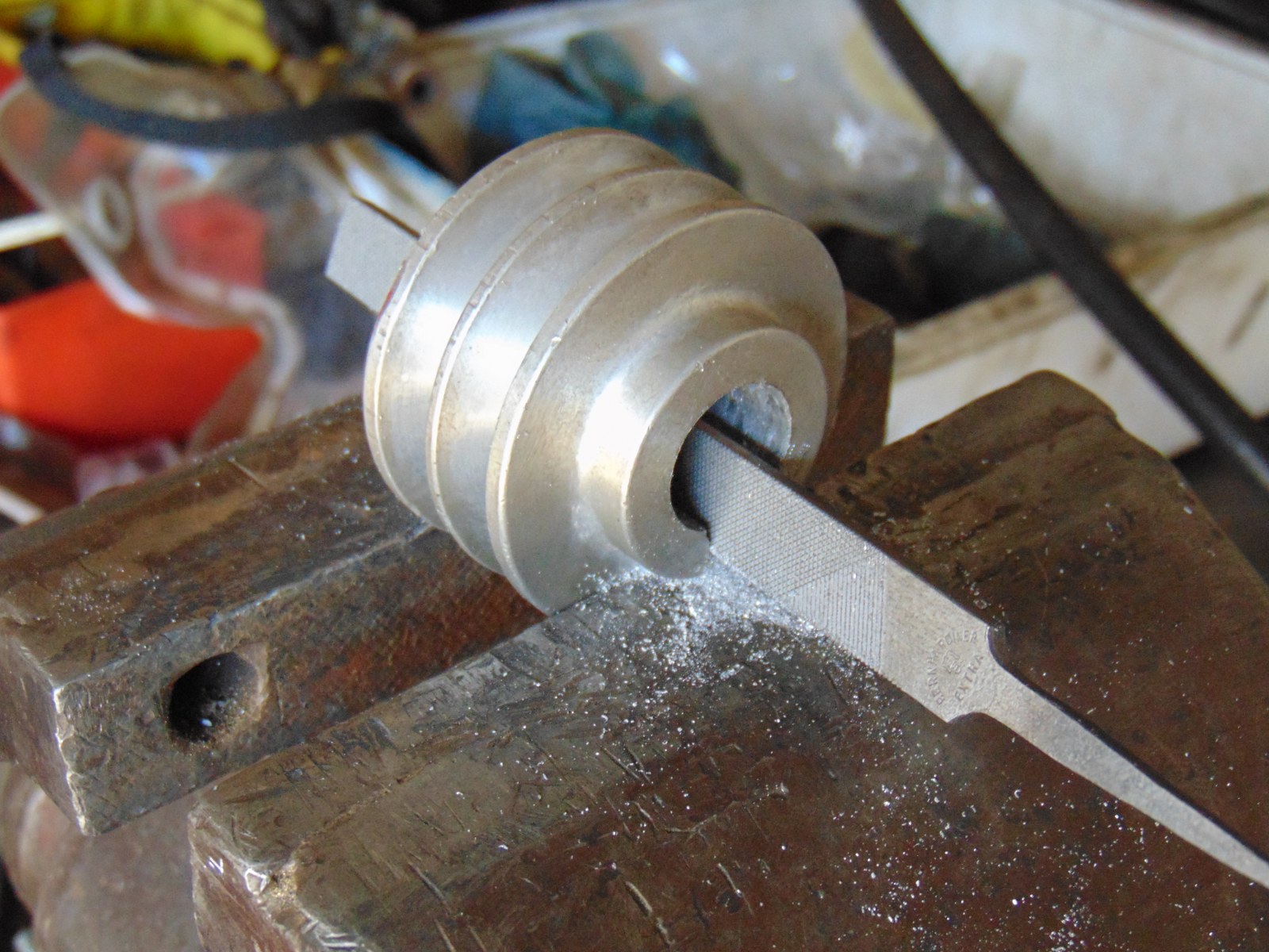

a good work maybe needs a couple of keyways, I can easily do with mill on the rod, but i got troubles doing them on internal of pulleys... Should I try with lathe and a parting tool? or maybe with 4\5 blades stick togheter? or maybe with a couple of grains ( I think the worst job possibile :rolleyes: )

the way I make a lot of my internal key-ways is to run a small end-mill through the bore roughly removing most of the metal then chuck the part in my lathe and lock the spindle with the precut key way exactly on the horizontal center-line then grind a piece of HSS the size of the key mount it in the tool holder with half above and below center then I hand cut the finished key way using the carriage travel making very small cuts until I reach my desired depth of cut. you can do this without using the end mill first but requires more material to be removed by hand
Thanks FrankS!
I tried, not the best work ever done, but at least it works :D
I used 3mm hss for cutting 19mm bore. Now I'm thinking about the last wheel, bore is 15mm, the exact height of the tool, i got no insert or hss so tiny to be used.
I'm thinking of drilling the wheel+shaft and put 6 grains, or maybe i should use file till Tomorrow, trouble is that wheel is 85mm long, maybe a 30mm key can be enough :D
