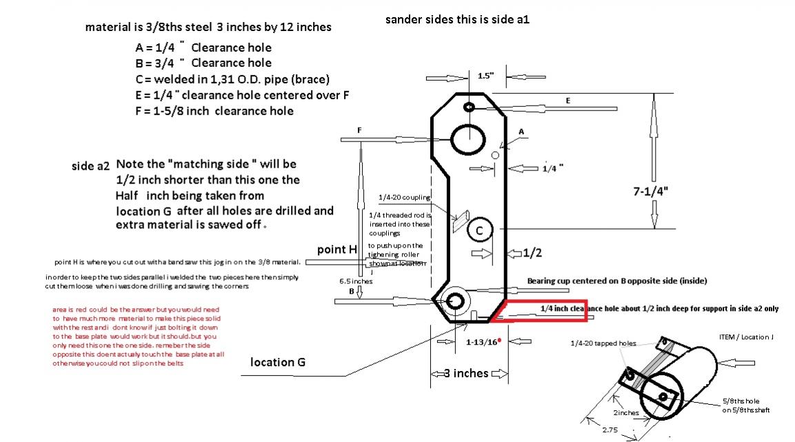

o only covered one tube with rubber and i did that by finding a radiator hose the proper size and pressing it over the DOM tubing worked the bomb. i did not put a solid platen because all i use it for is removing mill scale from my tubes to facilitate good welds. but it would be easy enough to do.
ok Steve i have sent you updated plans with some "NO Weld " suggestions.
i only covered one tube with rubber and i did that by finding a radiator hose the proper size and pressing it over the DOM tubing worked the bomb. i did not put a solid platen because all i use it for is removing mill scale from my tubes to facilitate good welds. but it would be easy enough to do.
OK here are the specs. i hope this is clear enough but i will answer any questions as fast as i am able. this particualr copy has some info for those that do not have access to a welder.
