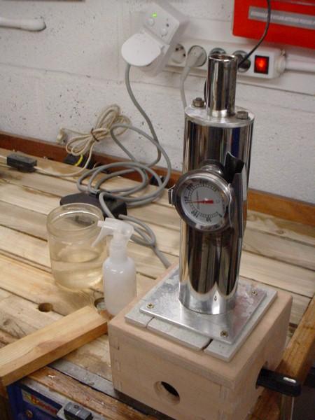

My homemade bending iron :
http://www.labellenote.fr/photo/gal_544/190_fer.JPG
A chromed table leg pressed oval.
An halogen bulb inside, with its dimmer.
A smaller tube on top for tighter radii.
A removable temperature sensor for ovens.
Note the wooden basement box, with the holes for the clamps.
Notice also the tile piece between wood and metal for insulation.
Works like a charm.
Note that I plug it in the wall through a differential circuit breaker.
I never like playing with water and electricity ....
A clean build, like always, Christophe.
Not so neat, I broke the tile :headshake:
but anyway, it works ...

Neat setup. Looks professional!
Al
L@@KS great, What does it bend? :O)
Congratulations ingenious :clapping:
