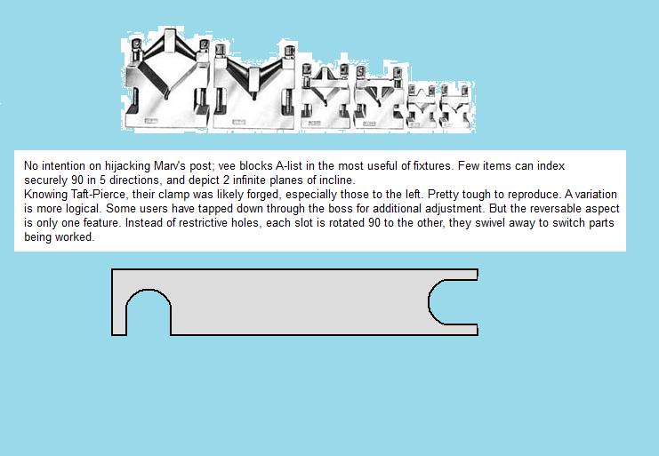

Marv;
Full agreement on cast style clamps. Once in awhile, needing to orient 90 from initial position, a less than perfect solution is perch twixt ground blocks. Your concept certainly answers the height issue. Commercial manufacturers tend to proprietary threads, preventing subbing a short set or cap screw. My treasured old Taft-Pierce's, the only bridge style worth their height still convert to flat strap when needed.
<*>*^$@:-)! That's the triumphant rage smilie [pun intended] who drills and taps next size up - usually fine thread metric!
Attachment 12763
Marv,
These are a great improvement over the extra-high original clamps and the dog point brass screw is a smart addition. I reproduced some of the clamping screws to a Starrett set of v-blocks similar to what you show on the left and had to make proprietary threads on the lathe just like Toolmaker51 mentioned. Your set will be a great addition to any shop. Thanks for sharing this.
Paul
So when our collective little Ms. questions purchase of another set of change gears, I suggest tactfully......just don't say ''I need a screw'.
