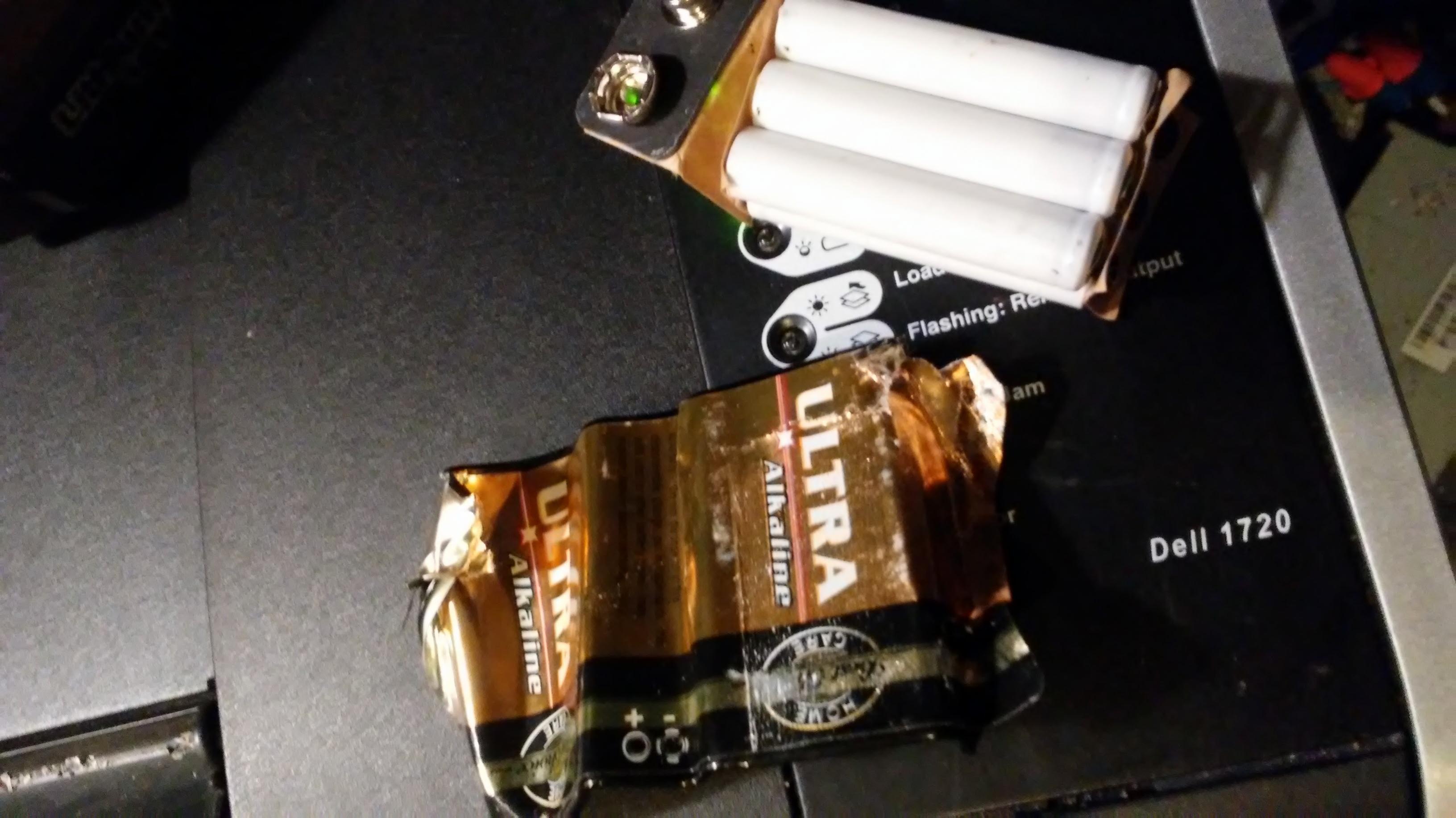

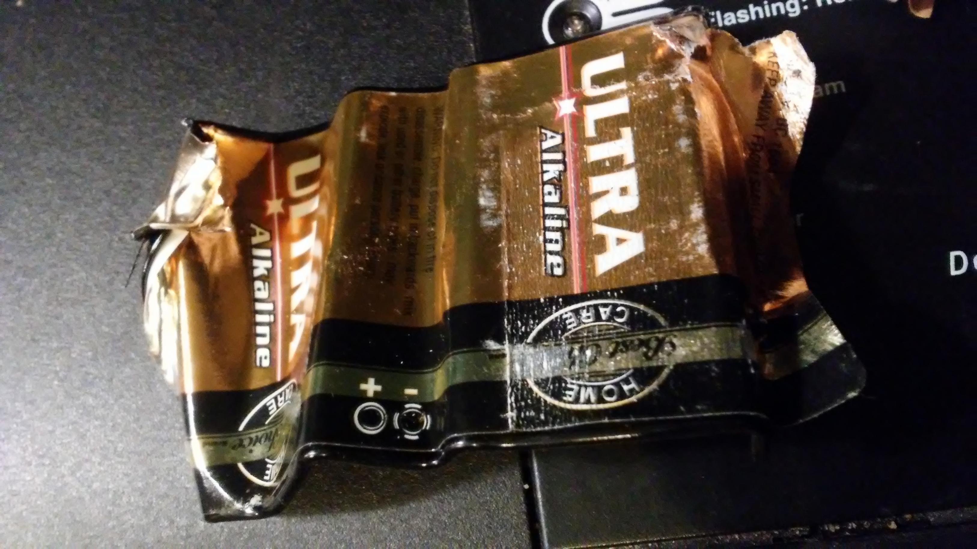

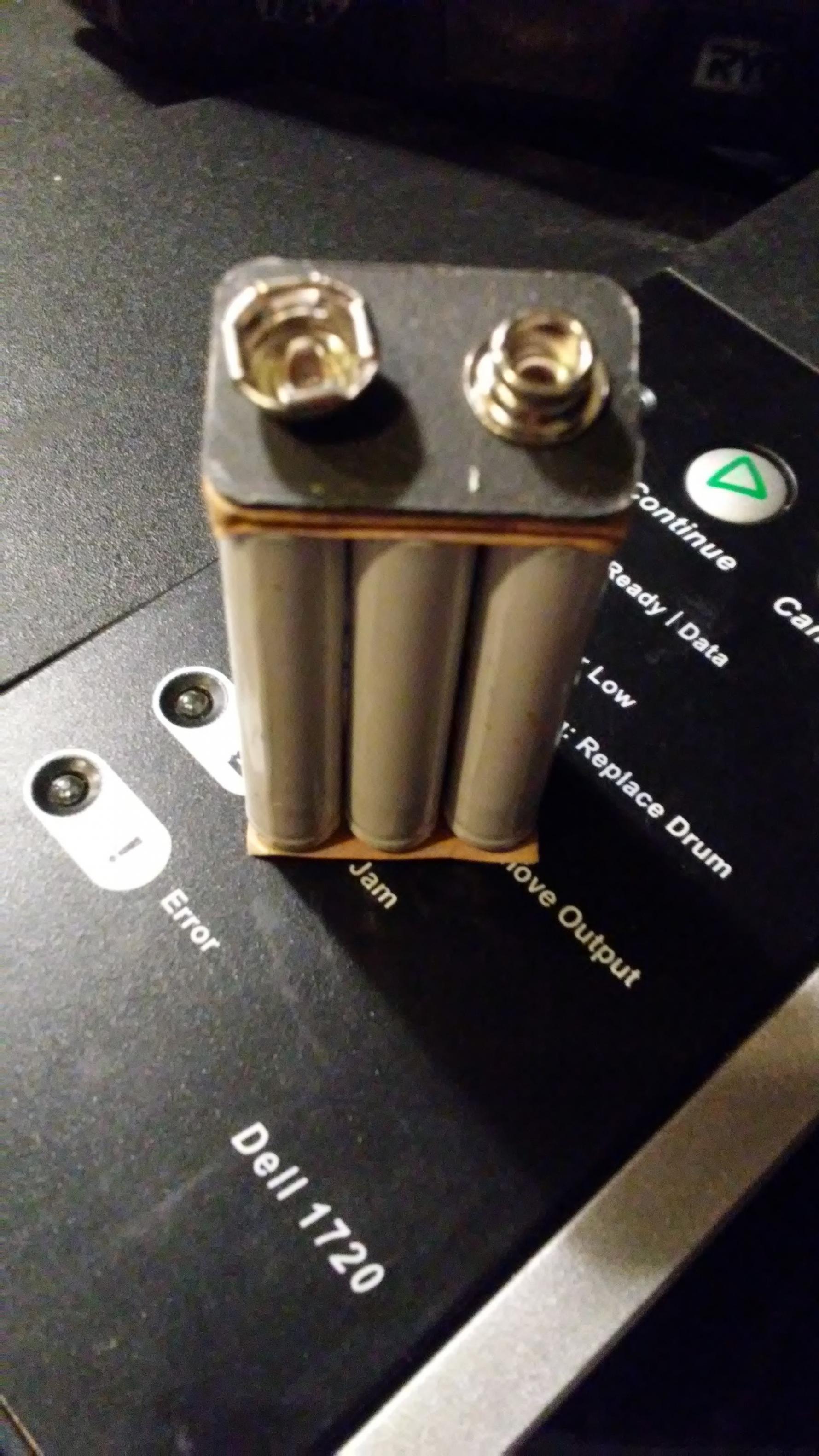

Get that old 9V and take it's cover off...
Attachment 18442
They are hardly ever made like this now, they have a newer cheaper way of making them where it it stacked in plastic casing but with this style the battery pretty much consist of AAAA batteries, 1.5V each.

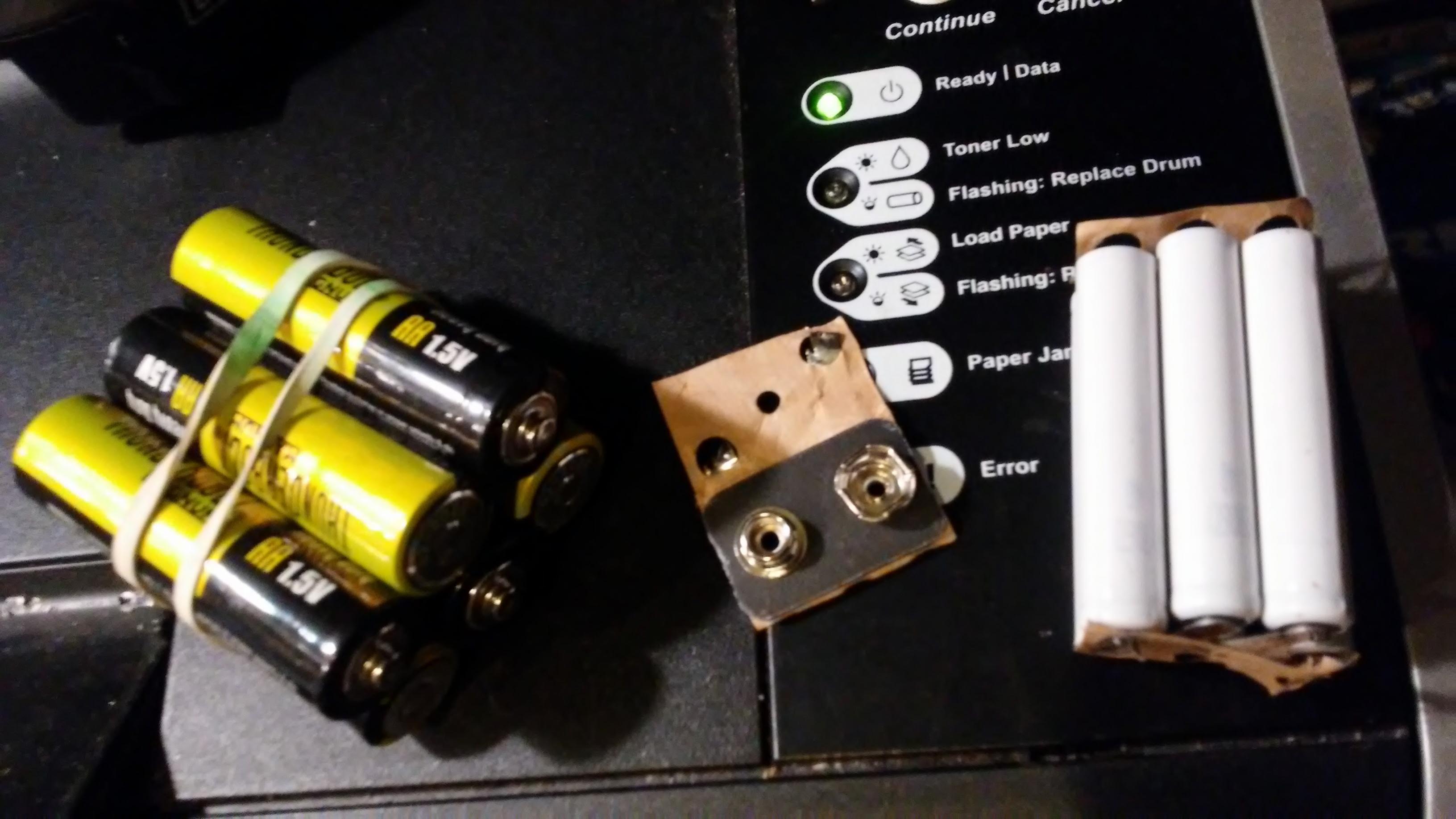

Attachment 18446
Attachment 18447

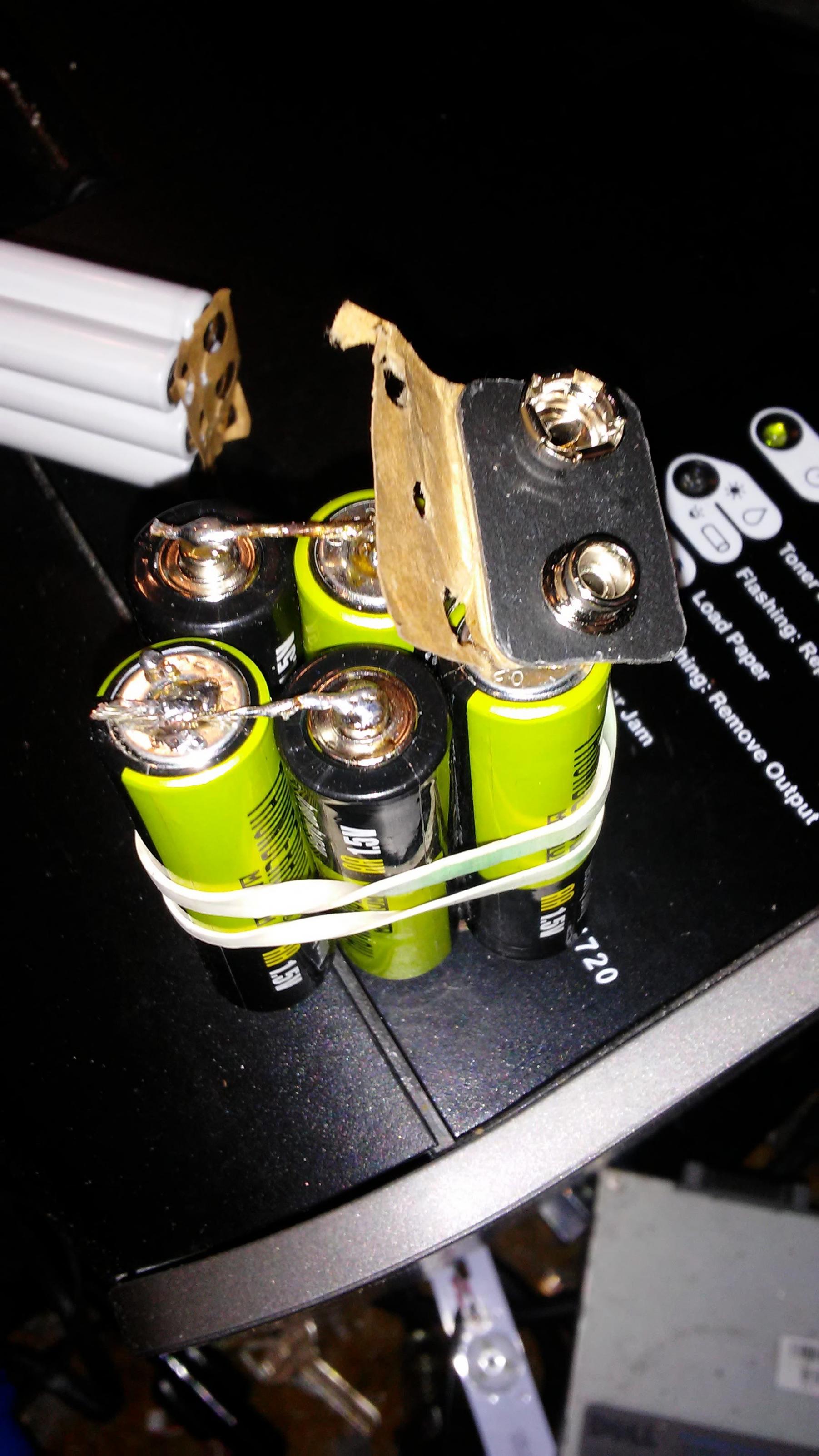

I pulled the top off of it, noting which was negative side and which was positive then I arrange my free Harbor Freight AA cells in the right directions then put a rubber-band around them.
I get my trusty solder iron out and my safe goggles and tin the tips of all the batteries. I noticed 2 of the batteries had dents in the side but that's okay....

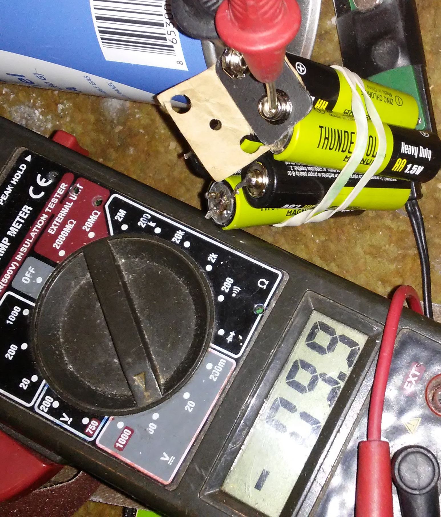

I then solder a wire going neg - to pos + so that the batteries are connected in series....
Attachment 18448
Note that I had the connector soldered on backwards here but all and all it worked...
Attachment 18449

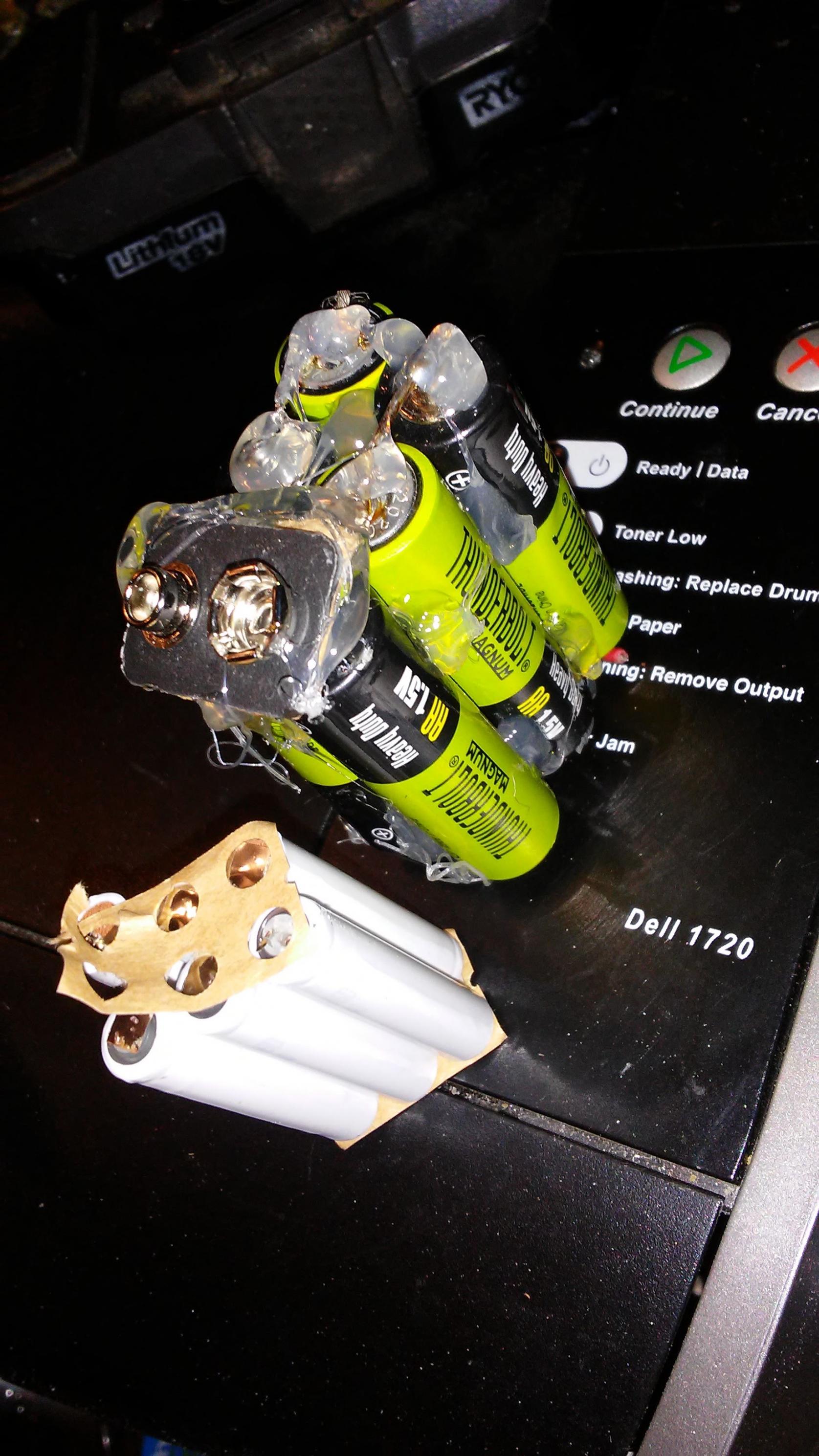

Then after all that soldering on them gotta hold them together somehow so I bust out the hot glue gun and done. Here is a little side by side to compare the sizes
Attachment 18450
