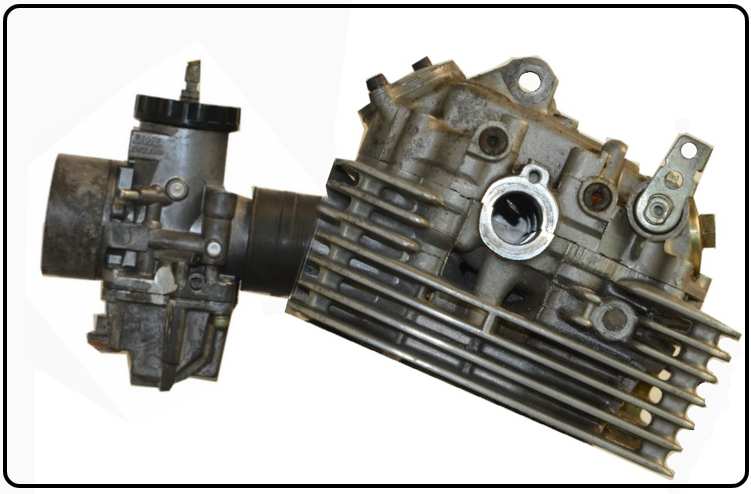

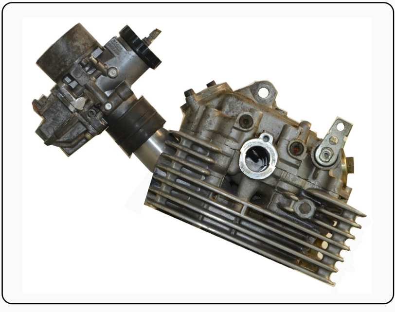

I race a Yamaha SRX600 in the US, this started life as a useful street bike with no racing pretensions so the ports were designed without all out performance in mind. It has 4 valves but the two inlets each have separate ports and carbs, unlike the usual 4 valve system of combining the ports into a single port.
Attachment 16878
Initially I did some quick modifications (away from my flow bench) which produced a useful power increase, but I was sure that more drastic work would produce a much bigger improvement. This would have been a big risk to the head because there would have been no way back to the original if it didn't work well. So I made my plaster tool.

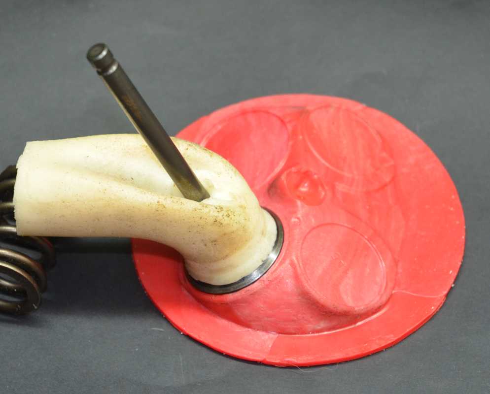

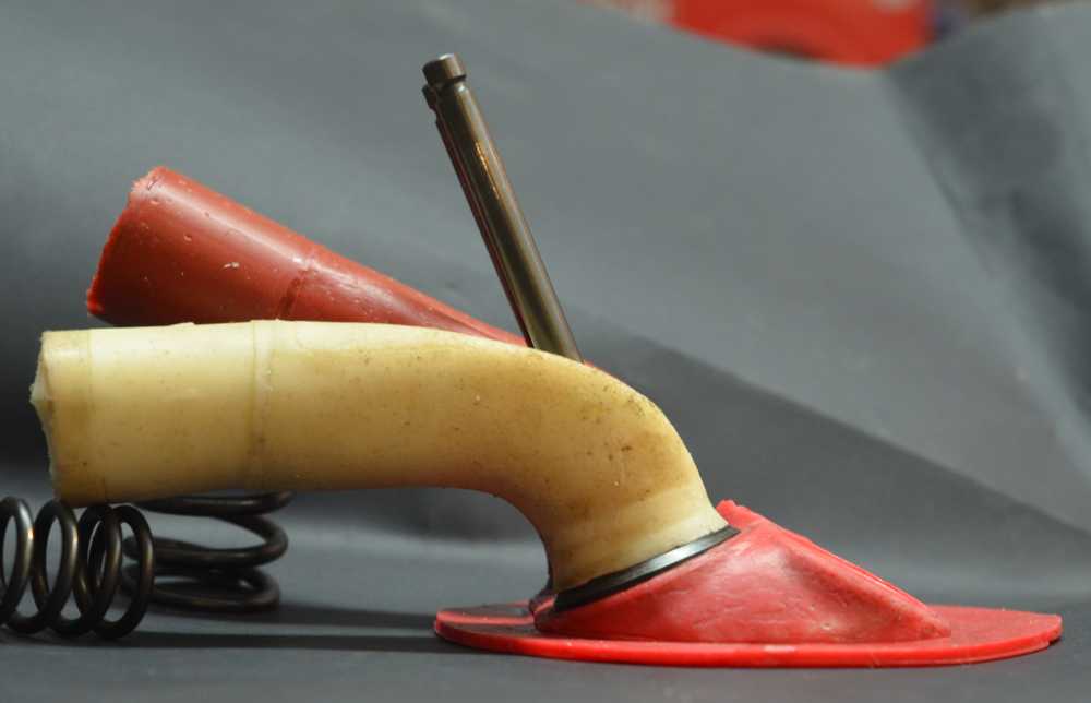

Firstly I had to make a tool to make the plaster tool. This task requires moulding the original ports and combustion chamber of the real head, this is a non-destructive job. There are many moulding compounds that are used for this, some are a two part mix which can only be used once but I use "Vinamold" which can be re-melted and used many times. Resins like polyester and epoxy which set rigid are not suitable for this process because you need a rubbery like material so that you can extract the moulds from the ports.

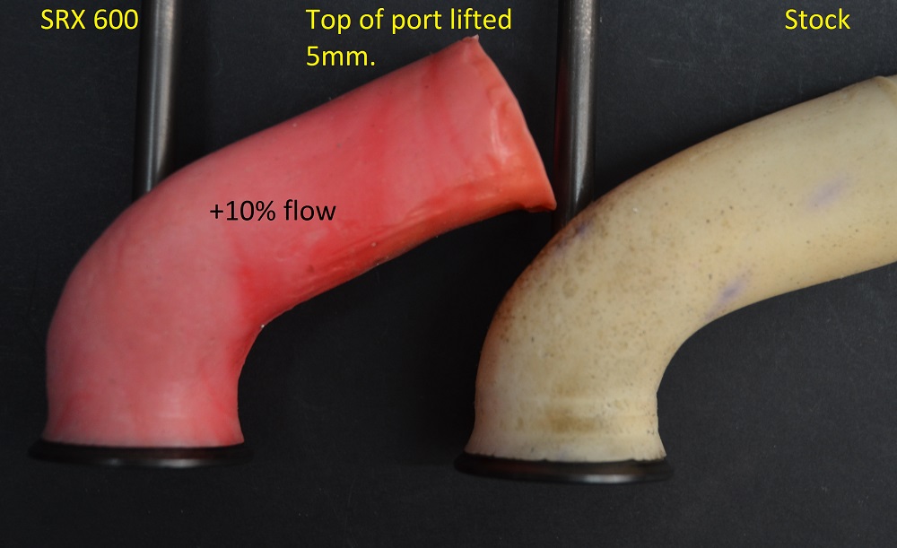

Attachment 16879 Attachment 16880

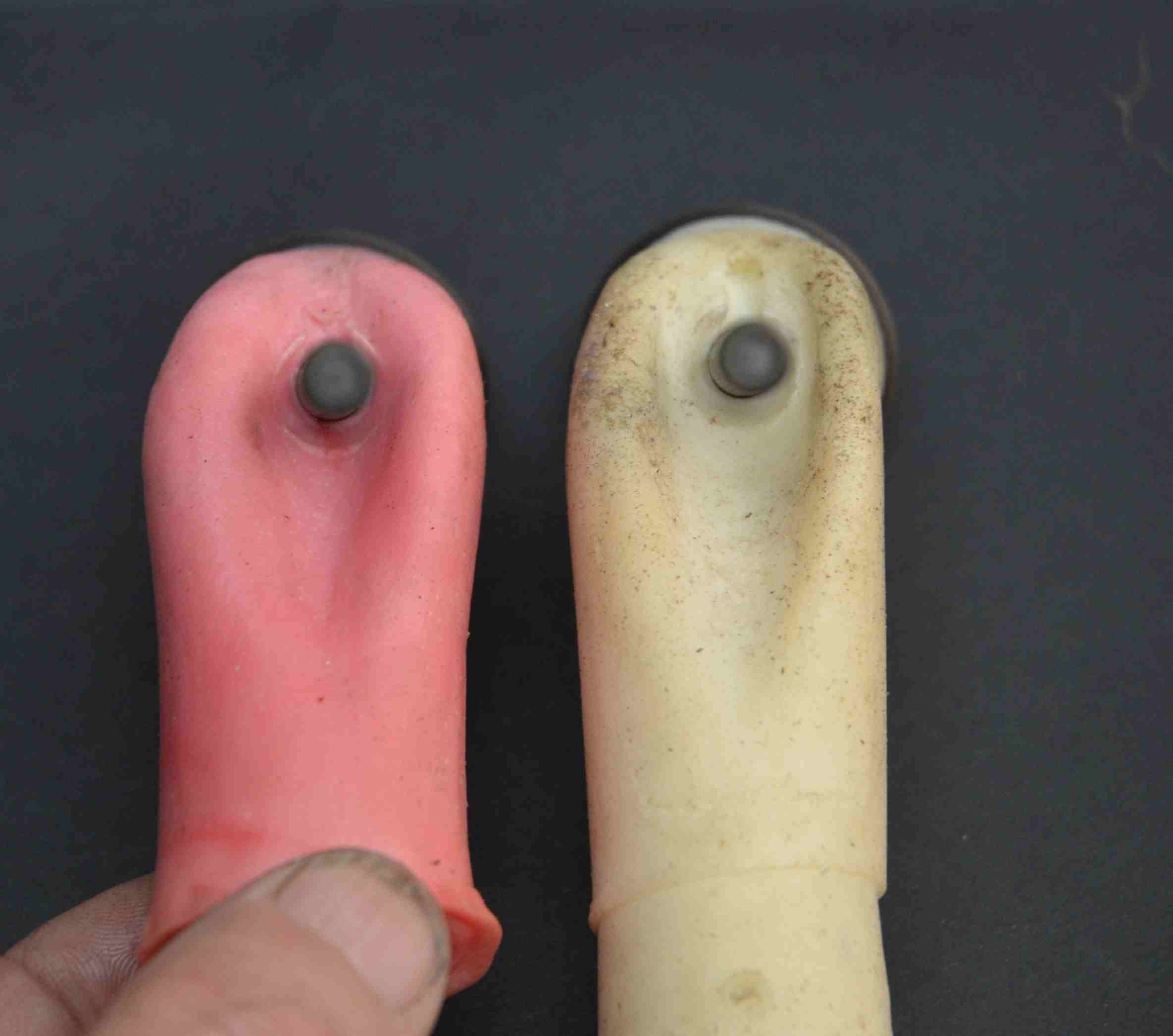

Here we have ports moulds, the pink one is from a port with small modifications which showed a 10% flow improvement over the stock port moulded in white.

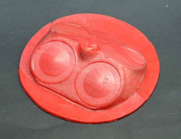

Attachment 16881
This shows the mould of the combustion chamber.

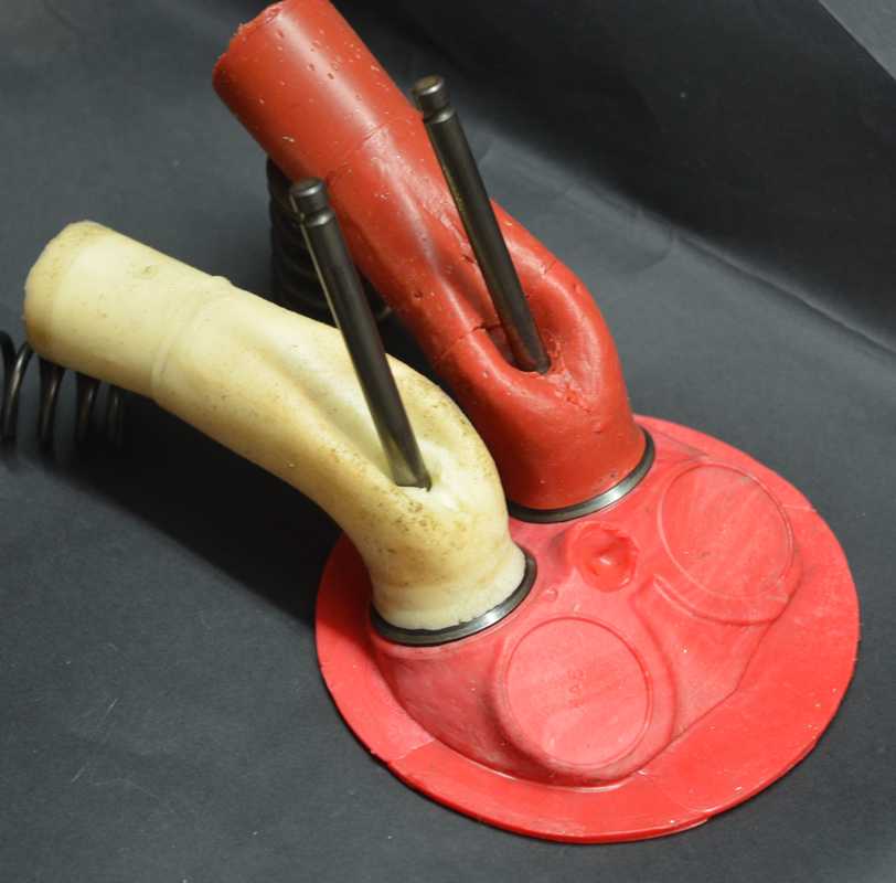

To produce the plaster head I had to combine the port and chamber moulds as shown here.
Attachment 16882 Attachment 16883

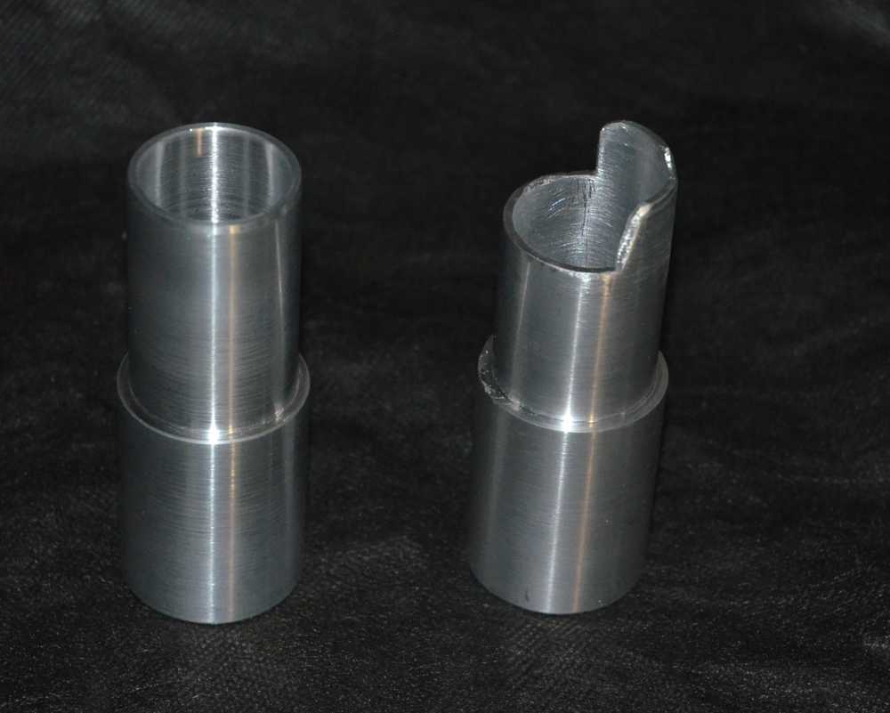

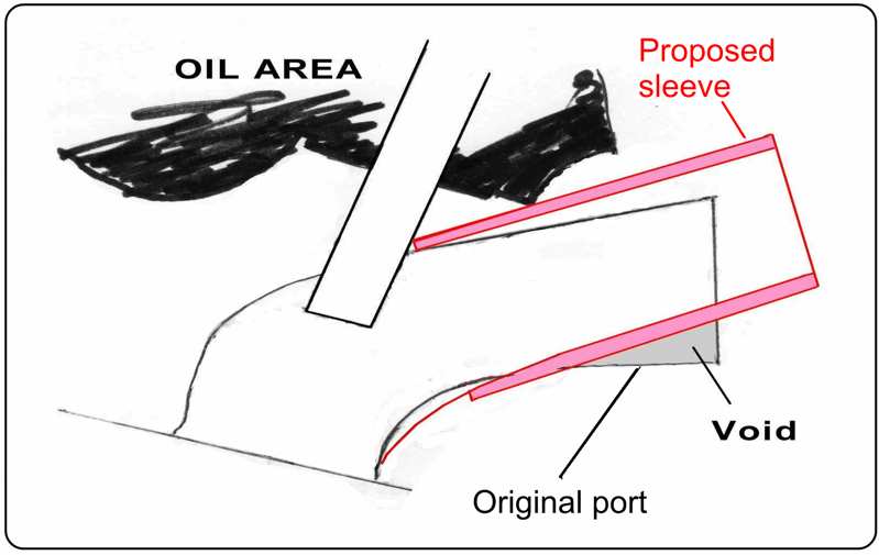

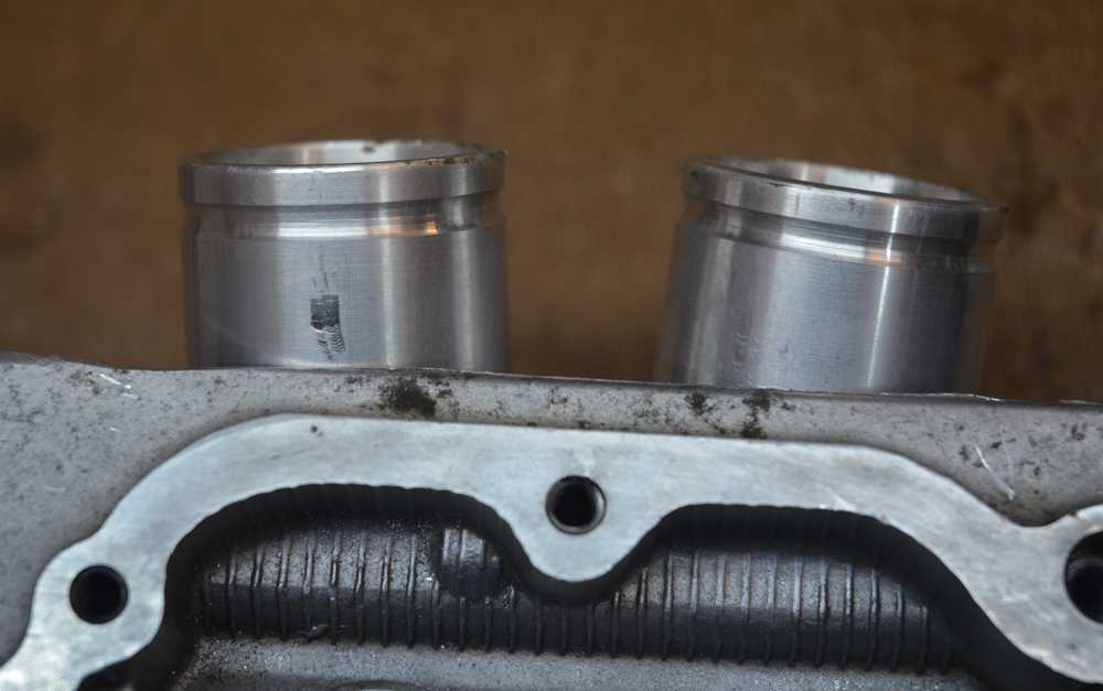

Air flow doesn't like to turn corners and so the best way to get good flow is to aim the port as close as possible to the back side of the valve. This requires raising the port as much as possible. The practical limit to this is breaking through into the lower valve spring seat area, which contains oil. In this case there is not enough metal to raise the port to that height, so I planned to bore out a hole where there was supporting metal and insert a sleeve.
Attachment 16884
This sketch shows the planned inserted sleeve, It can be seen how much straighter would be the flow path.

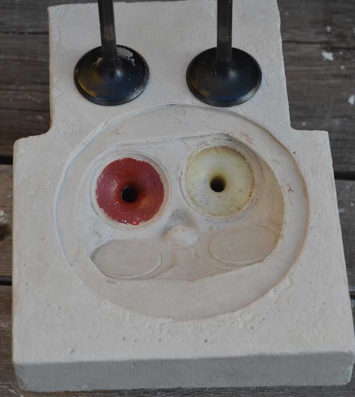

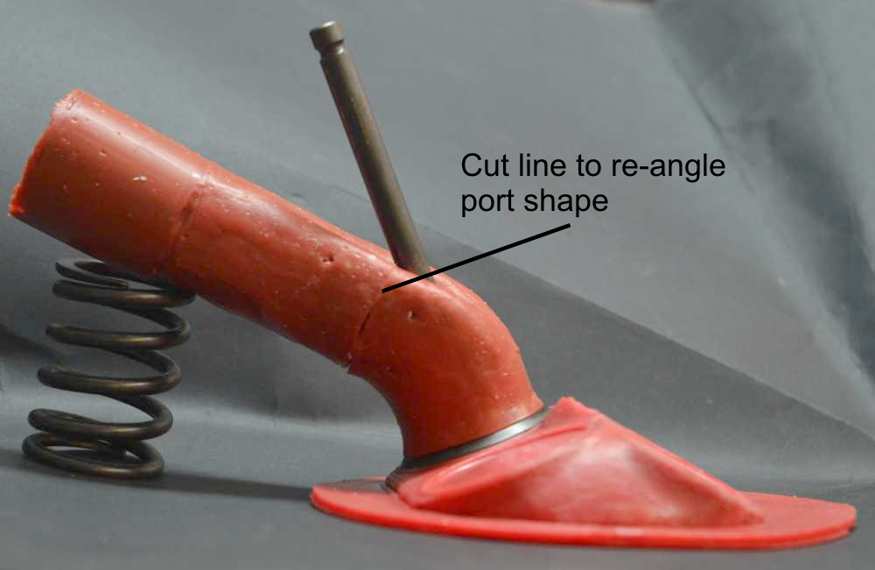

In order to test this with my plaster tool I needed to cast the plaster with the same steep port alignment. To enable that I cut a Vee out of one of the port mouldings and glued it back with a steeper path. The other port mould was left stock which gave me a base for comparison and also a check that the plaster head gave similar flow bench numbers as the real metal head. I call that an "honesty" check.
Attachment 16886 Attachment 16885
The first pic. shows the steepened port and the second illustrates the large change in port angle between the stock and modified ports.

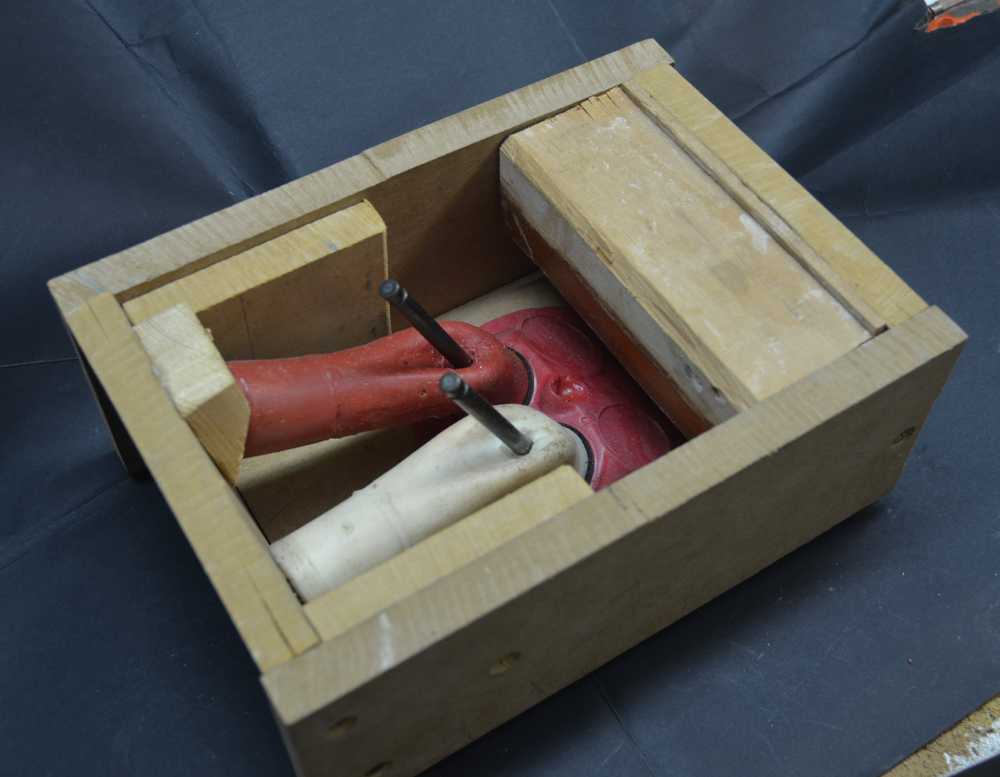

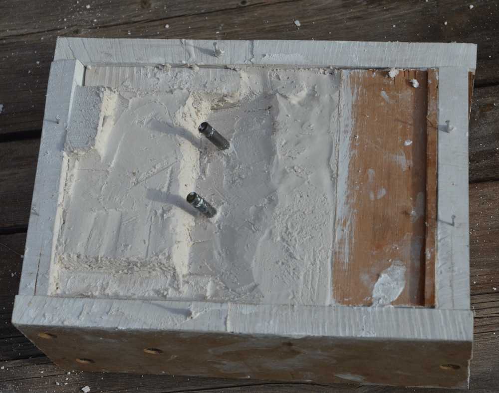

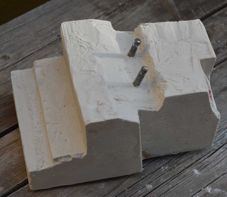

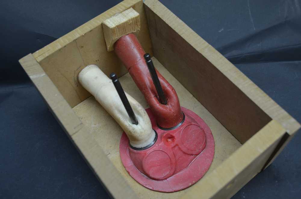

Now was the time to mount these moulds into a box for casting the plaster.
Attachment 16887 Attachment 16888
Ready to go.
Attachment 16889 Attachment 16890
Here is shown the plaster cast, in its box and when removed.
Attachment 16891
The de-boxed plaster head awaiting the removal of the port moulds.

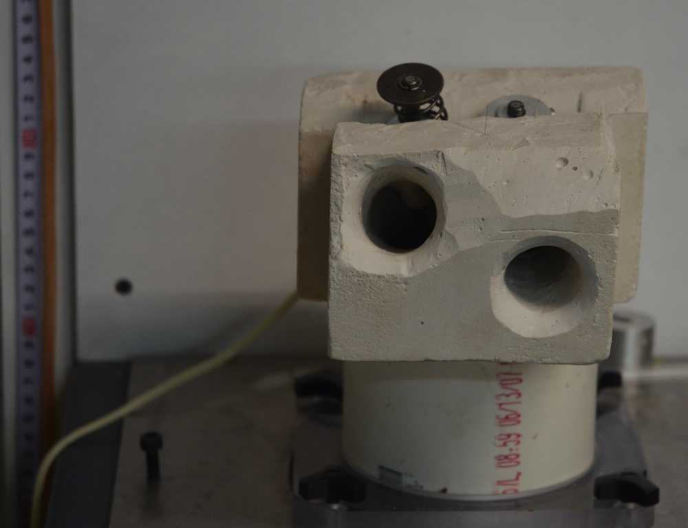

Attachment 16892
Note the difference in the air entry height of the raised port compared to the stock one. The entry radius is to smooth the air entry and is common practice when flow testing.
Attachment 16893

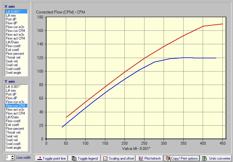

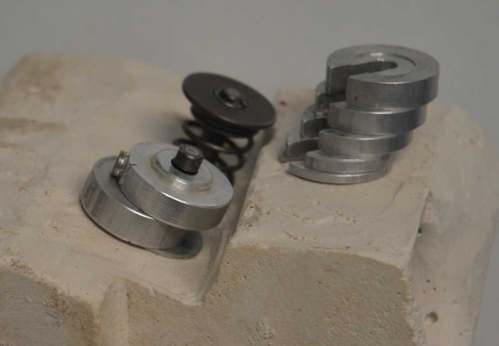

For the flow bench tests, the valve is opened in steps of 0.050" and the flow is measured at each step and processed in my own software. I find the quickest way to do this is to place different width spacers between the base and a collar on the valve stem.
The plaster head was tested and modified and the cycle repeated a few times until I was satisfied with the results. The results were good enough for me to proceed with machining the head.

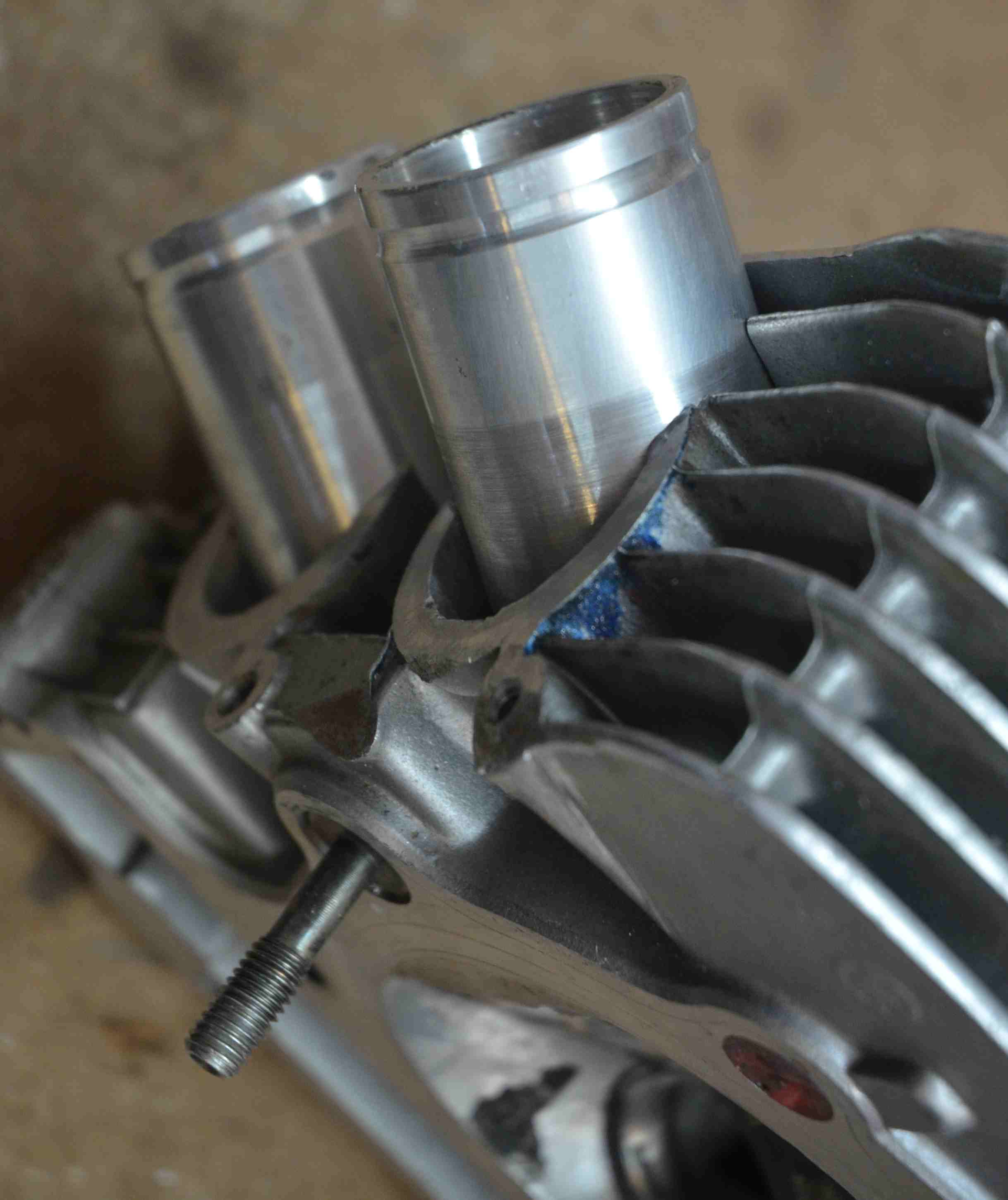

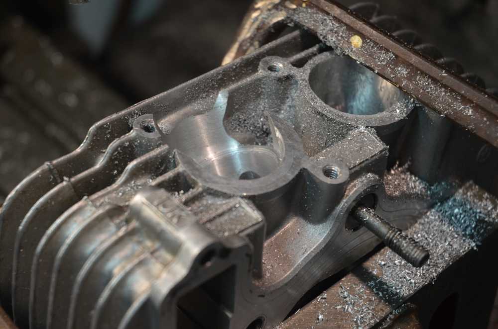

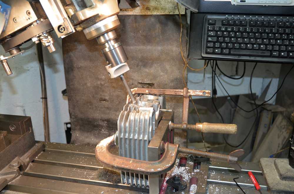

Attachment 16895 Attachment 16894
Machining the port to receive the sleeve and the machined head.
