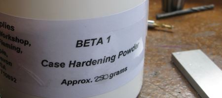

Just thought I would start a thread on this subject to see if I could find any better options:
I'm currently using this compound from EKP tools:
Attachment 23379
Attachment 23380
More details and a review here: Case Hardening Compound – glue-it.com
What other options are there for case hardening?
I used to use "Kasenit" but found it no longer available. I landed on this site - https://www.travers.com/1lbcan-1-surface-hardning-compnd-kasenit/p/81-003-001/ - they do suggest an alternate option ( https://www.travers.com/steel-surfac.../p/81-003-201/ ). I saw from the available PDF ( https://www.travers.com/images/art/81-003-001_msds.pdf ) "Kasenit" was Sodium ferrocyanide - yellow prussate of soda! Na4 Fe(CN)6
Hope this might help.

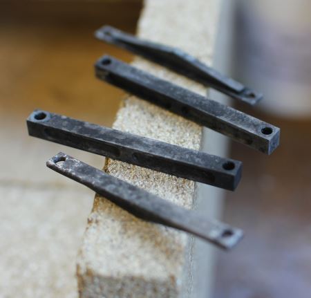

Chris (@clickspring) has explored this process in his Antikythera build, and got some quite decent hardening with just charcoal, salt and flour: https://youtu.be/V_Mp1fNzIT8 Sounds much less toxic than mucking about sodium ferrocyanate! You DEFINITELY want good ventilation for that!)
So far I think I'm enjoying his 'Antikythera Fragments' videos about re-inventing and exploring ancient technology as much as the mechanism build itself...

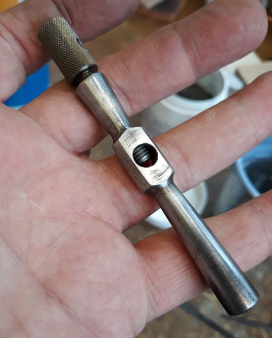

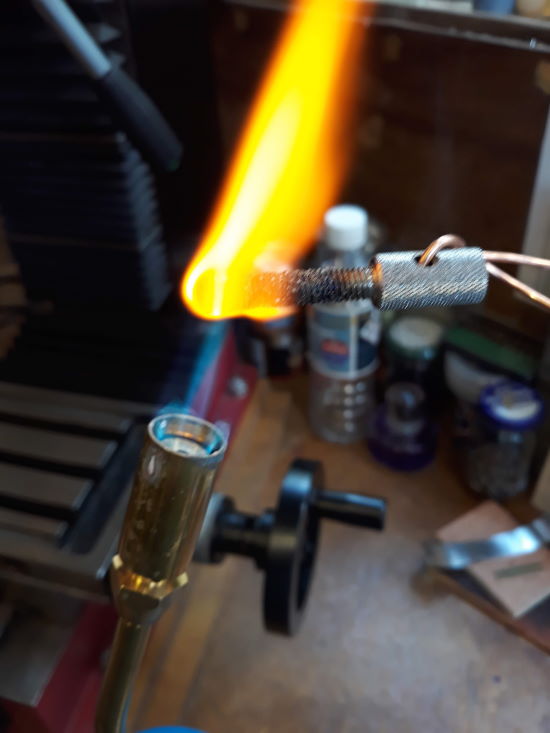

2 Attachment(s)
Have been using this case hardening to harden the end of a replacement bolt for a small antique LAL tap wrench and it has worked really well
Attachment 34336
The reward of repairing something that is so well designed is wonderful:
Attachment 34337
