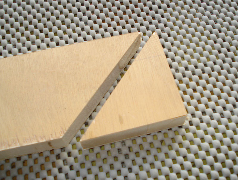

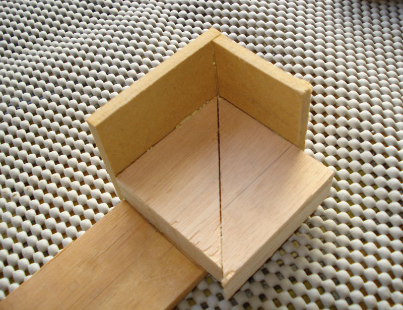

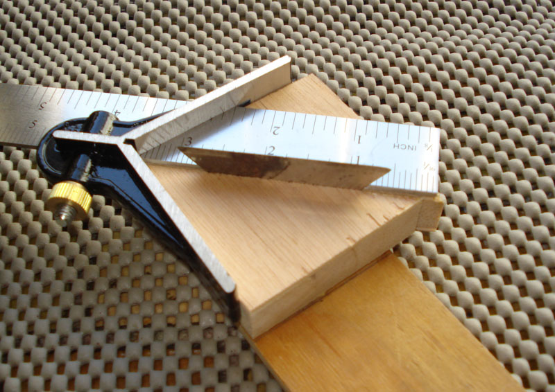

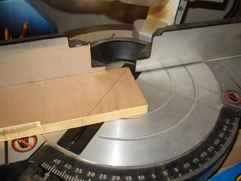

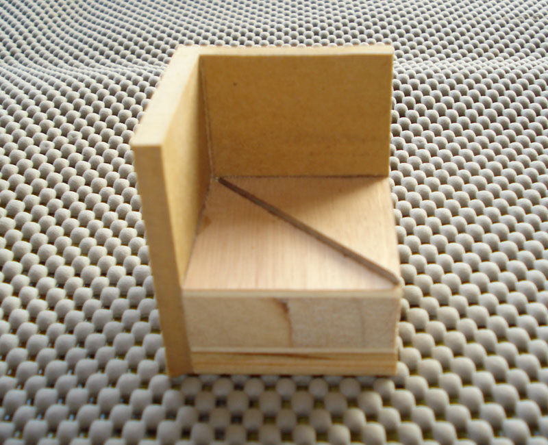

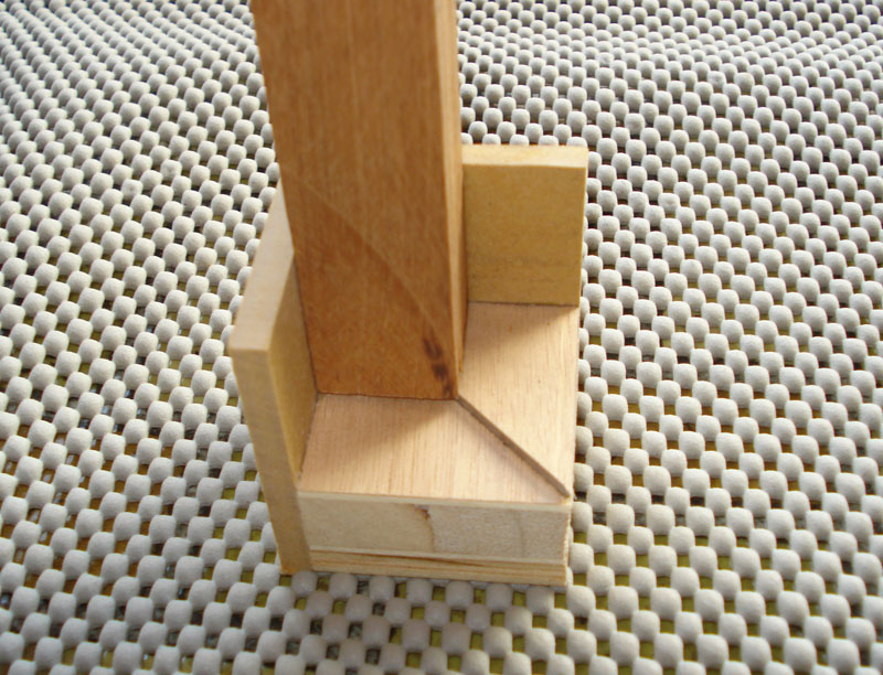

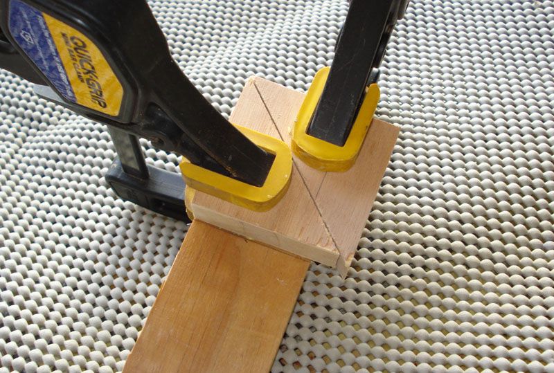

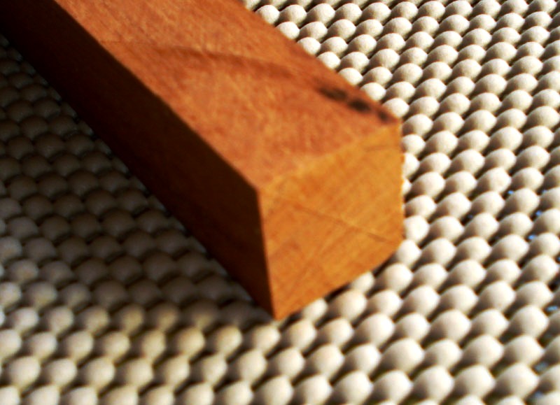

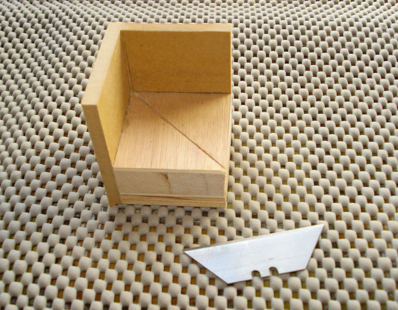

This center finder is made with scrap wood and a cutter blade.
It is useful to locate the center on round, square, or octagonal material (wood or plastic), for turning.
Attachment 4314
Attachment 4315
Attachment 4316
Attachment 4317
Attachment 4318
Attachment 4319
Attachment 4320
Attachment 4321
Attachment 4322
Regards.
