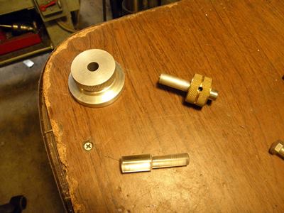

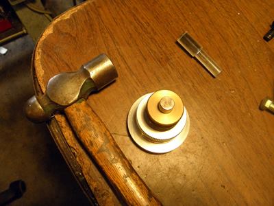

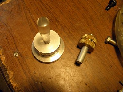

Center Punch EYE
Center Punch EYE.
Made from Aluminum body, Brass punch holder, steel punch and Plexiglass eye piece.
Eye piece has small circle inscribed at the bottom to center the target.
I didn't make the plastic eye piece a gentleman in Texas sent it to me after I emailed him that I liked his design.
Attachment 2057Attachment 2058Attachment 2059
Nicely machined punch guide. I like the eye piece idea.
Thanks Altair your to kind.
Cool, that eyepiece feature is one I haven't seen yet.
