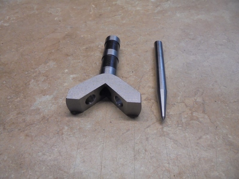

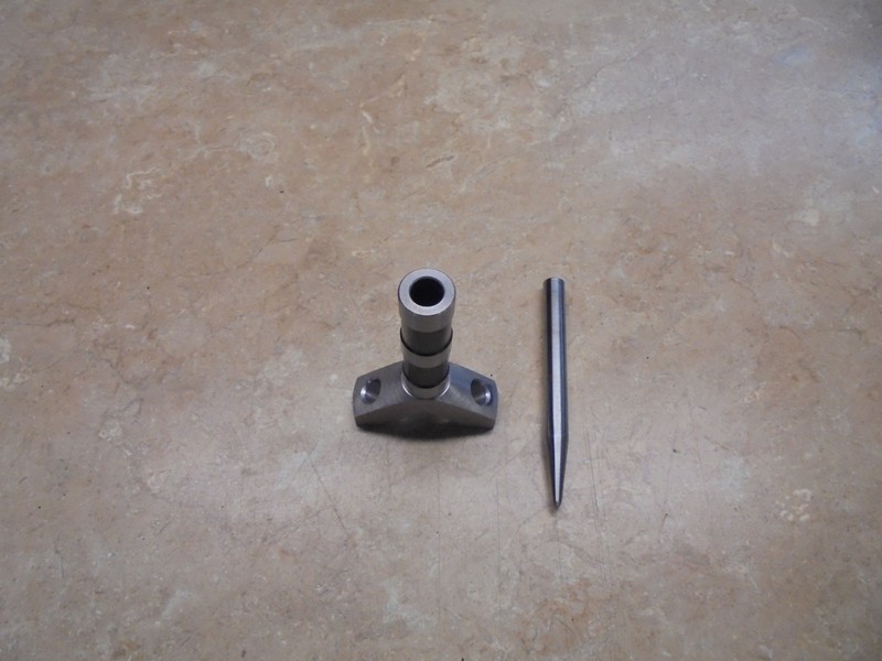

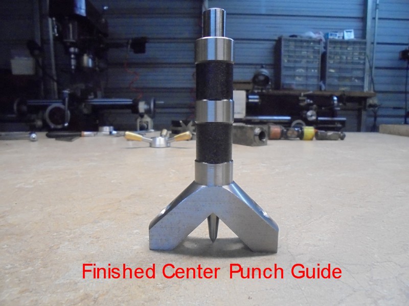

I built this little tool to assist in holding a center punch at 90° from the work surface; it’s hard to hold a center punch at perfect right angles, when you strike the punch and it’s not held at 90° then it will move creating an inaccurate center punch mark, this tool eliminates that problem.
This tool was designed to be simple and user friendly; the punch guide is a one piece construction which was made from 1018 CRS, with a .500” reamed hole thru the entire length of the tool to guide the punch accurately, while the punch itself was made from O-1 tool steel hardened and tempered ¾” on each end.

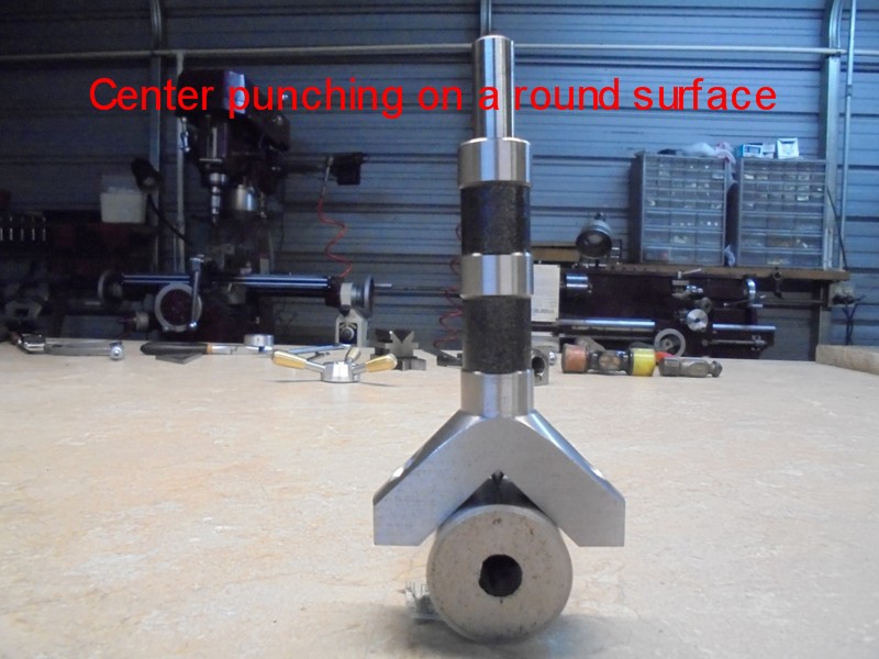

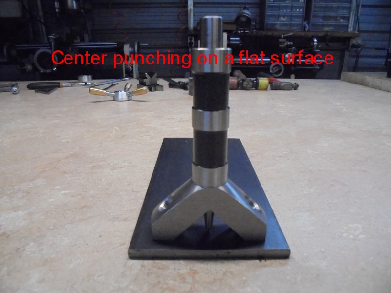

The guide was designed to work on either a flat or round surface, it has a two inch wide 90° crotch in the center of the body that will locate itself on a round surface (a shaft, pipe etc) plus the crotch also acts a viewer when locating a scribe mark on a flat surface, it has a ½” viewing hole in each of the legs which makes it very easy to locate scribe marks on a flat surface.

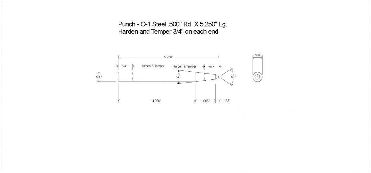

The punch was made from a piece of .500” Round by 5 ¼” Long O-1 tool steel hardened and tempered ¾” on each end, the end of the punch is machined at a 60° angle and a steep 14° angle from the end of the 60° point which gives allot of clearance for viewing and locating the point on your work piece.

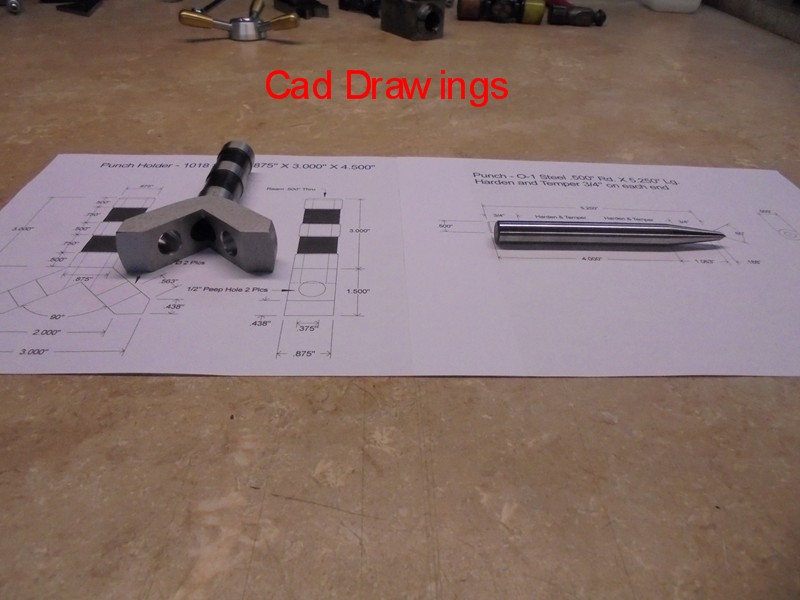

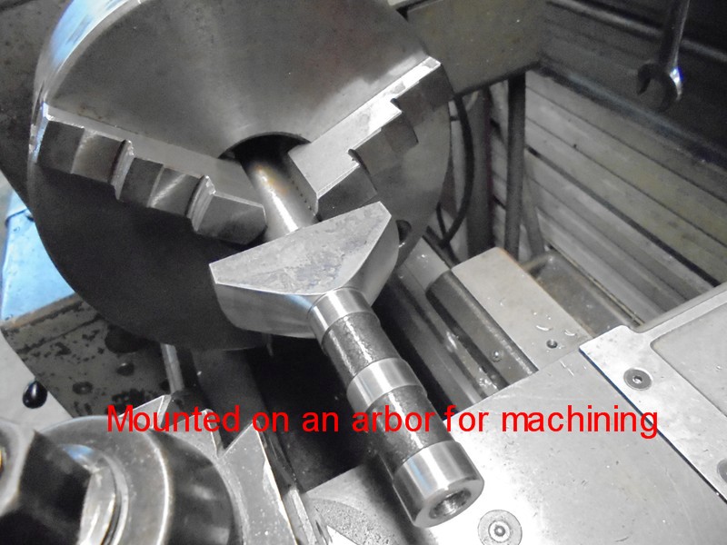

Below you will see some photos of the machining process along with the tool being used on a flat and round surface; I have also included drawings for anyone who wants to make one of these tools.
As always thanks for looking

Attachment 18918
Finished punch

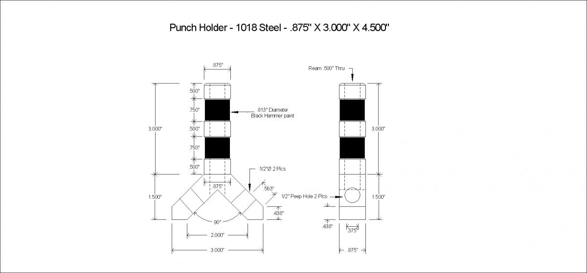

Attachment 18919
Drawings

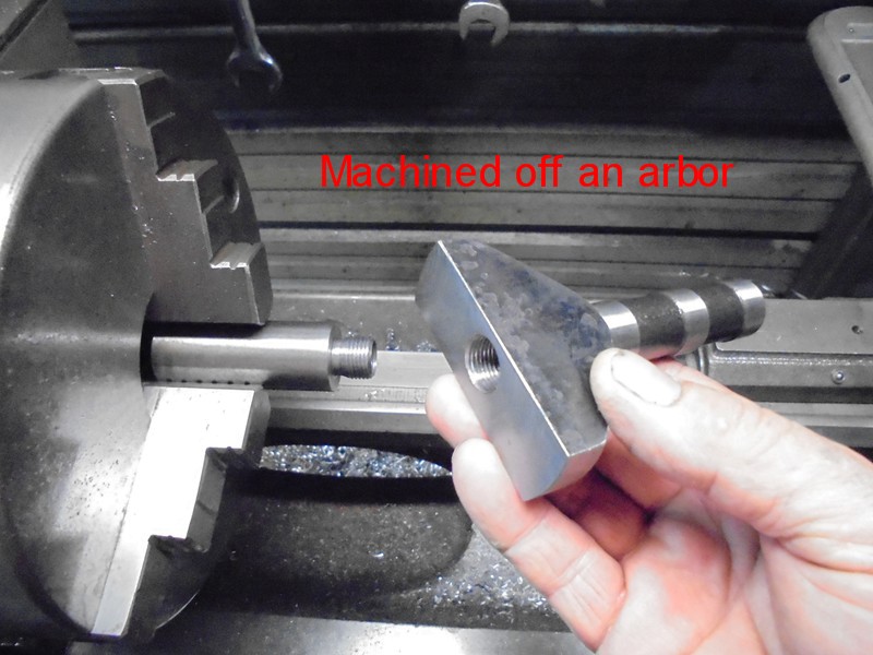

Attachment 18920
How it was machined
Attachment 18921
Machining from an arbor
Attachment 18922
A view of completed punch assembly
Attachment 18923
Top view
Attachment 18924
Used on a round surface
Attachment 18925
Used on a flat surface

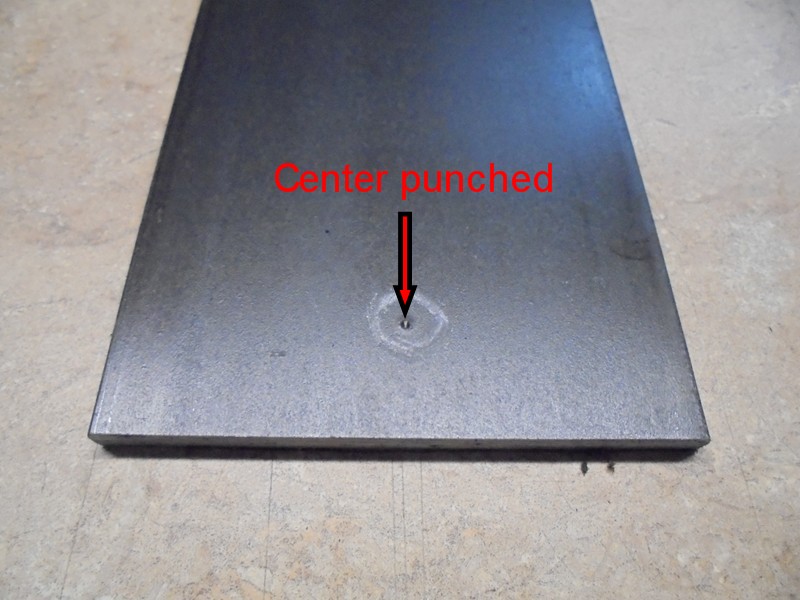

Attachment 18926
A center punch mark
Attachment 18927
Drawing 1
Attachment 18928
Drawing 2
This is again an excellent and very precisely done job as every other job you did and posted here. Thanks for sharing. The only observation is regarding tip angle of 60 degrees, which according to some people is not wide enough to guide drill bit to start hole right in the centre. I had that discussion several times with couple of very good machinists and engineers and most of them are claiming that center punch angle tip should be 90 degrees. I was using numerous fuel injector needles with different tip angle as center punches and I was very happy with all of them. But actually whenever I see original center punch, the tip angle is 90 degrees or very close to it.

The reason for the 60° point is for visual purposes, that little bit of angle difference greatly increases the visual of locating the point of the center punch, I have always used a small pilot drill of no more than 3/32" to start with, then open the hole in increments to the final size, I am very aware of the proper 90° for a common center punches, even the common hand held center punches I have also have a steeper angle than 90° for that visual purpose, I agree that if someone wanted started with a 1/2" bit would create a walking problem.
