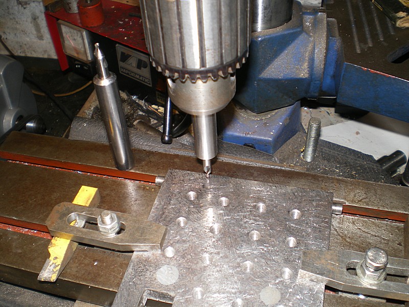

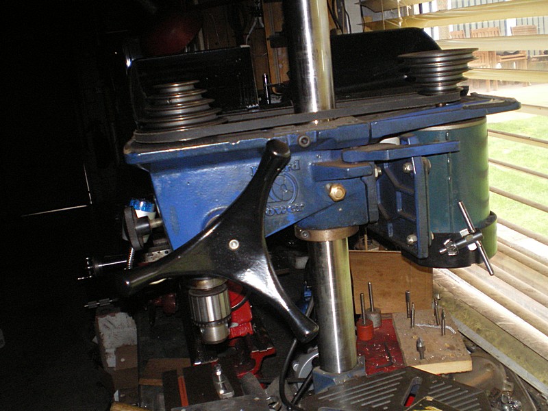

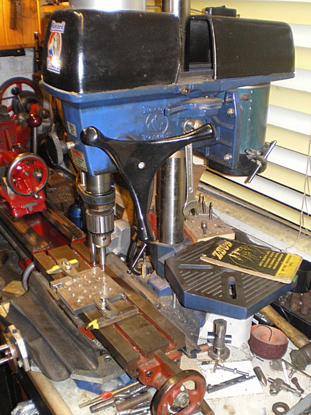

Very simple to do on my press as the only thing I needed modify was the belt guard by cutting away a portion to allow it to still flip for a speed change.
I have made a security column stop collar which is vital for a controlled decent and the column is now a solid one to replace the flimsy thin walled tube of the original.
There is little point in doing all this unless one is using an XY table which is why I have not posted the mods as everyone seems to have a mill these days. I have replaced the clamping set screw for a bolt for easier access.
Attachment 22728
