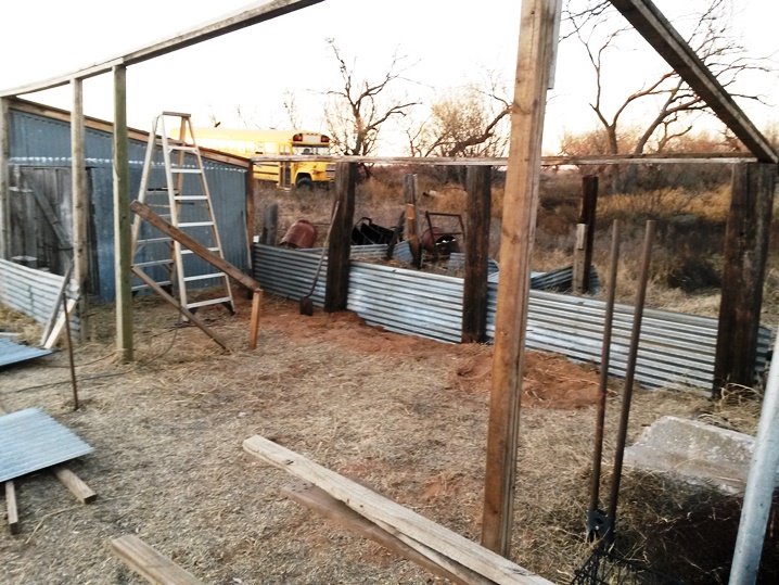

Already having a nice sized chicken coop but also having a broken down pen I decided it was high time to get ready a batch of spring chicks.
The coop on the left is 10 ft by 10 ft the pen used to be 10 by 20 but 90° to the coop and almost completely down. I made it 10 by 22 in line with the pen so Icould take advantage of constructing a wind wall to block the North wind
Attachment 20908

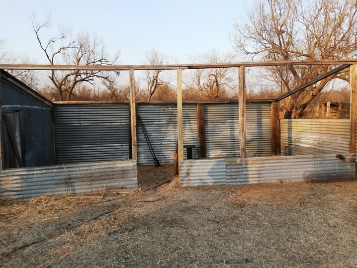

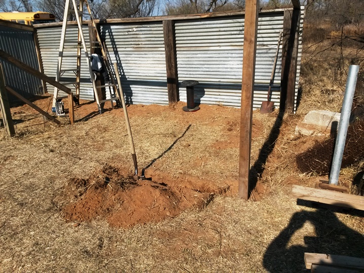

The structure is made from solid RR cross ties in the rear and 4x4 posts in the front all posts are at least 3 ft in the ground. The top rails are 2x4's screwed together to make 4x4's All sheet metal is nailed on with 2" galvanized roofing nails in every corrugation
Attachment 20909

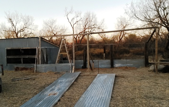

I used 3 boards to hold up th etop sheet while I nailed it to the cross tie posts
Attachment 20910

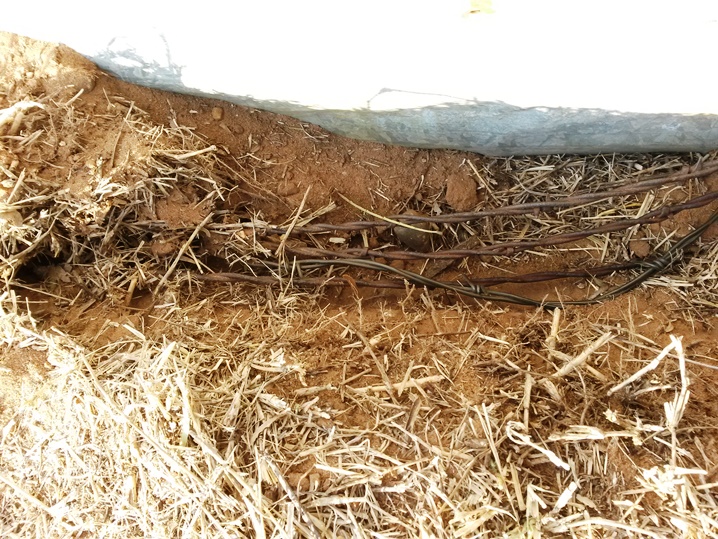

All around the pen I embedded sheet metal a foot deep in the ground and added 4 strands of barbed wire in the trench

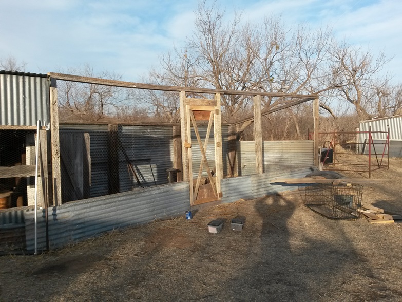

The scructure is finished all that i slacking is the door and the wire mesh and of course the chickens.
