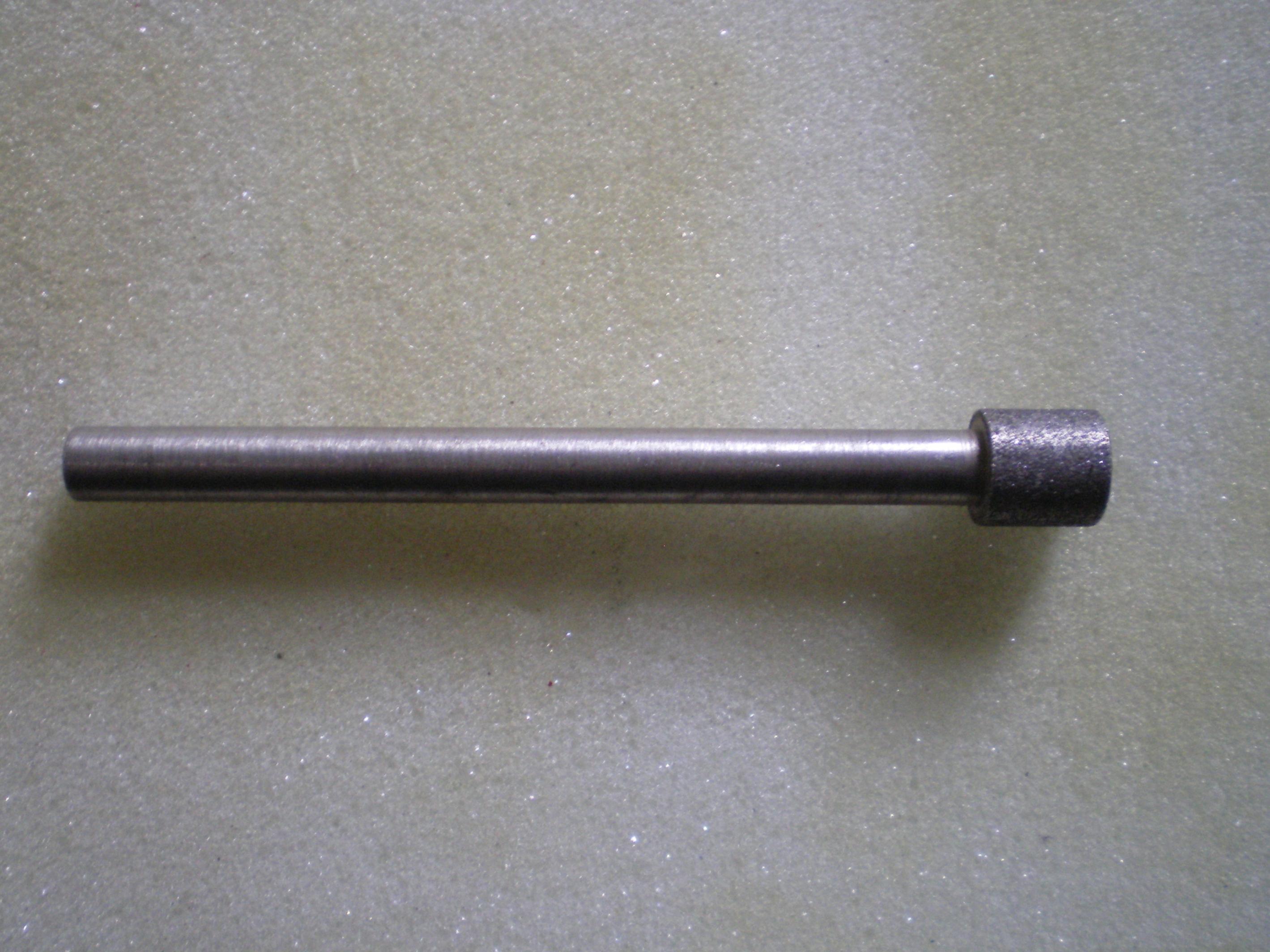

    Olderdan can you tell me what would be an appropriate rotary tool bit for truing the jaws with? Abrasive, carbide burr? I'm finally to the point with things to make the ring and think my Foredom mounted in sturdy mount would be able to do the job as it's the heavy duty model. It can mount a 1/4" shank, so I'm trying to figure what bit I'd need to do the cutting with.
    I also assume after the Chuck is trued, it should be disassembled and completely cleaned, no?
    Hi C-Bag
    I start with saying that I avoid using the lathe for grinding if poss, having said that it is sometimes the only option.
    The main enemy is loose wheel grit which is unavoidable as grit wheels are designed to shed the blunt particles to keep working and then there is wheel dressing to cope with.
    My preference is a diamond coated wheel known as Speed pins in the UK these do not create loose grit and do not need dressing.
    They will also cut hardened tool steel and have a good shelf life if not pushed to hard and with a vacuum dust is minimal.
    The 1/4 shank one pictured should ideally run at about 25,000 rpm, my spindle only reaches 7,000 but still seems to do the job, chuck speed about 50 rpm and slow traverse in and out until it stops cutting.
    And yes cover everything (spray oiled newspaper) and as you say strip and clean afterwards.
    Hope this helps.

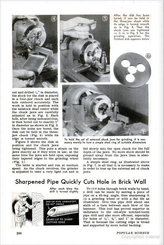

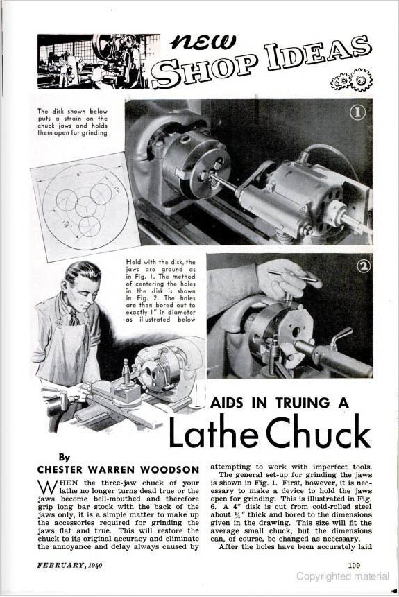

    Aid to trueiing a chuck.
    Here's something from 'Popular Science'. There was a post recently by someone who suggested using a ring cut from pipe set on the outside of the jaws and the jaws wound out which I think would allow the backlash in the scroll to introduce inaccuracy. This works for me.

    Quote Originally Posted by NortonDommi View Post
ID:	17893Click image for larger version.
    Funny that's the very article I used to make mine several years ago! Works a dream holding the tips of the jaws bell mouthed the way most wear is on older chucks!
