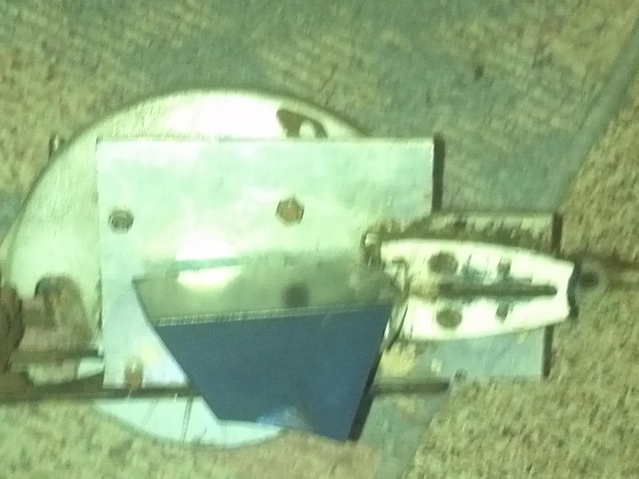

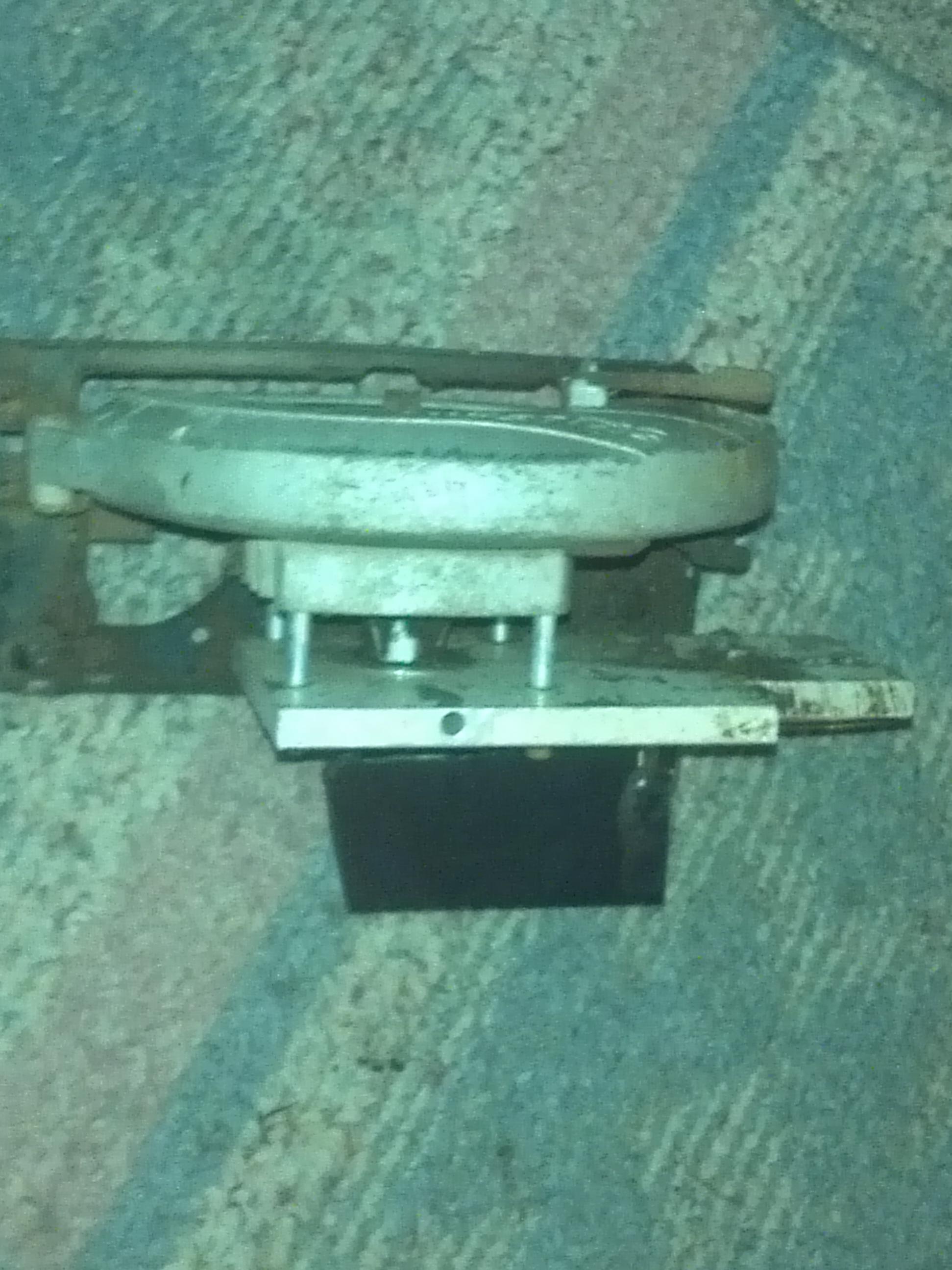

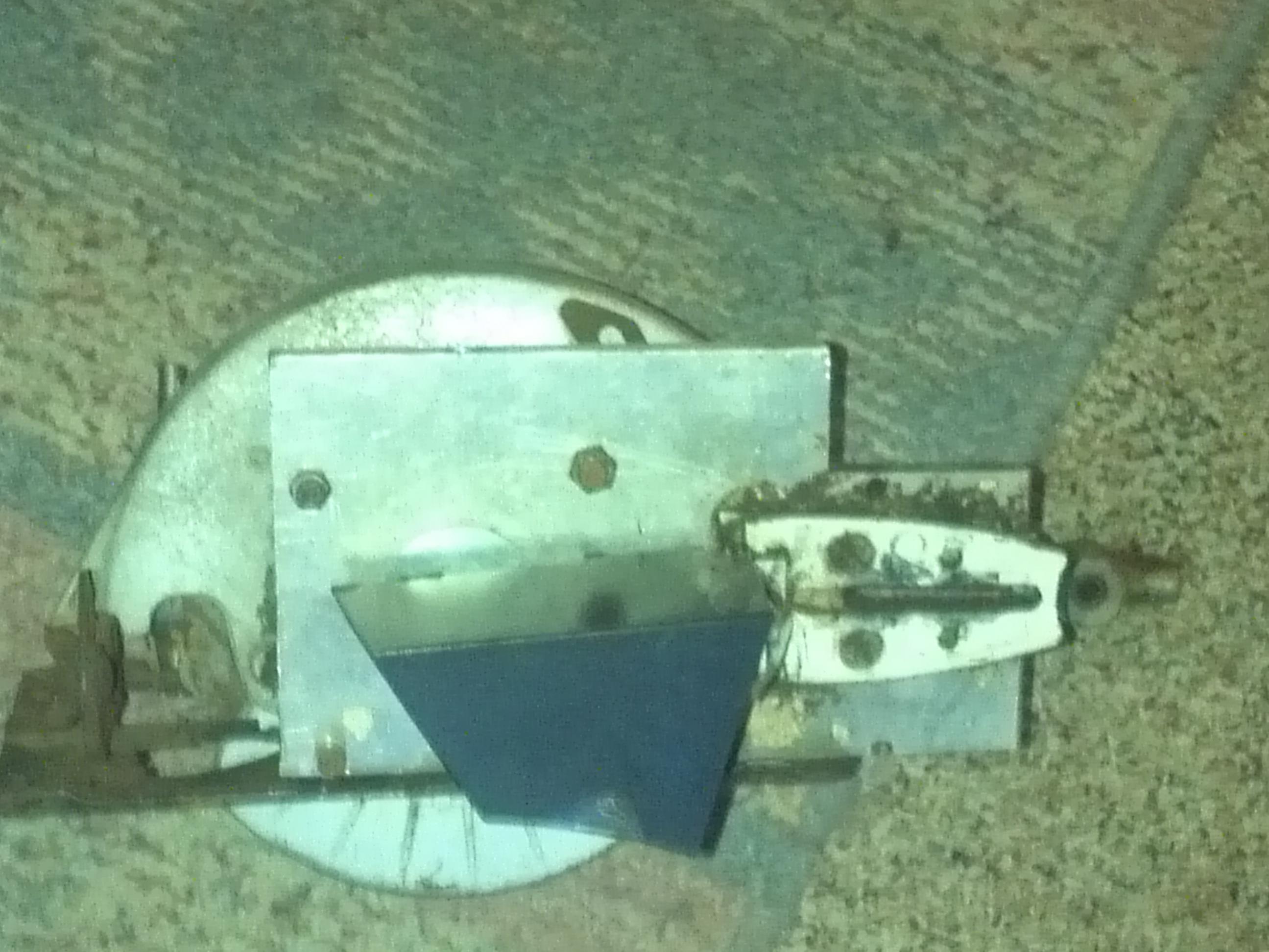

    Wink circular saw attachment for chainsaws
    • top view
    • side view
    Simple attachment that does not require permanent alterations to chain saw, and attaches as easily as changing the bar. these are without saw I would like to point out that this version requires the removal of or disabling of chain brake safety features and that circular saw is lacking safety features. Universal fit works on all chain saws WITH SAFETY BRAKE LOCATED IN THE SIDE COVER. More photos soon
    Newer version coming soon that will work on new chainsaws
    Attached Thumbnails Attached Thumbnails circular saw attachment for chainsaws-img_20160329_132736.jpg

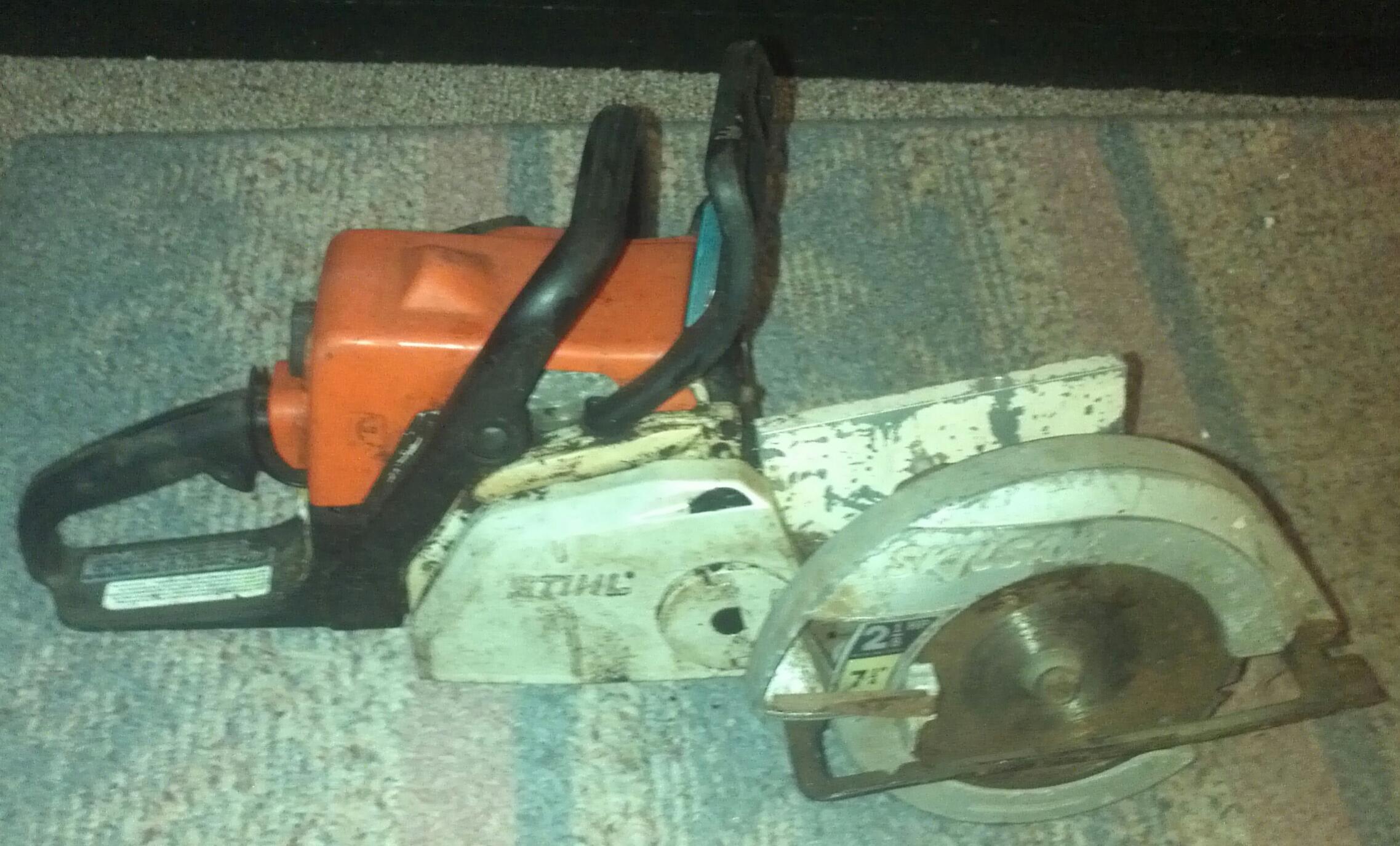

    Here is the updated version, change the base plate, added base plate gasket, added adjustable tensioner, modified the input shaft to ease sprocket change.
    I threw it on my 018 and the balance, stability, and ability to keep strait cuts is comparable to a conventional circular saw. It now has the added safety of the chain break, and will fit most new small to mid sized chain saws.
