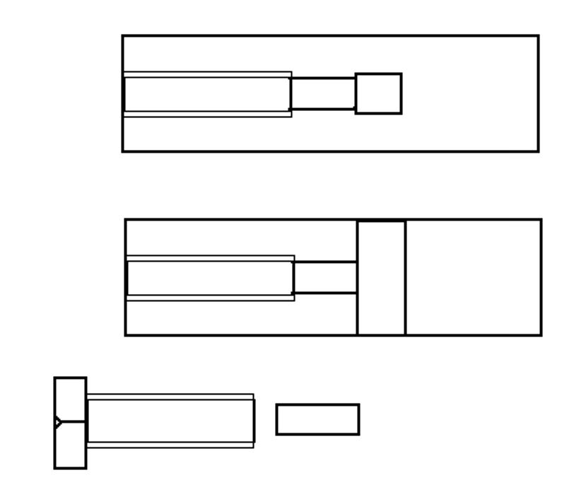

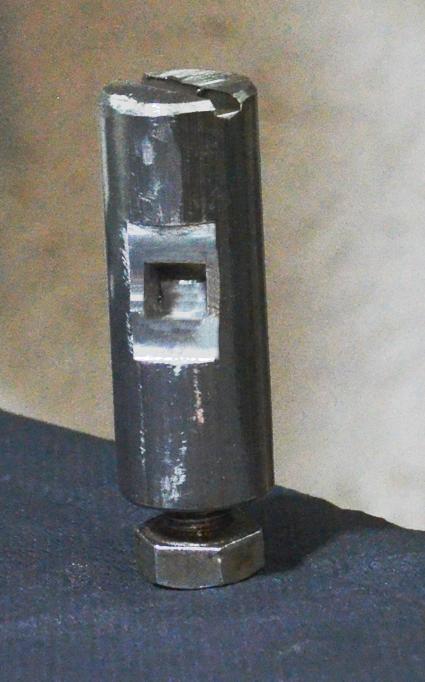

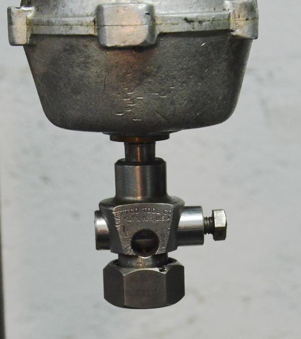

    Thanks to your pix and description I was inspired to make a positive drive on the tap squares. i didn't attempt to copy the stock setup that you have and I went for a very simple to make implementation.
    1/4" is the largest square that I have measured on my 8 mm and smaller taps, so I broached a 1/4" square cross hole in a loose fitting bar. From one end I drilled a hole to take a plug that will bare on one side of the square clamping the tap end. I tapped the outer portion of the plug hole for a clamping bolt to push on the plug.
    Clamp key and catch bar for Pollard tapping head-tapping-head-03.jpg Click thumbnails for full size.
    Sketch showing the pieces.
    Clamp key and catch bar for Pollard tapping head-tapping-head-01.jpg Clamp key and catch bar for Pollard tapping head-tapping-head-02.jpg
    Photos of the actual implementation.
    As the bar is a loose fit in the tapping head it will self centre on the tap square but still provide a positive drive.
