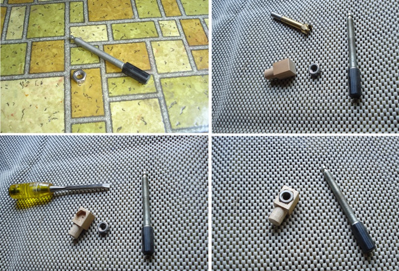

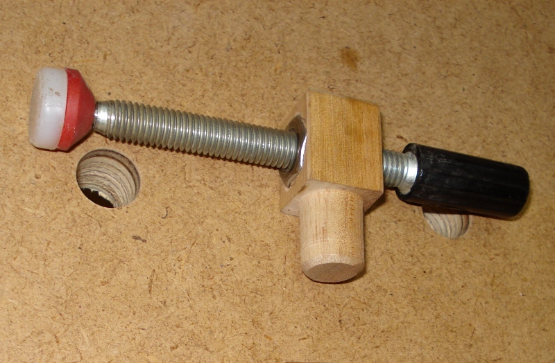

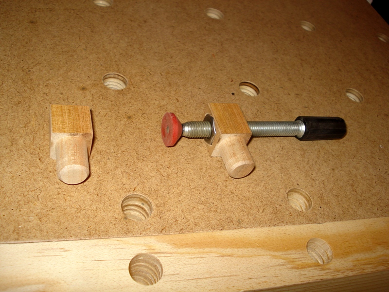

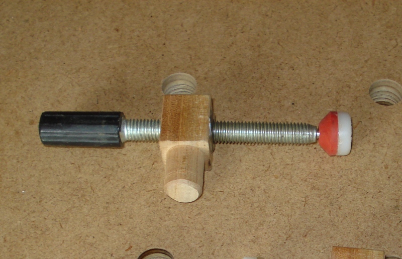

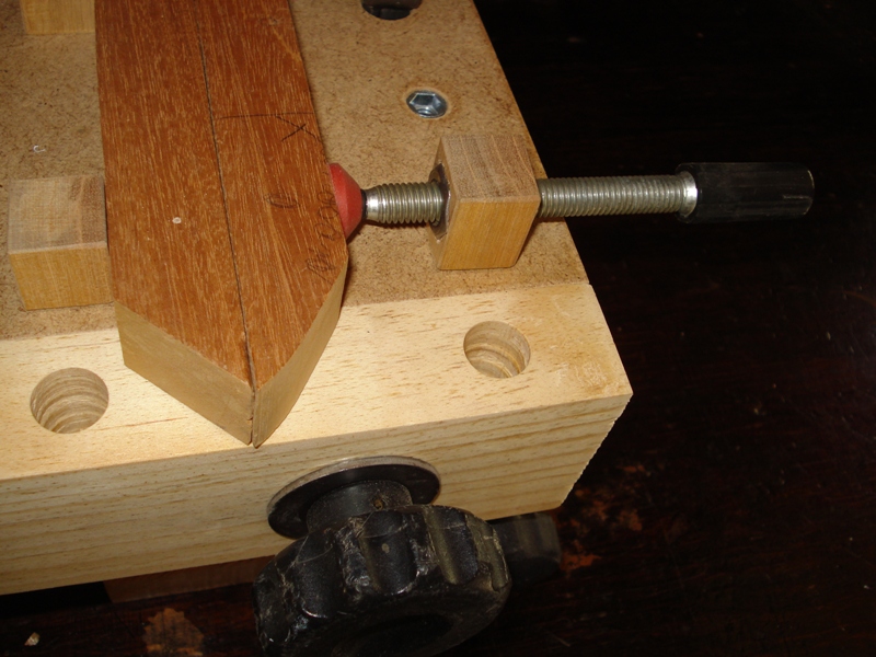

By using bench dogs (http://www.homemadetools.net/forum/b...op-bench-53444) in the http://www.homemadetools.net/forum/b...xon-vise-53325, it is possible to clamp work pieces in one direction, but for clamping in other directions or odd shapes it is necessary to use other clamping devices.
By adding a screw and a nut to a bench dog, you have a clamp which is very useful in this bench or in the workbench.
Attachment 14760
Attachment 14762
Attachment 14761
Attachment 14763
Attachment 14764
Regards. morsa.
Now that's a good idea...hadn't thought of it or seen it before. Simple, Elegant and good sheer strength! Thanks Morsa! ~PJ

Two last images show, at the tip of the screw, a faucet beveled washer (red), and a nylon cap (white) from reused nylon glides, glued with epoxy resin. This nylon tip does not mar the wood, and the screw turns freely within this set.
Instead of an embedded nut you could use a T-nut insert.
Thanks, mklotz.
You are absolutely right. And you are a step ahead.:) With that thought, in mar-2014, I made a homemade version of the "Wonder Pup" (B in the first link), that I'll show tomorrow.
