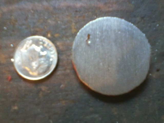

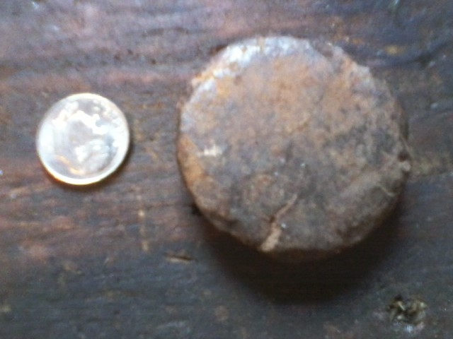

Decided it was time to clean up some mushrooms on the ends of a couple of prybars. I was going to simply grind them down but then I thought why not use my new portable bandsaw and take advantage of the new stand I made and just cut them off.
http://www.homemadetools.net/homemad...andsaw-stand-7
This is a photo of the first mushroom cap cut off
Attachment 18821
The bottom side of the cut
Attachment 18822

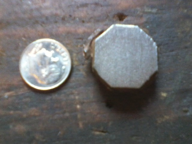

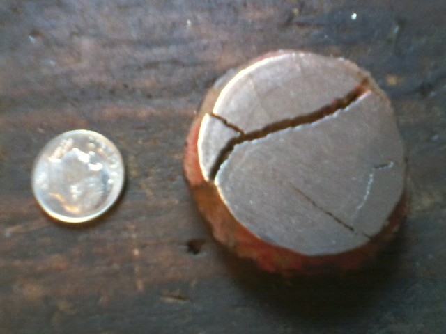

Then I went after the second mushroom cap and cut it off
Attachment 18823

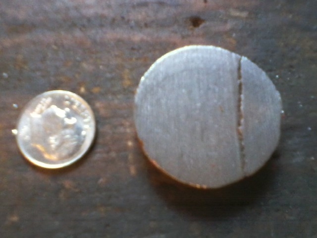

The bottom side of the cut ,,,,YIKES!
Attachment 18824

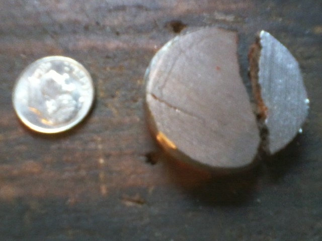

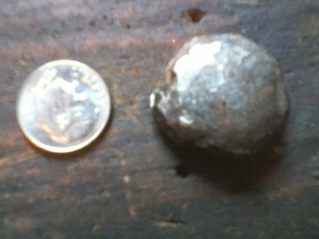

That crack was a big mess so I took off another slice which just broke apart during the cut
Attachment 18825

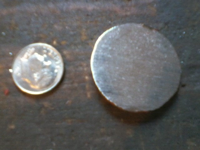

I wanted to get to the bottom of this so I took off another slice
Attachment 18826
...and another
Attachment 18827
..and one more to be sure
Attachment 18828

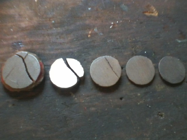

Finally, no more cracks. But it was an interesting lesson and I'm glad I decided to cut off the caps instead of grinding them down.
Here's a summary comparison
Attachment 18829
