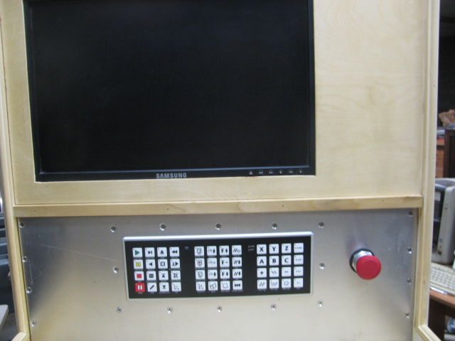

With all you've done to date with the build and wiring, you'll be fine!! :clapping: Just another learning is all and you'll benefit in the long run with more intimate knowledge when it goes into operation. Which reminds me, have you included a physical E-Stop or two? I had 3 on my machine only because it was 35' long and could be reached quickly no matter where the operator was. Also you didn't mention the brand/model of the controllers?? Happy to help if I can. ~PJ

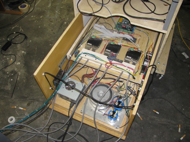

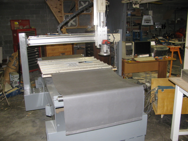

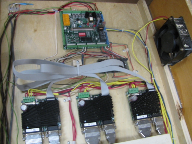

Attachment 5666Attachment 5667Attachment 5668Attachment 5669Attachment 5670The control is Mach 3, the drives are Granite VSD-E, and the pci board in the computer is Centipede and a centipede brk. board. I have installed the Centipede driver and the Mach 3 program, all of the wires are installed, so tomorrow I will start the configuration and tuning. I am a little nervous about pushing that first button, but someone has to do it. I have soft stops, limit switches and an E-stop next to the controls. I will have a million questions tomorrow, so get ready. KSI labs provided many pages of docs., geared for more experienced persons than I, but I will trudge through it. Also there are some good videos on YouTube, I will be watching them also. I am not ready to post eating popcorn yet, when I get the axis' to move, I will be devouring popcorn. Bob.
Thank you PJs. Well I got off to a rocky start. I had a neutral wire crossed with a ground wire, think I blew a capacitor in the power supply, going to replace them. I think I have it whipped now, good lights on the brk board and the servo drives. I hope that is the only mistake I've made and I will be happy. Bob.
Well, I found out that capacitors don't last long without use and since this one has sat for a few years, that might be why it failed or it was because of my crossing some wires, so I have ordered so more, will be a week or so before I get them. Bob.
Too bad about the caps. Did one or both blow - pop up the vent or swell up? Would be best to replace both in either case. Your findings about sitting cap lifetimes peaked my interest because my use and understanding is that they will typically have a lifetime service of ~150khrs (7+yrs) at max spec but should be changed at about 50-60khrs due to leakage and electrolyte & film degradation. Hi heat (above spec) will kill them faster, but never heard of sitting on a shelf too long, so I looked it up. Wiki has a bit on it but the white paper I read really talk about it. Thanks for peaking my interests and learning a bit.
I looked back at the pictures of the PS...is that homegrown? The transformer seems an odd shape- toroidal? Surprised it would take so long to get the Caps. I've used Digi-Key and Mouser for years and typically only a few days and prices are good, generally.
Overall-great progress!! Thanks for the update, look forward to seeing your machine run!! ~PJ
OK, Sergey Kabashian says that they will last for 30 years on the shelf, but try to buy one at the local distributors. I called 8, trying to find one and they all said that they don't stock them because of shelf life. In my instance, it could have been both because my project has sat since Feb. of 2012. Only one blew, the vent blew and it also swelled at the bottom. I am replacing both. I found another ground that I mixed up with the neutral, so I think I have it solved now.I have about 2 wks. to get it right. Yes, the power supply is mine from plans from KSI labs, he sent me the diagram and I bought the parts and put it together. It supplies 120VDC to the drives and servos. The caps are 4000u farads, 150 volt dc, max 200vdc. Thanks for the encouragement, I will get it right yet. Bob.

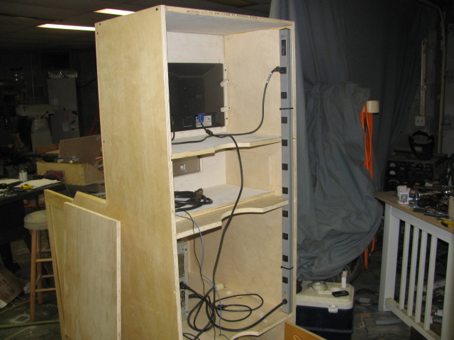

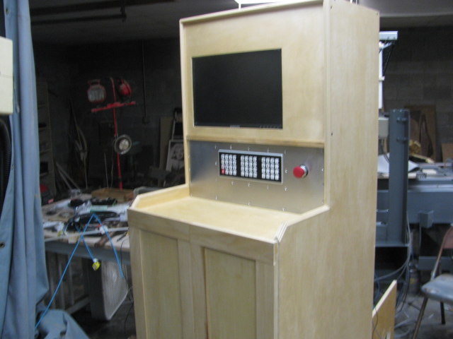

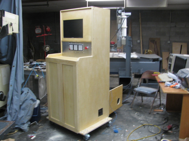

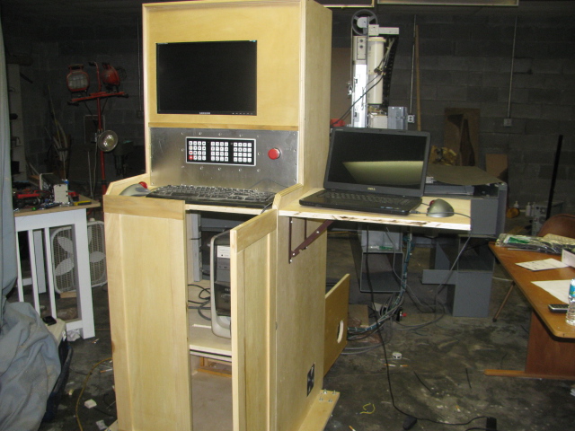

OK, I received my capacitors and installed them. Here is what happened. Too many wires. I got mixed up and twice hooked a ground wire into the neutral circuit. I found them and corrected it. I also rewired the ground system as was on the diagram. I guess you are supposed to follow the diagram. Tomorrow I will fire the whole system up, today I fired up the power supply and got 143 volts DC., with no smoke, so after going over the whole diagram tomorrow, I will again fire it up. I am confident there will be no more smoke this time. Here are some more pics. I installed a power strip so that all of the components can get power. I also added a folding shelf for my laptop. It will come in handy for videos for the tuning. This Centipede pci card is designed for Mach 3 and by reading the setup procedures, it sounds like there is no setting up. It appears that I only have to "check" the axis that I want to use and that is it. The driver knows everything else except tuning. I am not running "home", so I don't "check that, but I will be checking "limits". If anyone out there has setup Centipede, let me know. I setup a wifi extender so that I could have wifi out in the garage and it works fine, spent 40 bucks on it, a Belkin, just plug it in to a wall outlet, and of course the security code. Bob.Attachment 5794Attachment 5795Attachment 5796
Fingers Crossed and wish you smooth sailing on your startup! Nice shelf on your workstation.
