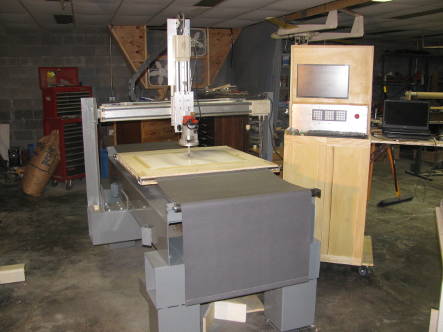

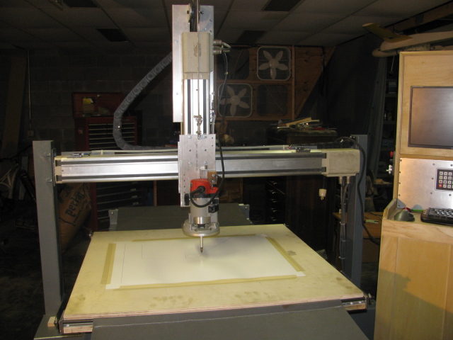

Thanks everyone for your patience and kind words. I thought that I would post a couple of final pictures of the router and controls, now that it is finished, here they are, Bob.Attachment 6805Attachment 6806
