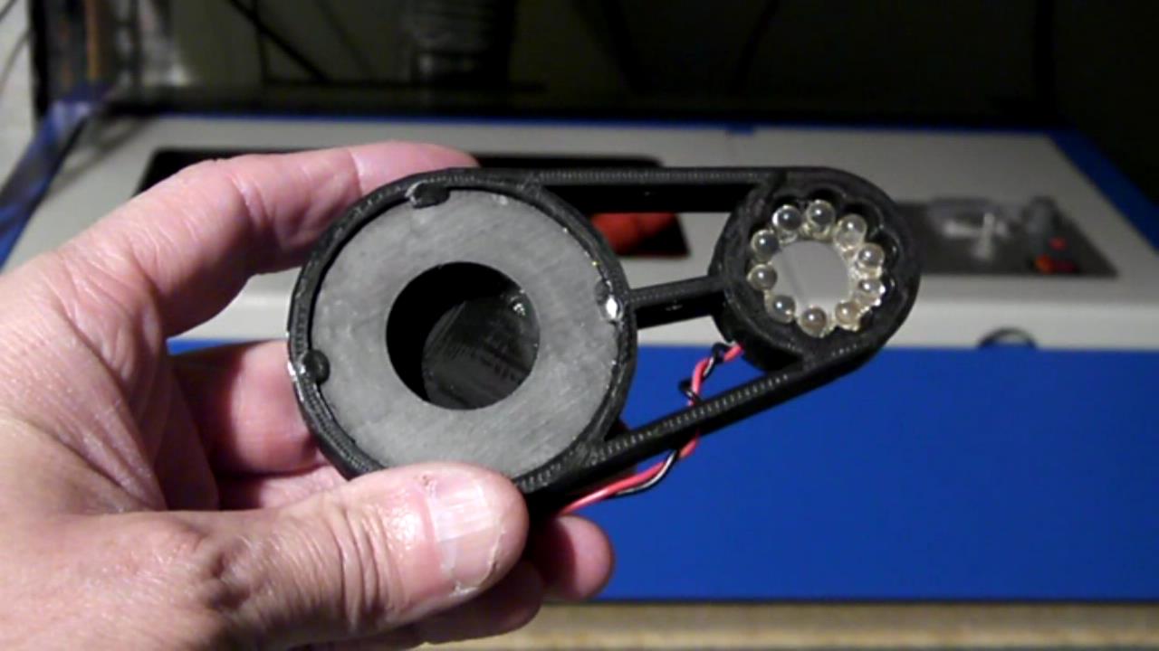

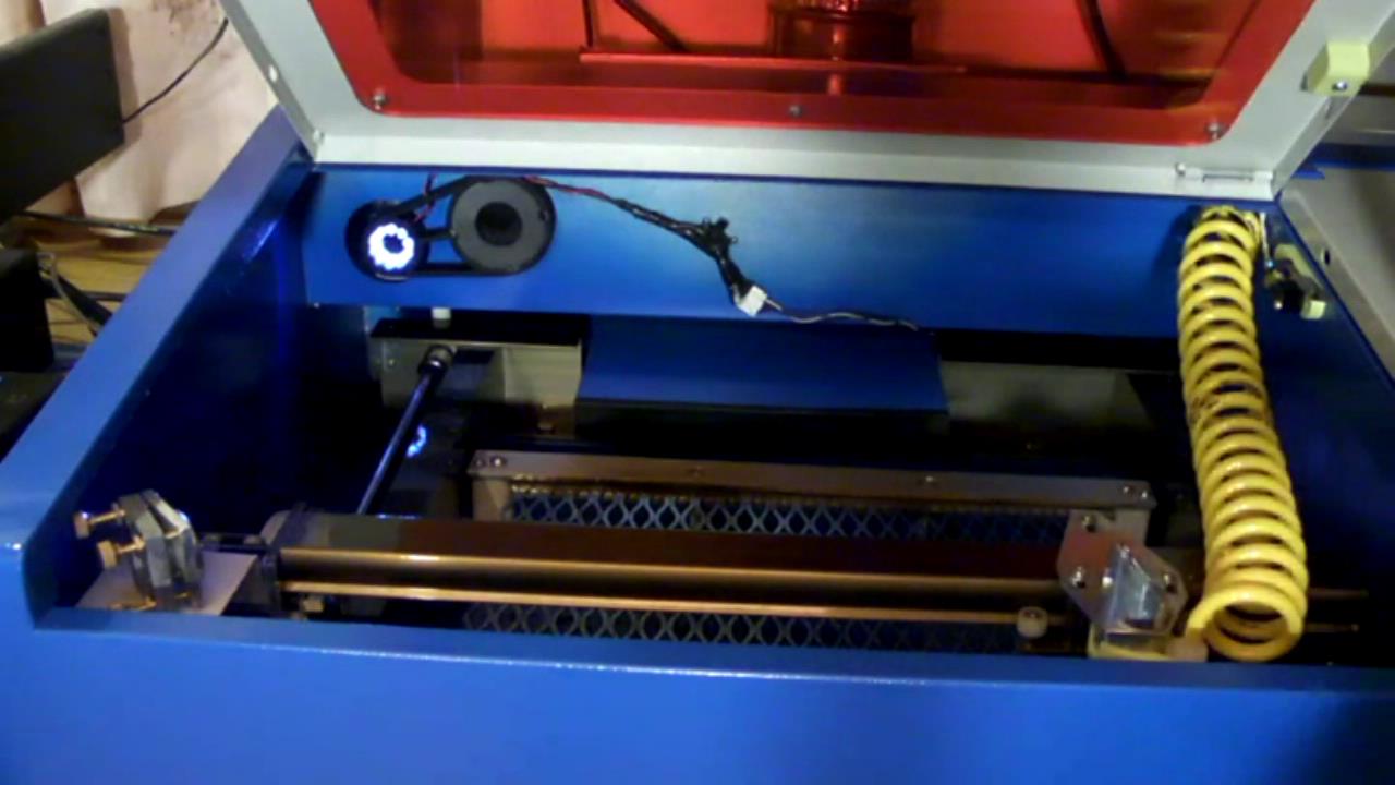

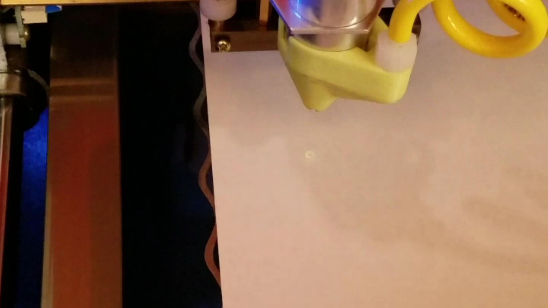

This is a bracket used to hold a ring of LEDs used to produce a visual indication of the position of a CO2 laser focusing lens. The design allows for simultaneous use of the position indicator LED ring and the laser. The position indicator is constructed from an old LED flashlight, magnet from a microwave oven (magnatron), an old cell phone charger and a 3D printed bracket.
