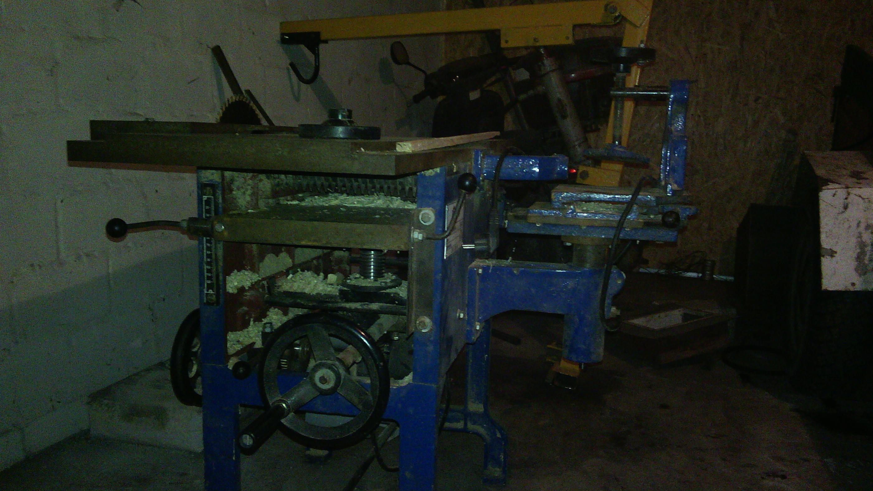

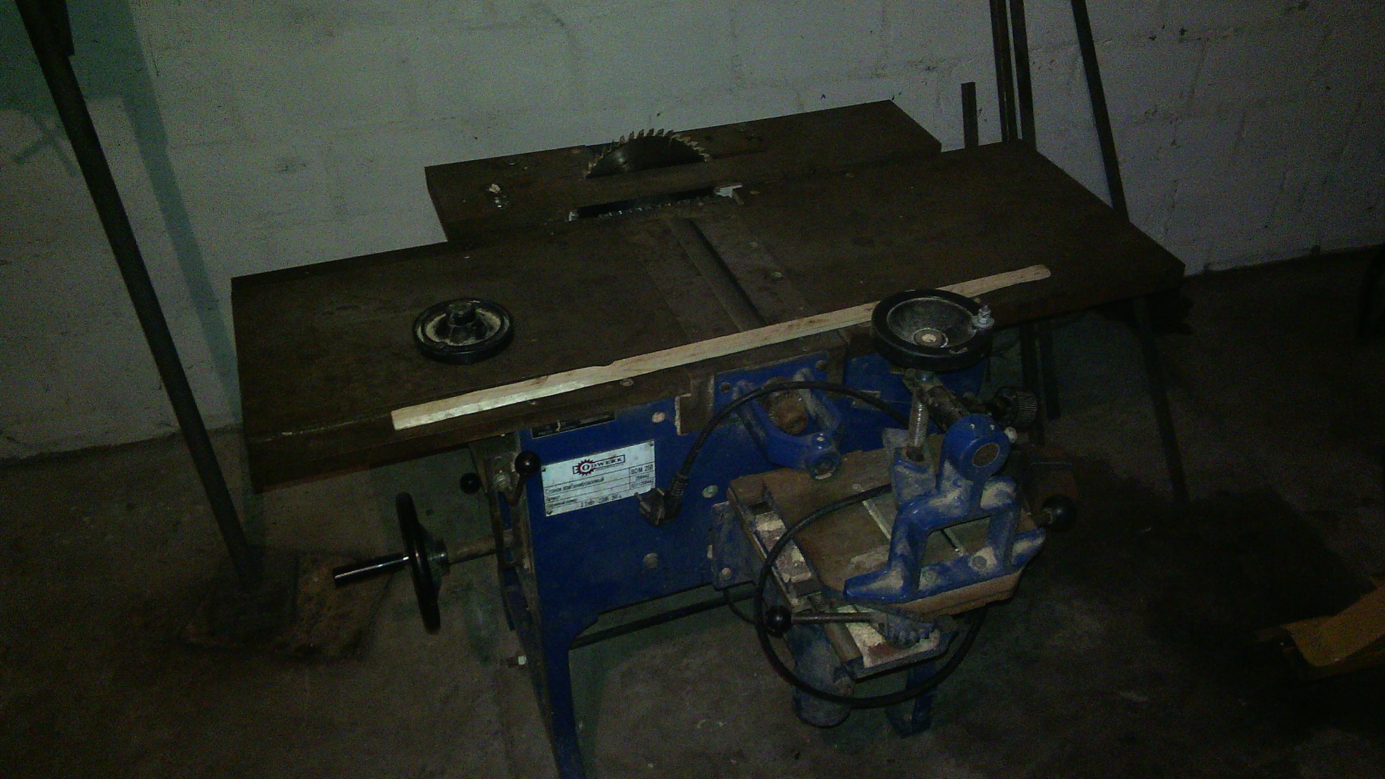

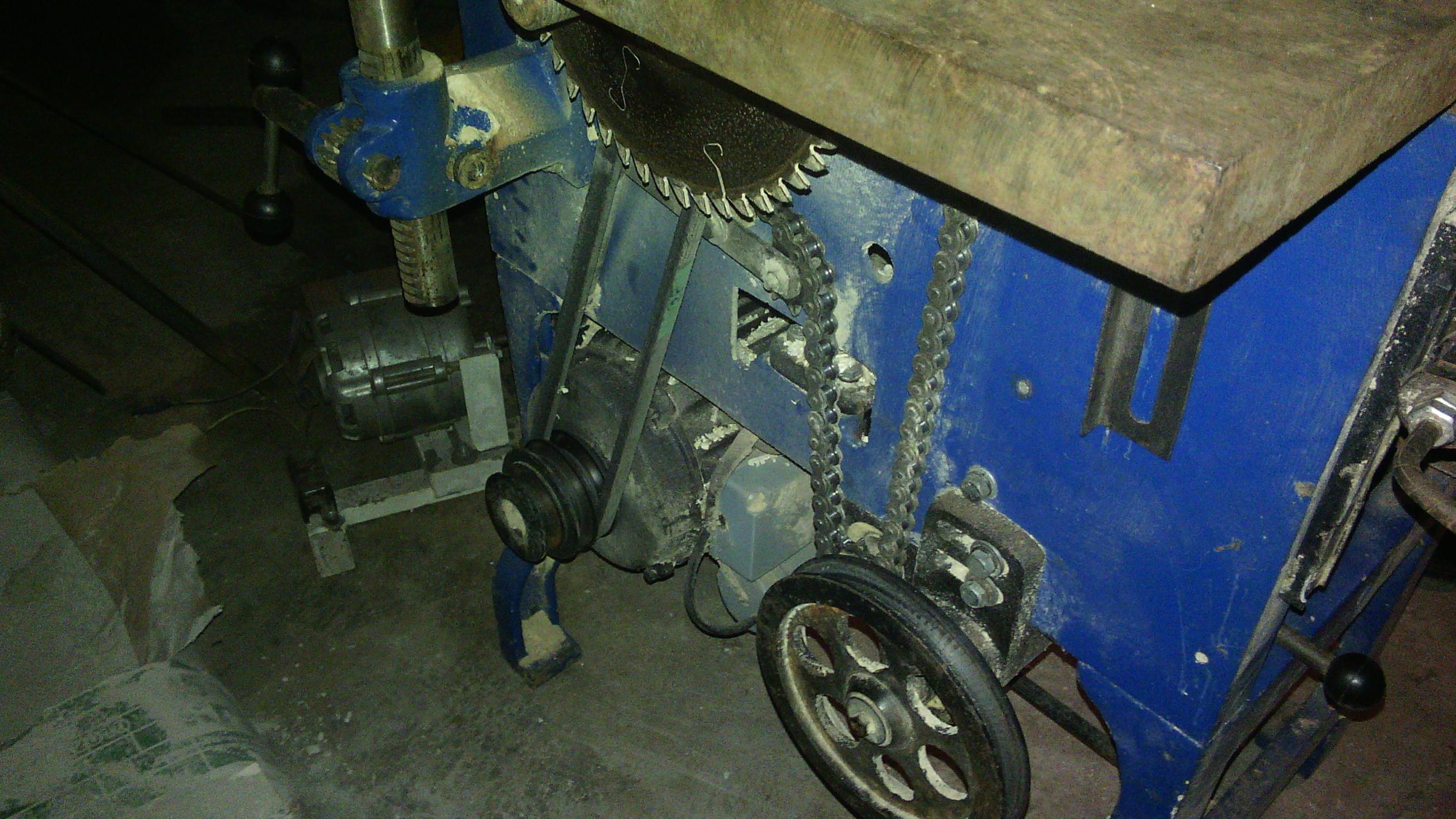

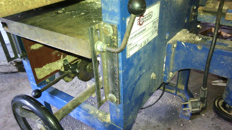

    Hello. My friend asked me for help. It has a woodworking machine and want to upgrade, a small table and rigidity this major shortcomings
    Combined Woodworking Machine-img_20170405_205424.jpg Combined Woodworking Machine-img_20170405_205442.jpg Combined Woodworking Machine-img_20170405_205454.jpg Combined Woodworking Machine-img_20170405_205513.jpg

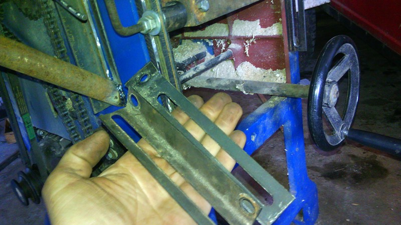

    This standard clamps table, made of cans 1.5 mm and is very easy to bend by hand. So when work is much backlash, stiffness very bad.
    So I made the tough new clamps

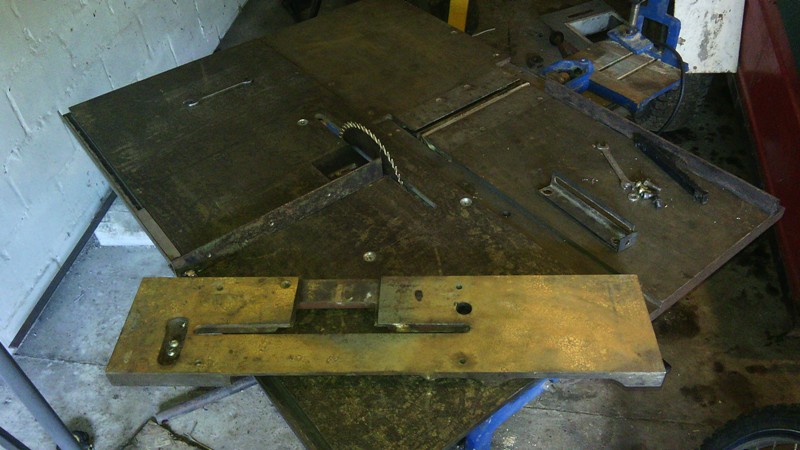

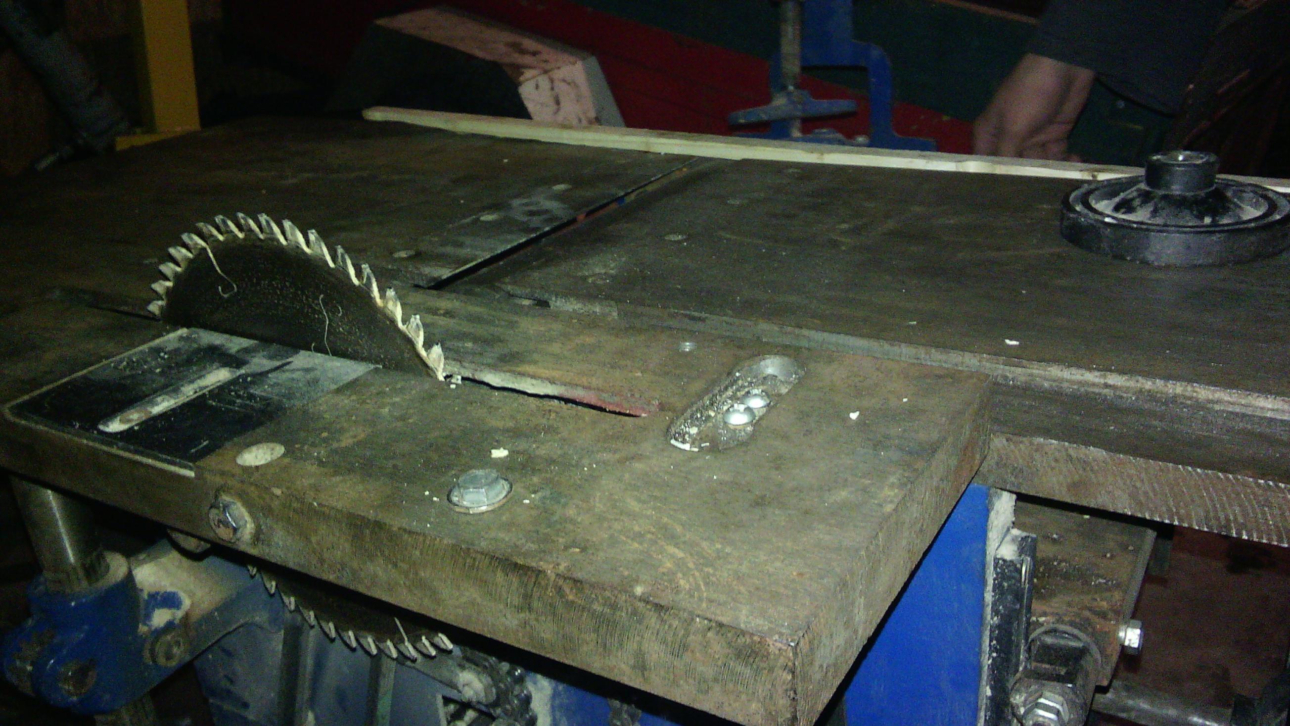

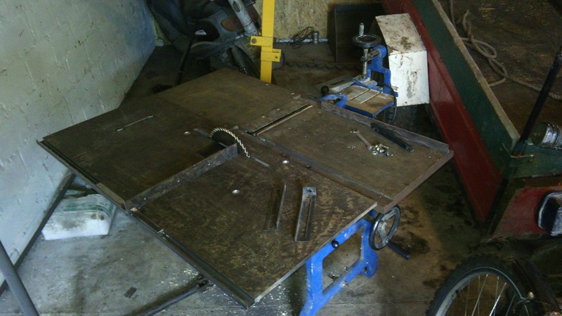

    Also made new table of sheet metal 10 mm size 400x1000mm
    Combined Woodworking Machine-img_20170412_160730.jpg Combined Woodworking Machine-img_20170412_160954.jpg
