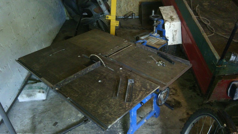

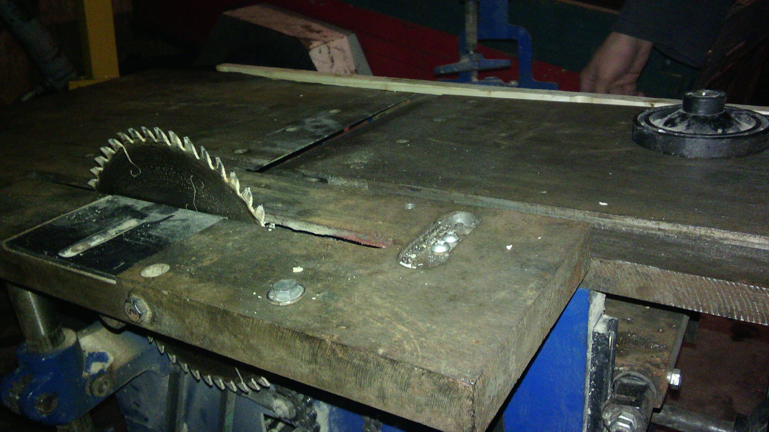

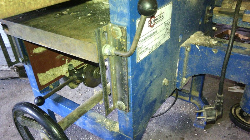

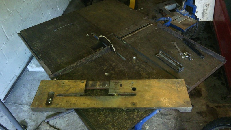

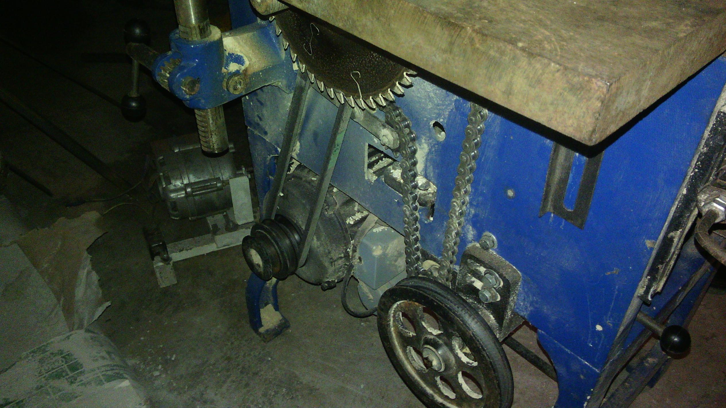

Hello. My friend asked me for help. It has a woodworking machine and want to upgrade, a small table and rigidity this major shortcomings

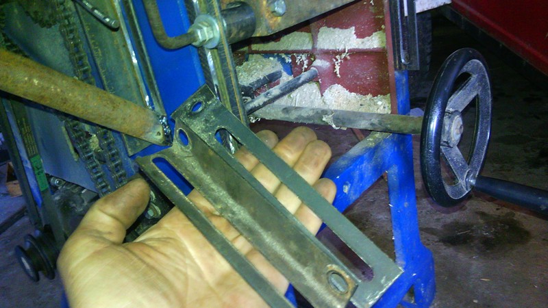

Attachment 17435 Attachment 17436 Attachment 17437 Attachment 17438
This standard clamps table, made of cans 1.5 mm and is very easy to bend by hand. So when work is much backlash, stiffness very bad.

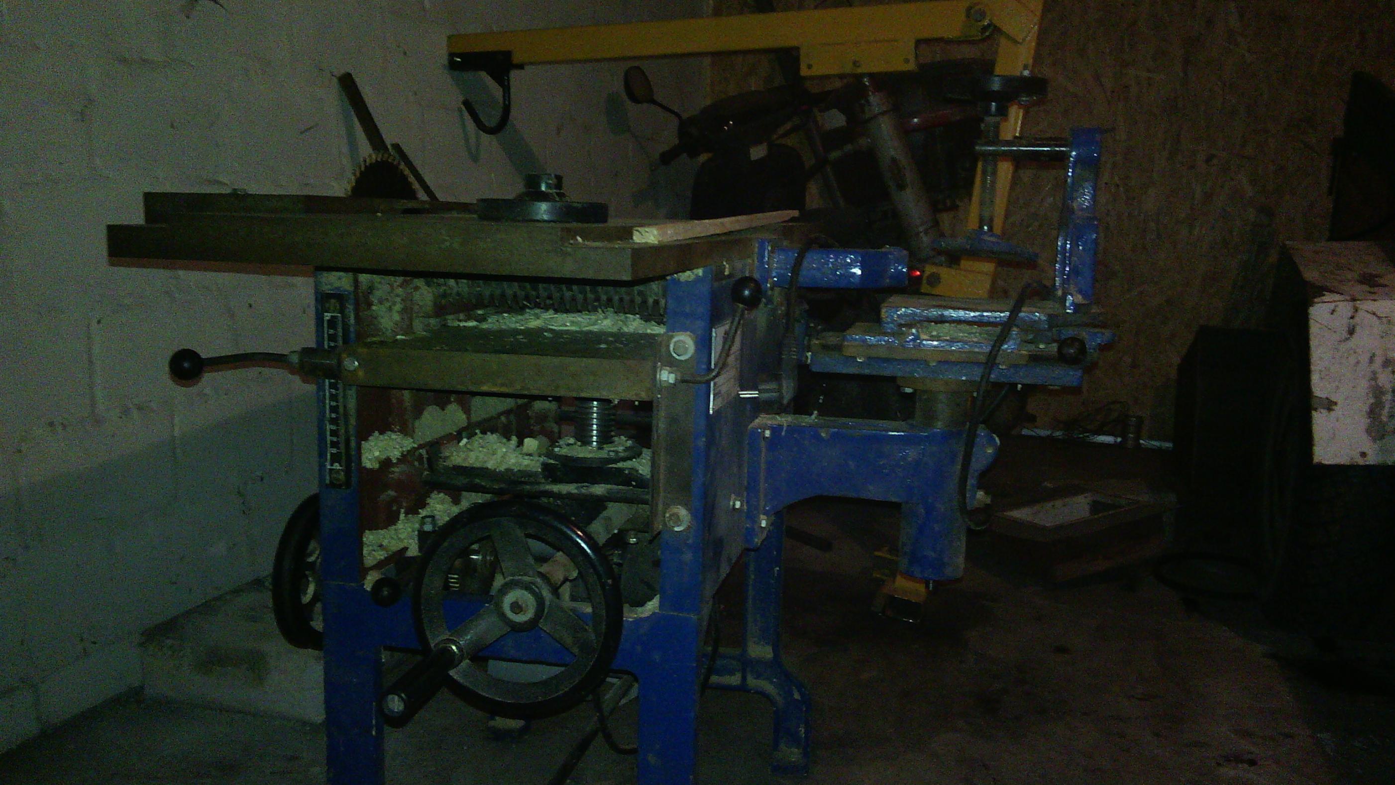

Attachment 17439
So I made the tough new clamps

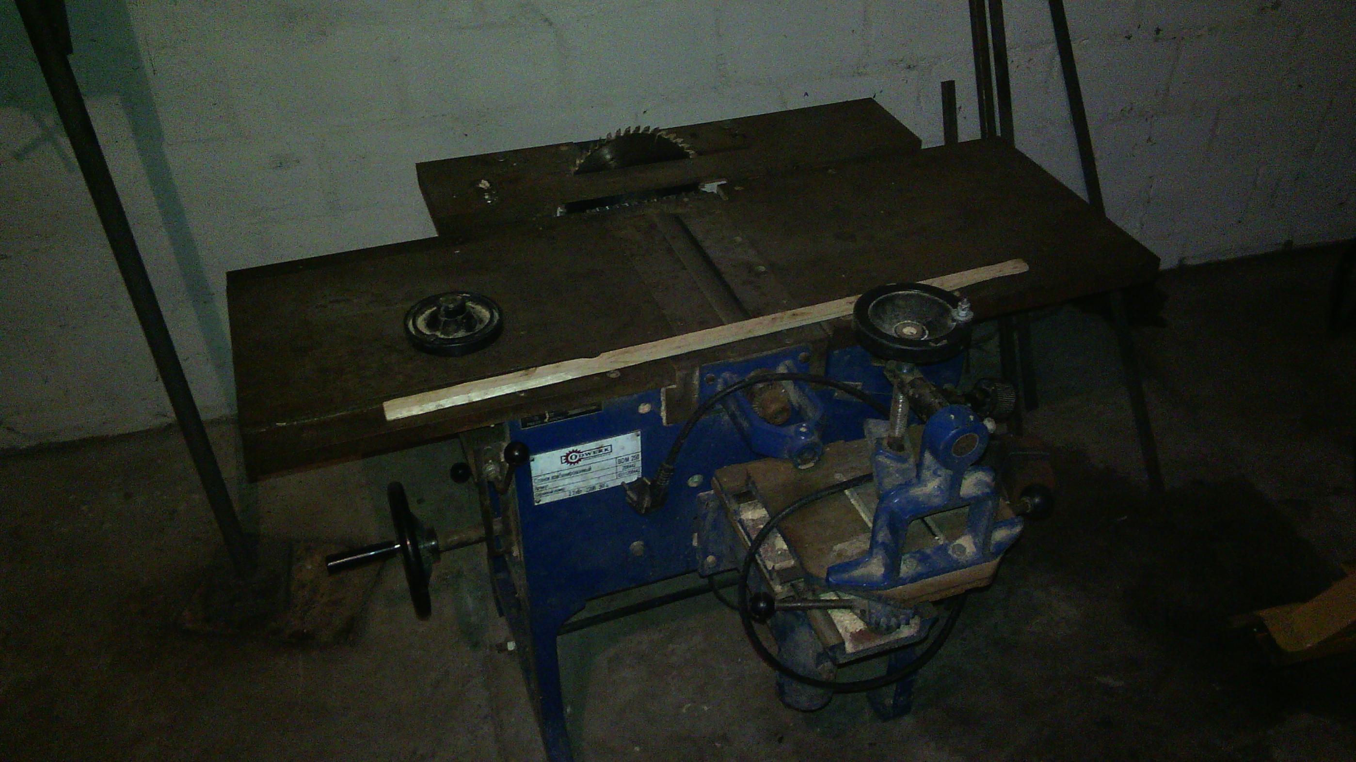

Attachment 17440
Also made new table of sheet metal 10 mm size 400x1000mm
