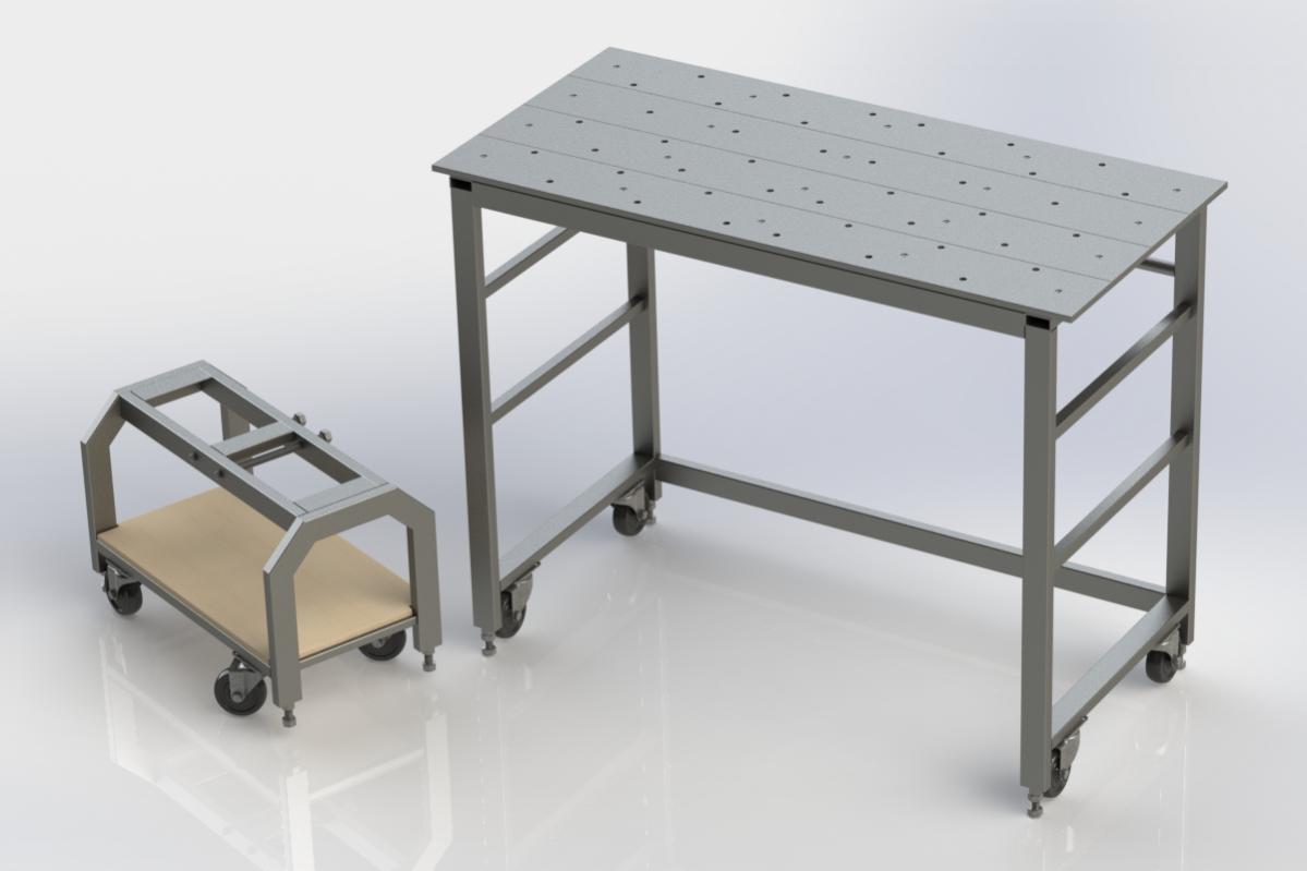

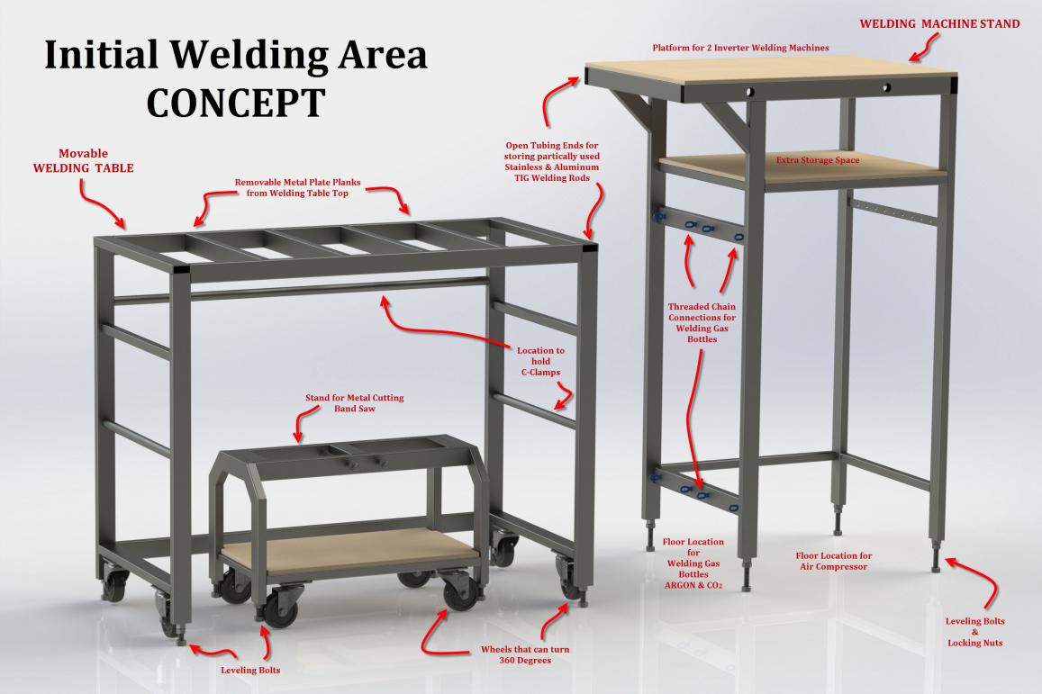

Decided to design a welding area for my home workshop, but didn't have a lot of space.
Attachment 1132

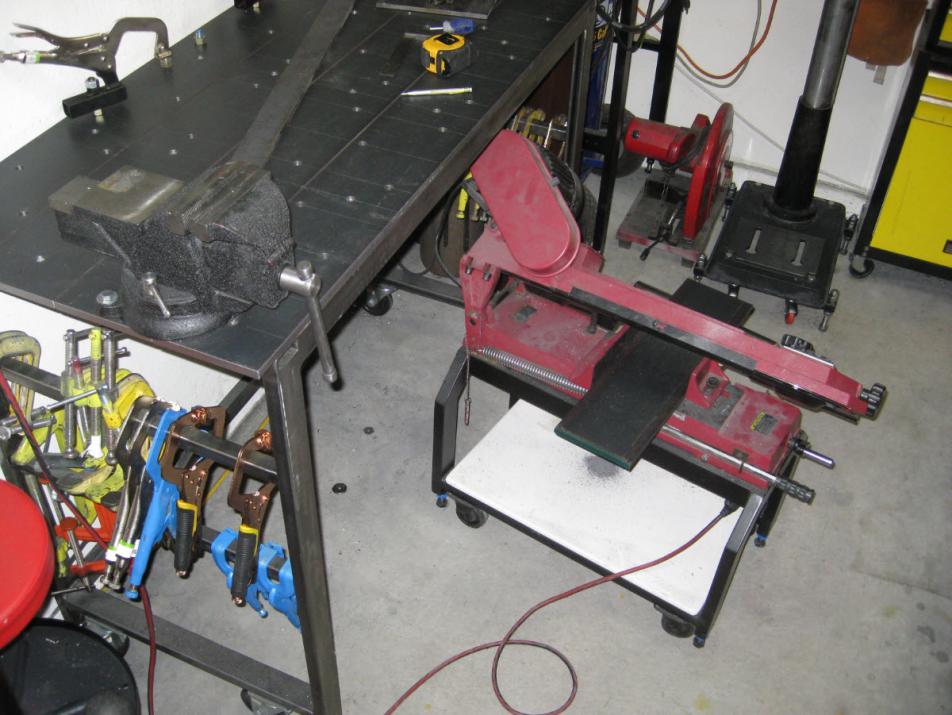

Wanted the welding table to be strong enough to be functional when welding heavy items; yet, also movable and as compact as possible to save space.
Attachment 1133

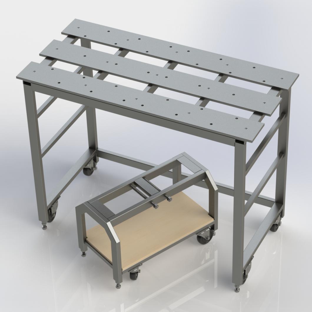

I needed a welding table that would fit over the top of my metal band saw and used that as a basis to draw these concept renderings in SolidWorks CAD software.
Attachment 1134

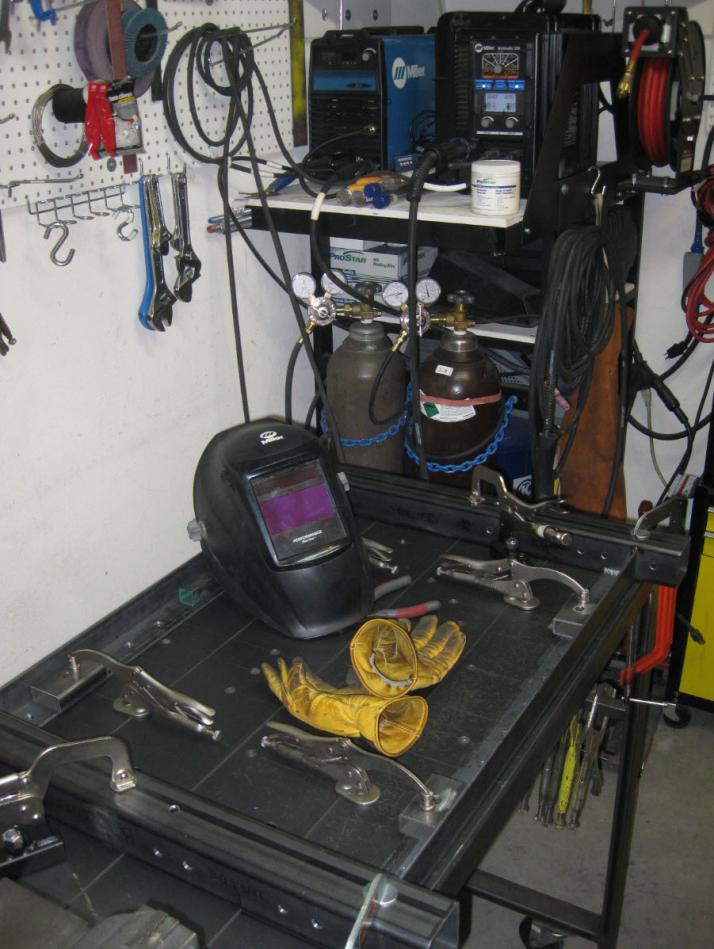

Also wanted to be able to remove the 1/2″ thick metal flat-bar table top planks and re-position them to allow for easier clamping of specific welding projects.
Attachment 1135

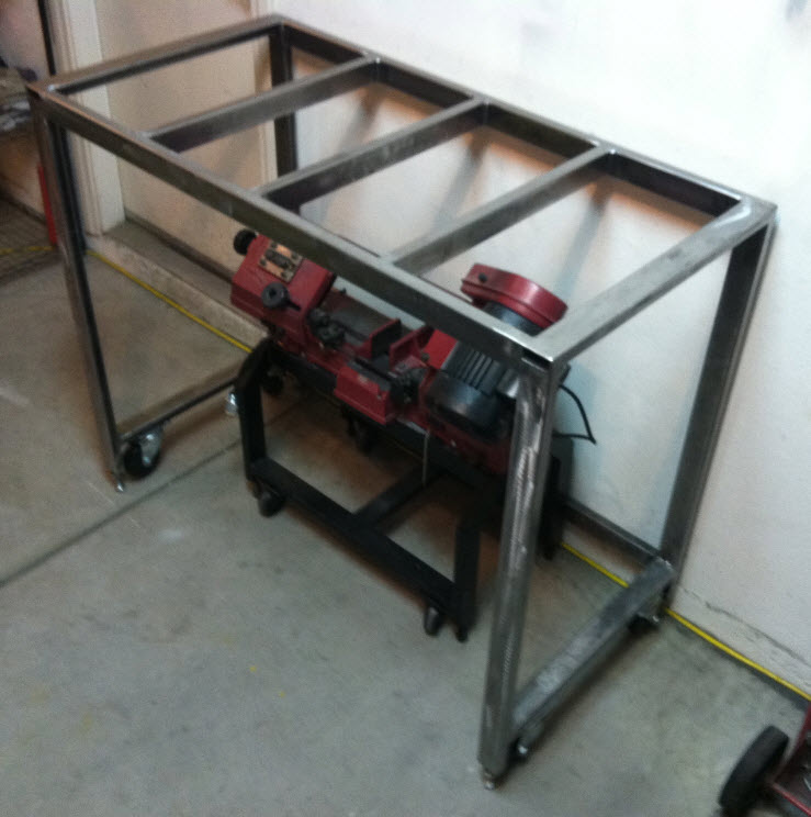

When fabricating the 52" x 24" welding table I left some of the steel tubing ends open to allow a place to put partially used Stainless Steel & Aluminum TIG rods.

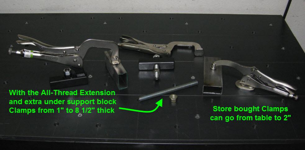

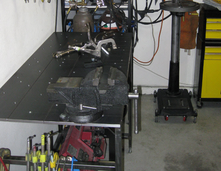

Drilled holes throughout the table top steel planks to allow the vise to be placed anywhere on the table along with custom made Vise-Grip type bolt-on clamps.
Attachment 1137

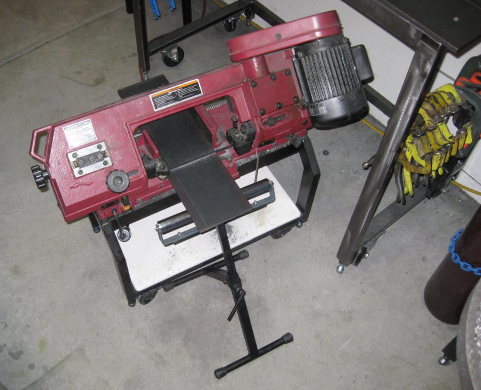

To conserve space, the metal band saw fits under the welding table on a stand with wheels that turn 360 degrees. This allows me to quickly pull the band saw out and use it when needed, then quickly store it out of the way when not in use.
Attachment 1138
If needed the Welding Table & Band Saw Stand can be locked in place using leveling bolts. ( Also added Wheels & Leveling Bolts to the Drill Press Stand )
Attachment 1139
I tried to keep the design for the table & stands as simple as possible so the items could be easily made by anyone who has the ability to cut and weld metal.
Attachment 1140

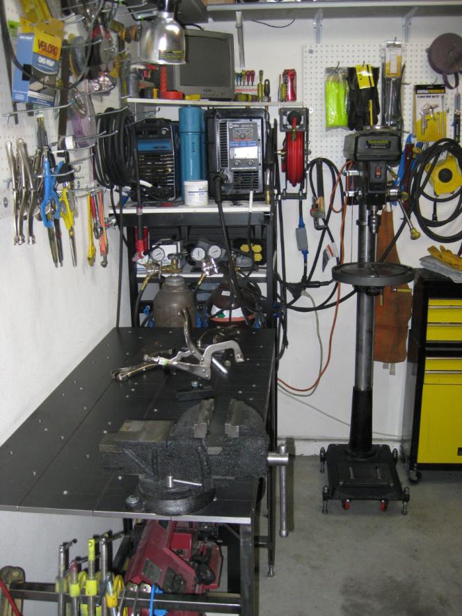

By using smaller ‘inverter’ type welding technology, I was able to fit two welding machines on top of the stand that fits over my air compressor; thus, allowing me the flexibility to TIG, MIG, and STICK weld - in my small workshop area - projects made of Mild Steel, Aluminum, and Stainless Steel.
Attachment 1141
