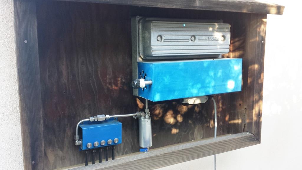

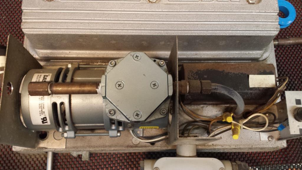

Attachment 15425
The ozone generation system uses a u-shaped high intensity UV lamp (housed in the aluminum housing with three bolts) and a small Gast compressor (housed in the blue powered coated enclosure ) to activate the compressed air with ozone.

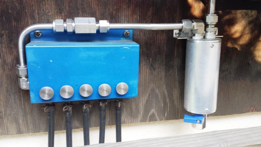

Attachment 15426
On the right is the water trap and on the left a manifold with five stainless steel needle valves. I replaced the plastic needle valve knobs by making knurled stainless 303 knobs press fit onto the needle valve stems. The check valve above the manifold ensures the compress ozone can build-up pressure in the pool and spa injection pipes, and the piping is connected to bubble diffusers at the bottom of the pool ans spa water for generating very fine bubbles into the water columns of the pool and spa.

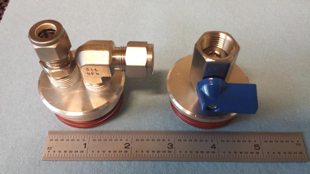

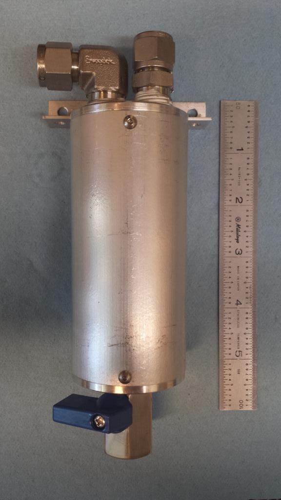

Attachment 15427
Assembled trap for the compressed ozone and air mixture. The 316 stainless steel fittings are from Swagelok.

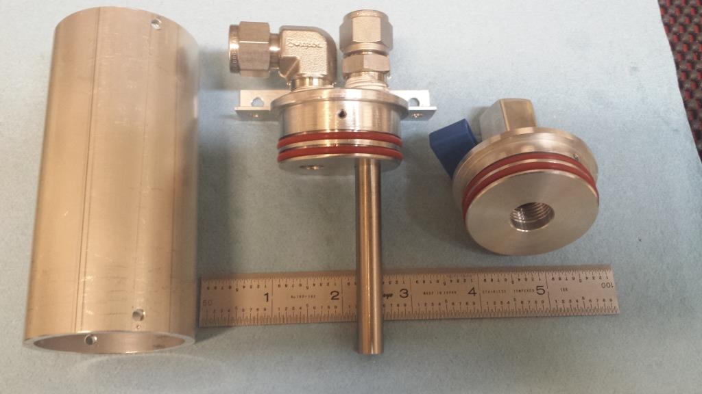

Attachment 15428
Parts of the water trap are machined from 6061-T5 aluminum and 3/8" 316 stainless steel tubing. The end caps use silicone o-rings and held in place with 4-40 stainless steel button head screws. With 20-20 hindsight, I should have placed the button head screws on the right and left sides of the trap so I could remove the trap without having to disconnect the compressed tubing fittings to access the button head screws at the rear.
Attachment 15429
Detailed view of the end caps with 3/8-18 NPT to 3/8" compressed tubing 316 stainless fittings.

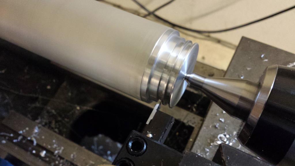

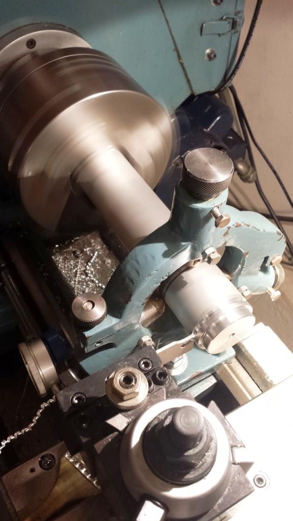

Attachment 15430
Parting off the end cap after machining the o-ring grooves with a Nikcole insert grooving tool.

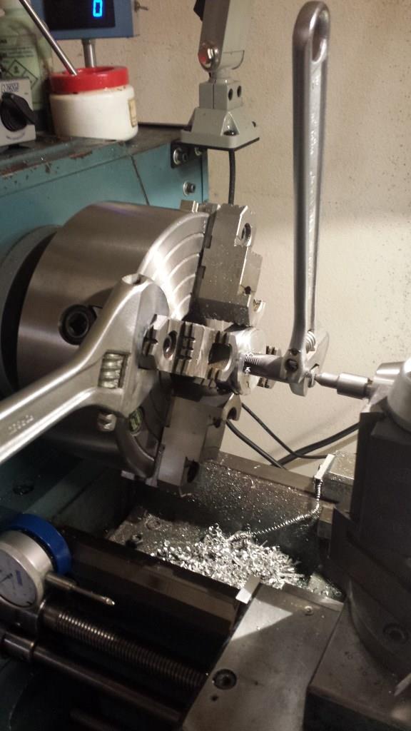

Attachment 15431
Hand tapping the 3/8-18 NPT threads in the lathe chuck with the end cap held in an aluminum ring to prevent damage to the o-ring grooves. If I did this again, I would have pre-machined the taper in the pipe thread hole using the lathe compound to make taping easier and machined the end in the other direction.

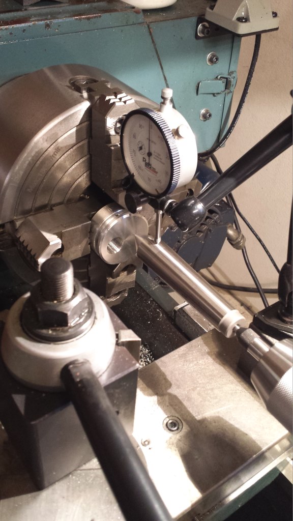

Attachment 15433
Setting up the hole offset for drilling and boring the second 3/8-18 NPT thread hole.

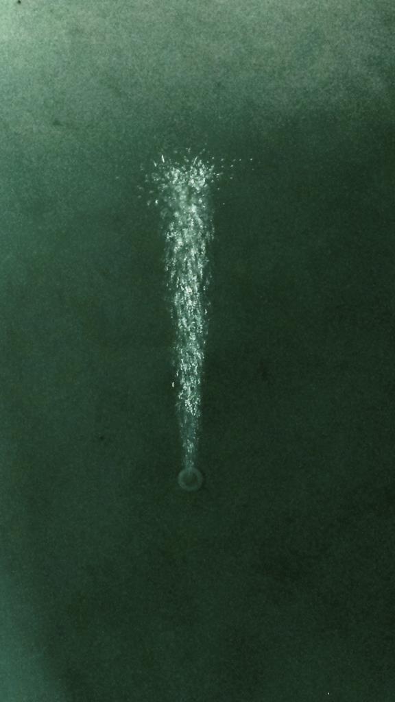

Attachment 15512
Nighttime view of one of the ozone diffusers bubbling the ozone into the water column. The ozone is very active and bounds with organic impurities before reaching the water surface. The pool bottom is pure white plaster and very clean but in the night photo appears with a gray-green tone.
